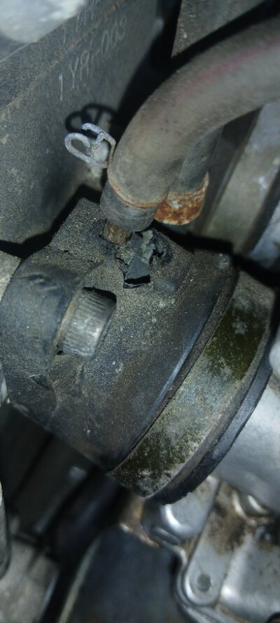

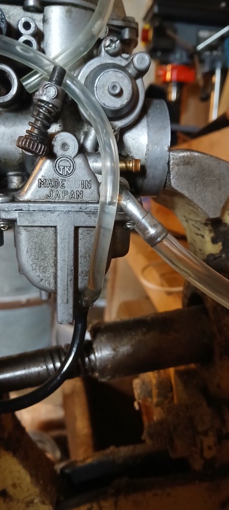

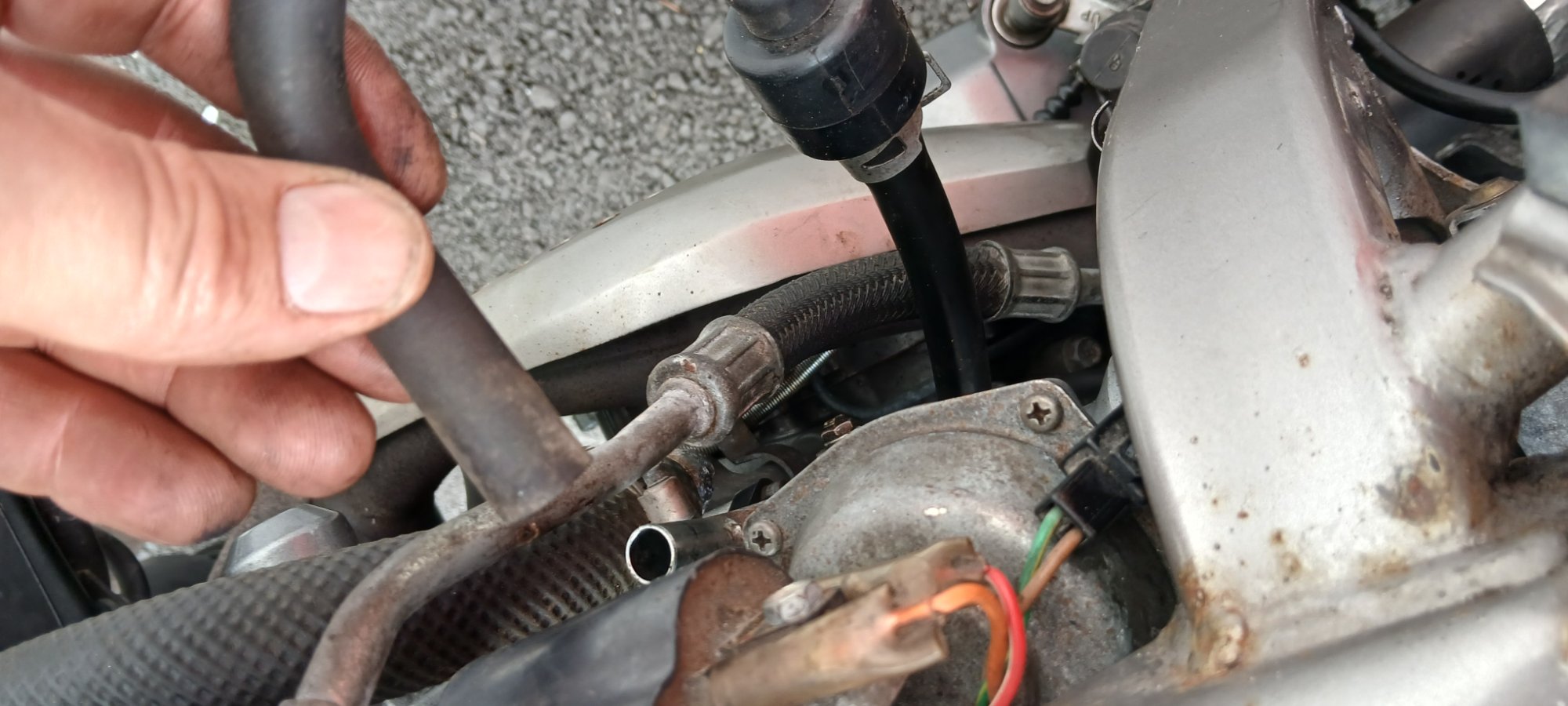

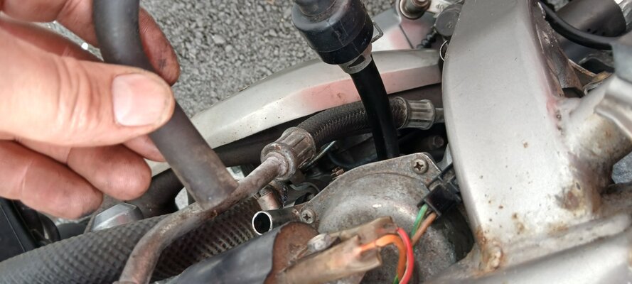

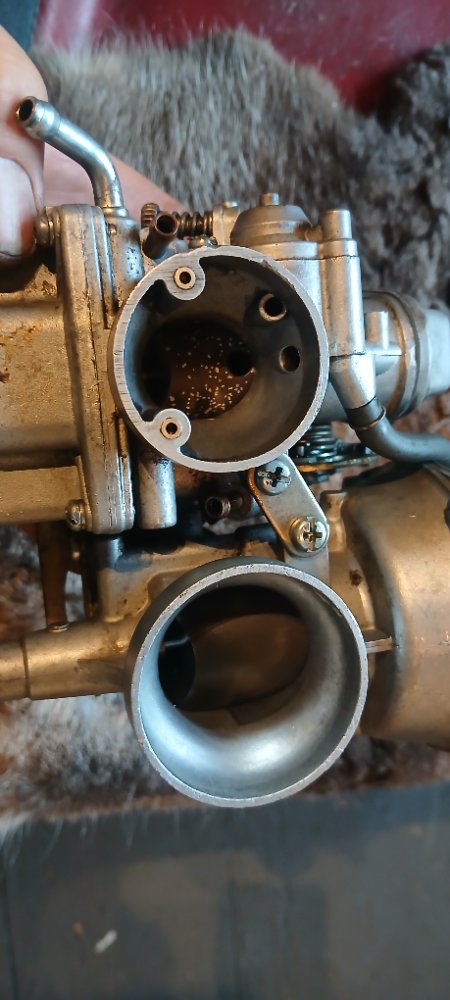

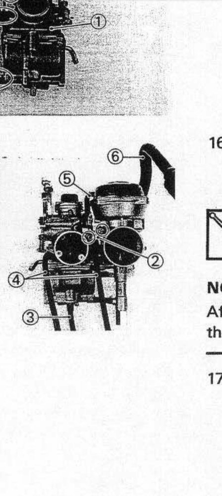

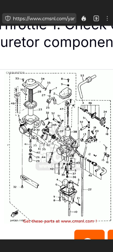

Well after reading of another riders problem trying to get the revs above 3000 ,I pulled the air hose off the secondary carb (6). Now it revs out and is quite snappy on the throttle.
The hose was disconnected in the middle when I took the fairings off. I can't see if the hose is ment to join the carb or not?
Is this system a kind of EGR valve 1990s style?
