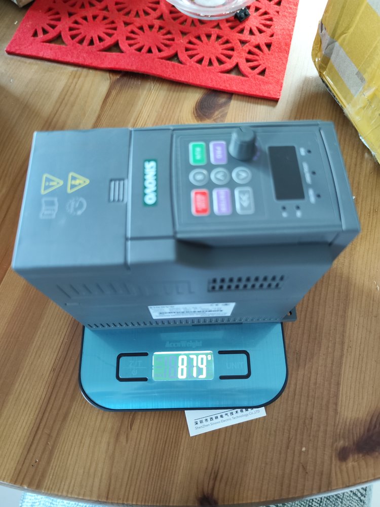

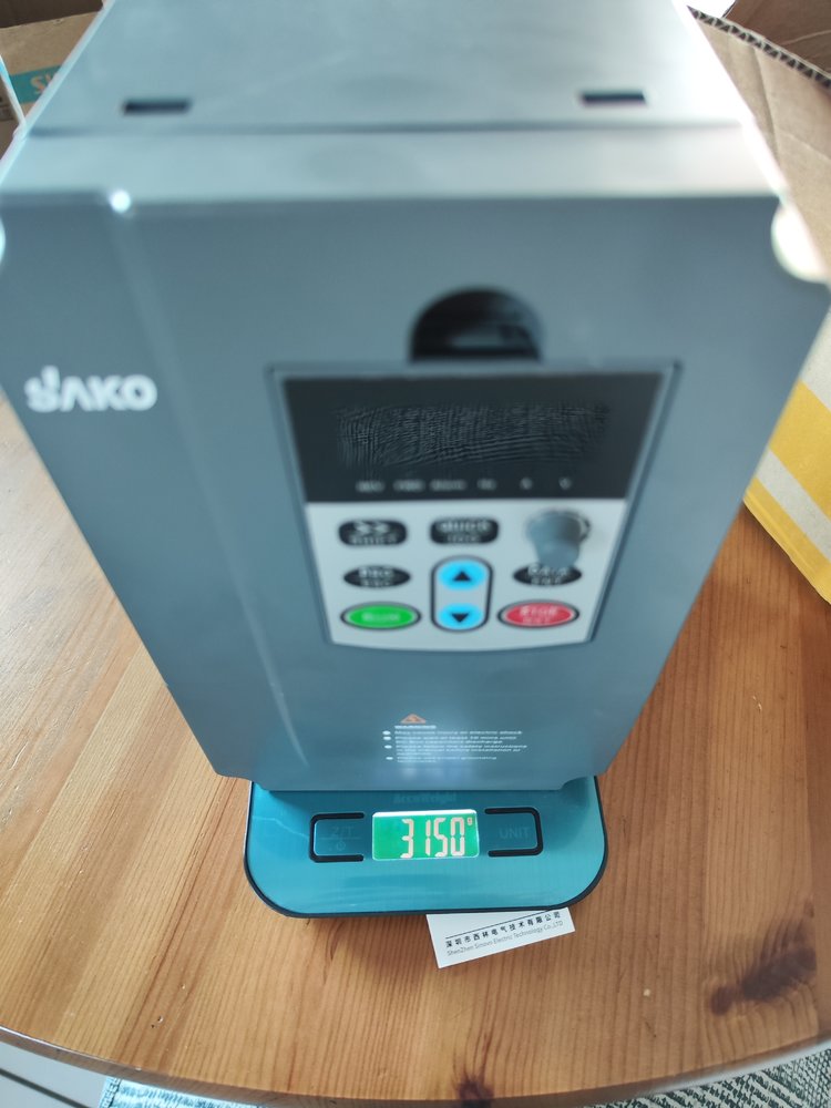

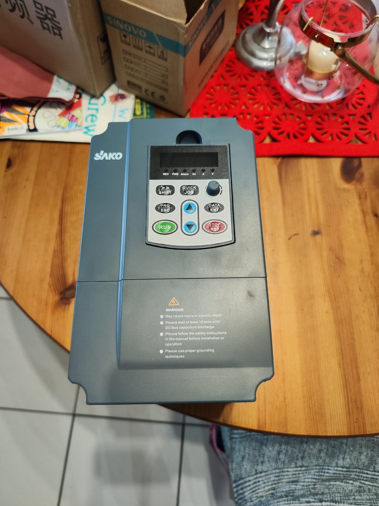

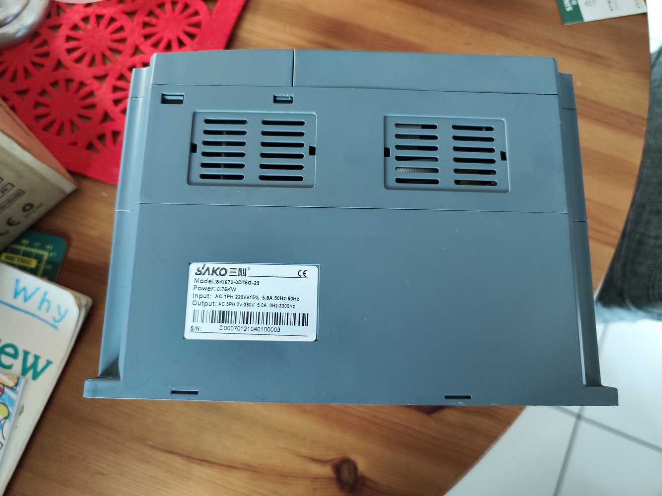

I wonder how the electronics compare to the single to three phase 240v boxes.The 0.75kW single 220v to 380v arrived.
I was quite shocked to see the size and weight of it.
It appears that there are some decent components in the drive as the VFD is much bigger and heavier than some of the other cheap Chinese VFDs you can buy.

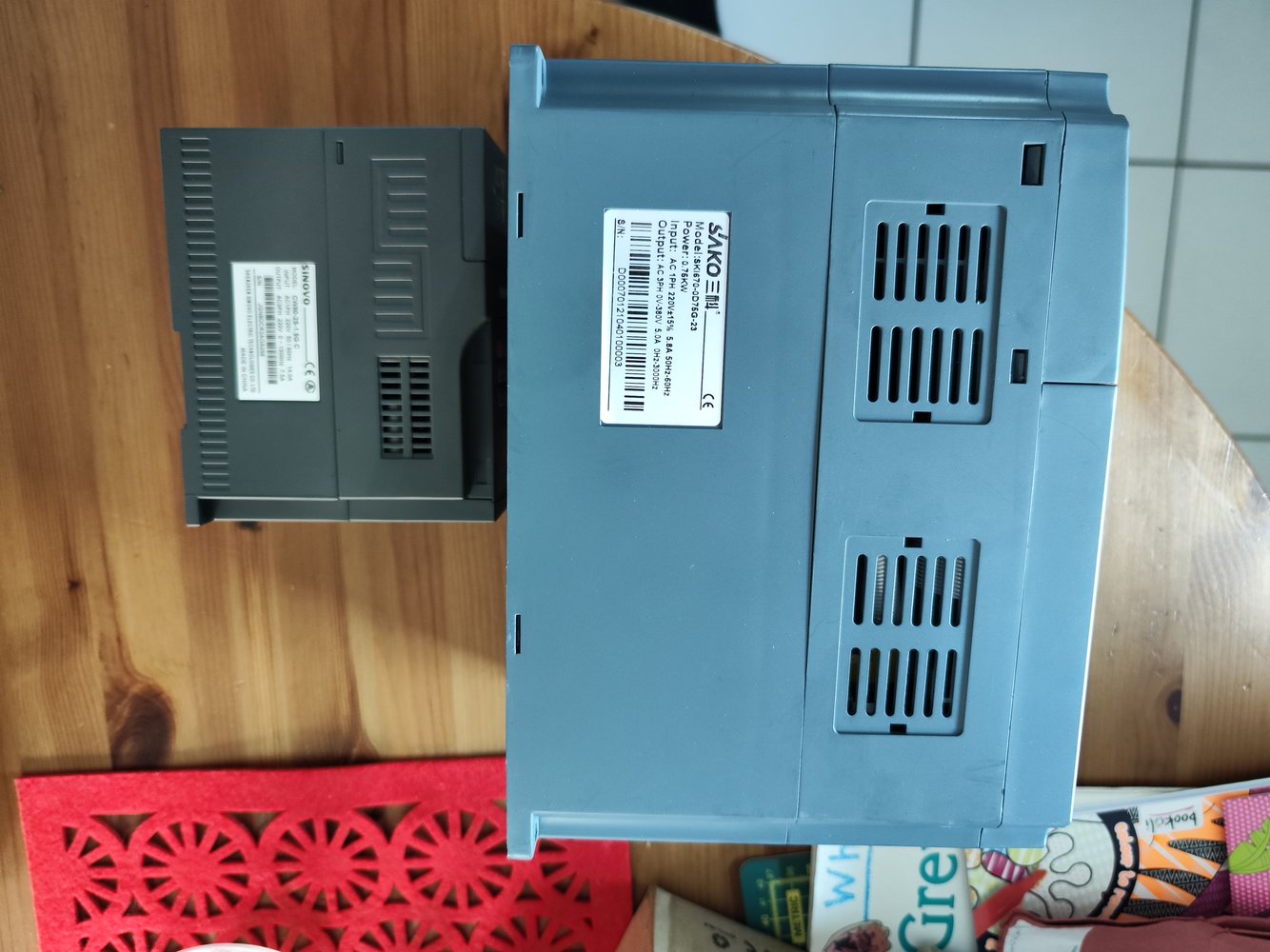

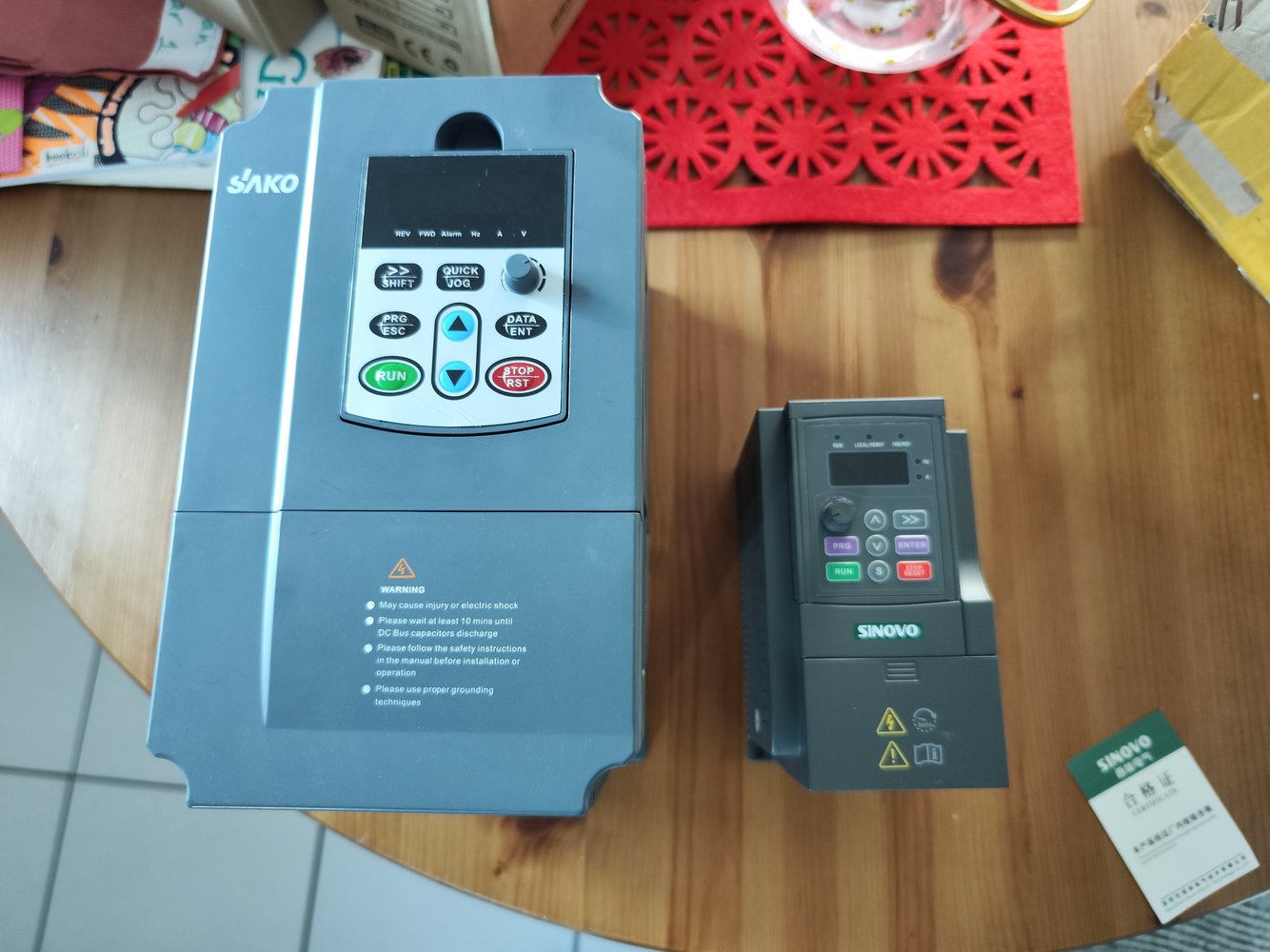

To give you an idea of the size, here it is next to another 1.5kw 220v single to 220v three-phase VFd.

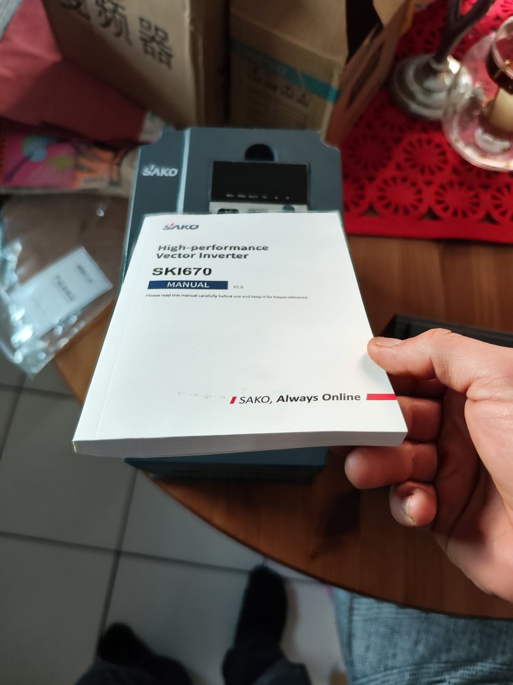

The manual is decently sized (177 pages) and provides adequate information.

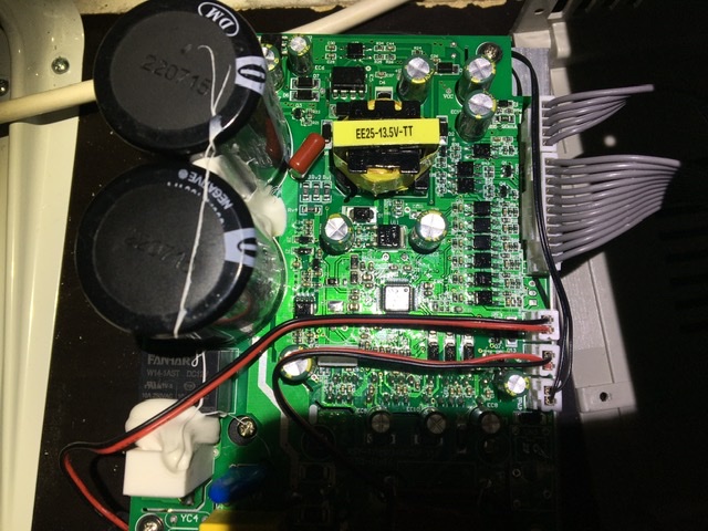

I would like to learn a little bit more about the workings of VFDs too.I wonder how the electronics compare to the single to three phase 240v boxes.
I wonder if the 0.75kW VFD I bought have got the wrong sticker on it and that it might be a larger capacity drive.
Even to the untrained eye - 4 big capacitors instead of 2 !

1 . Why do some VFDs only have 2 large capacitors and others 4?
