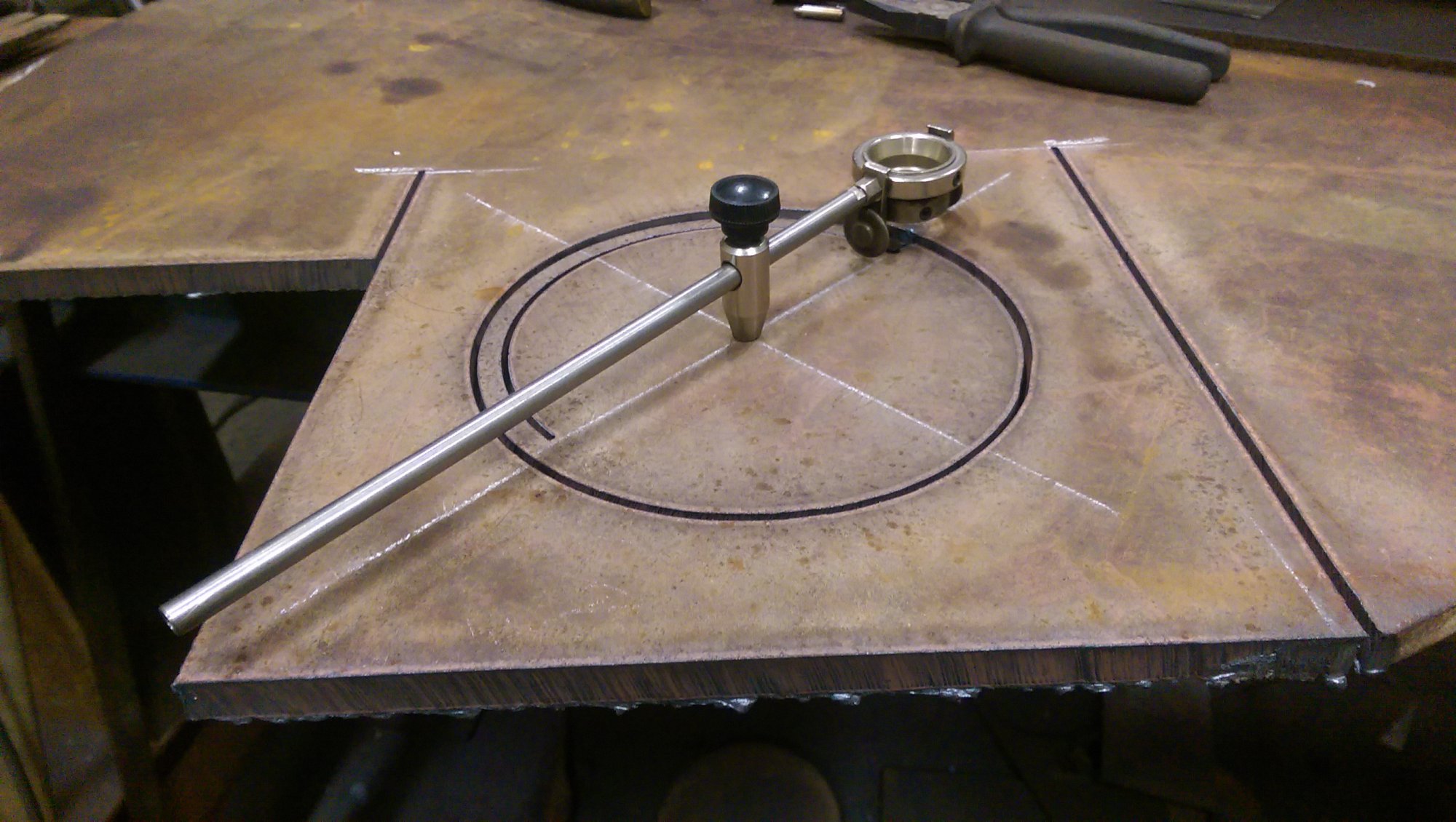

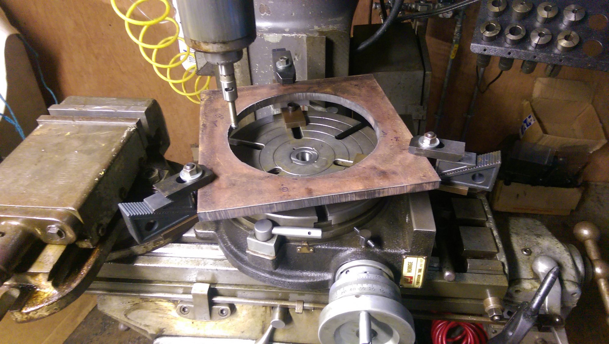

as for dressing up a plasma cut, i don't need to much tbh and if it dose need a lick i use the linisher but 97% of the dross will chip off with a chisel.
as for being spot on, self praise is no praise in my book but on this one ill say id be fairly tidy with the plasma, i don't do many free hand cuts unless i was nipping off something in my way but other than that i use a straight edge and 60 amps of plasma which leaves a nice clean tidy cut but judge for yourself on the outside cut on 15mm plate in the pics below, them pics were taken back in January for a different reason so just random pics i could find of a cut.
