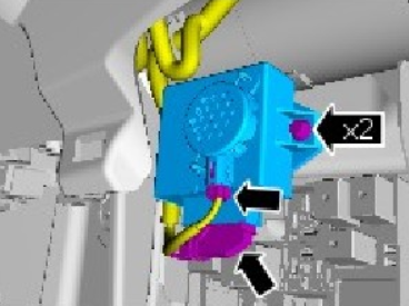

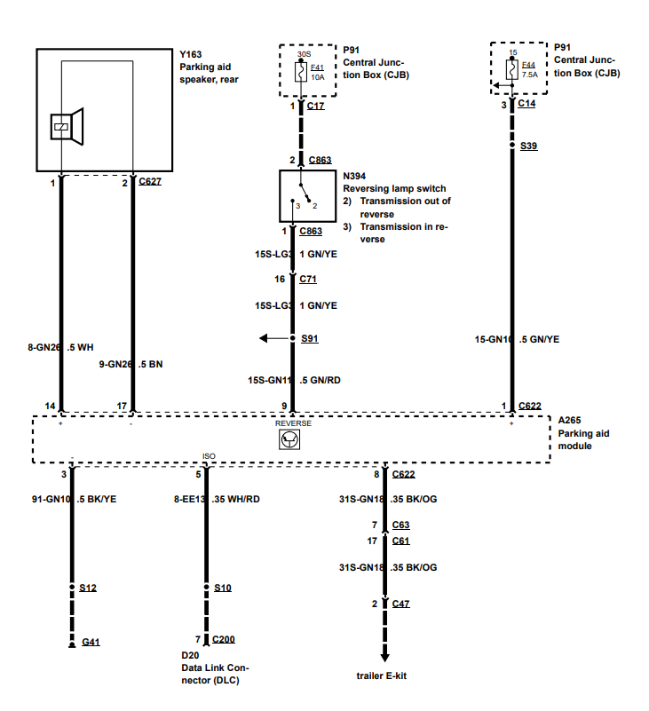

OK, my van has now got a tow bar on it. The reversing sensors don't pick it up. But as sure as hell they will do when the trailer is attached. There is no way to turn the sensors off on the dash, So my thinking is to run a switch and cut one of the wires to the sensors so I can reverse without deafening myself. Can anyone foresee any problems I might come across? It's an 09 plate transit connect.
