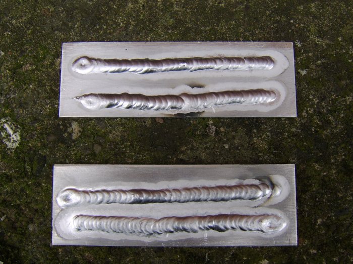

Good stuff Zardoz, carbon pipe to plate can be a devil for undercut on pipe, you seem to have kept this to a minimum.

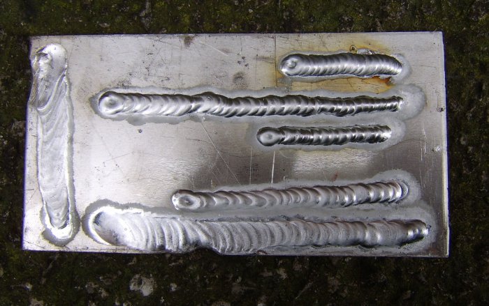

Stainless: can have same result. Weld a tad on large side, pick up your speed of travel (SOT) for a smaller weld profile, nice continuous filler wire dips will see you achieve neat dime configuration.
Cheers......
