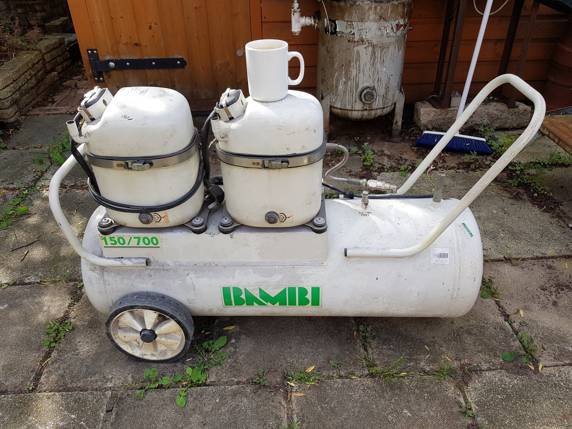

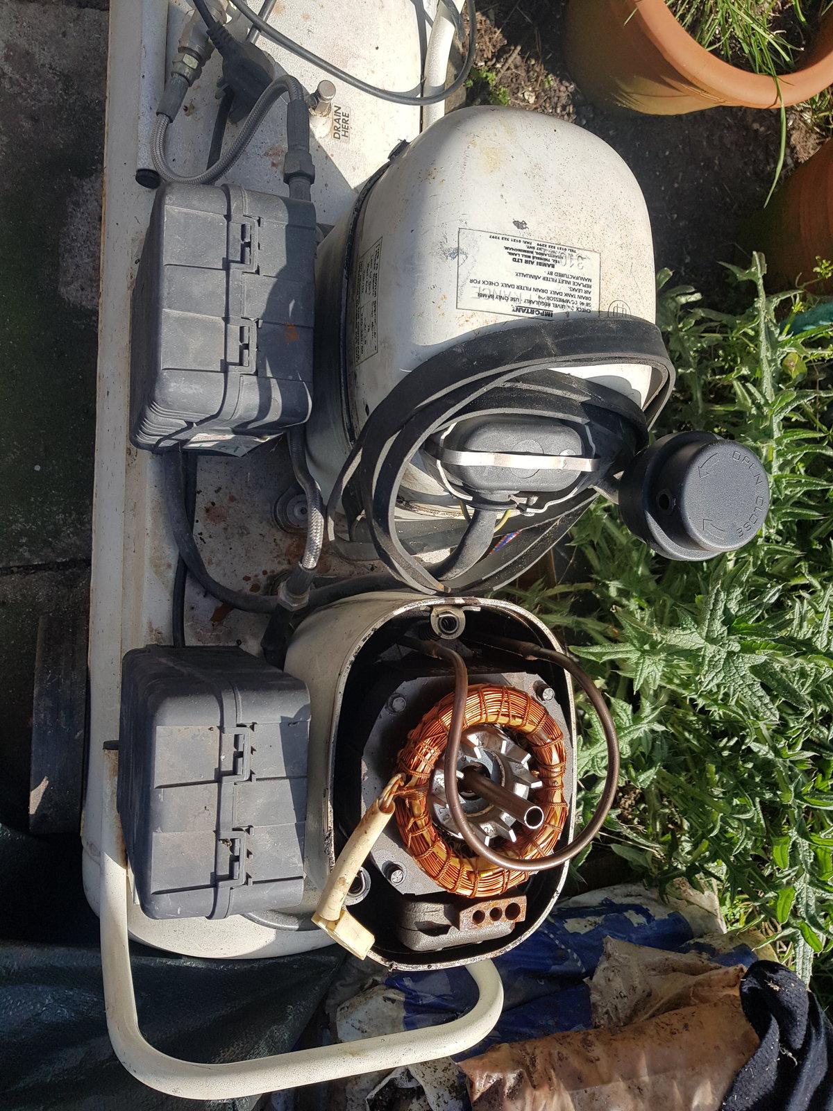

Having had no compressor up until about 18 months ago (other than a direct drive jobby that a friend lent to me that nearly gave me a heart attack every time it fired up) I gained, in the space of a few months, two Bambis and a big old Ingersoll-Rand. Of the three only one was in working order, the smaller of the two Bambis, which I bought from Johnnybravo. The IR you know all about from the rebuild thread. The second Bambi, however, has sat under a tarpaulin since getting it, chucking a few quid at it, and finding that, surprise surprise, it didn't work. Well, when you buy £400-500 pounds worth of compressor for £50 on FB, it's not really that much of a surprise, is it? I thought that it was worth the price for the receiver, so there
Today being sunny and warmish, and me being in a bit of a lull with my other restoration, I thought I'd have another look Bambi II.

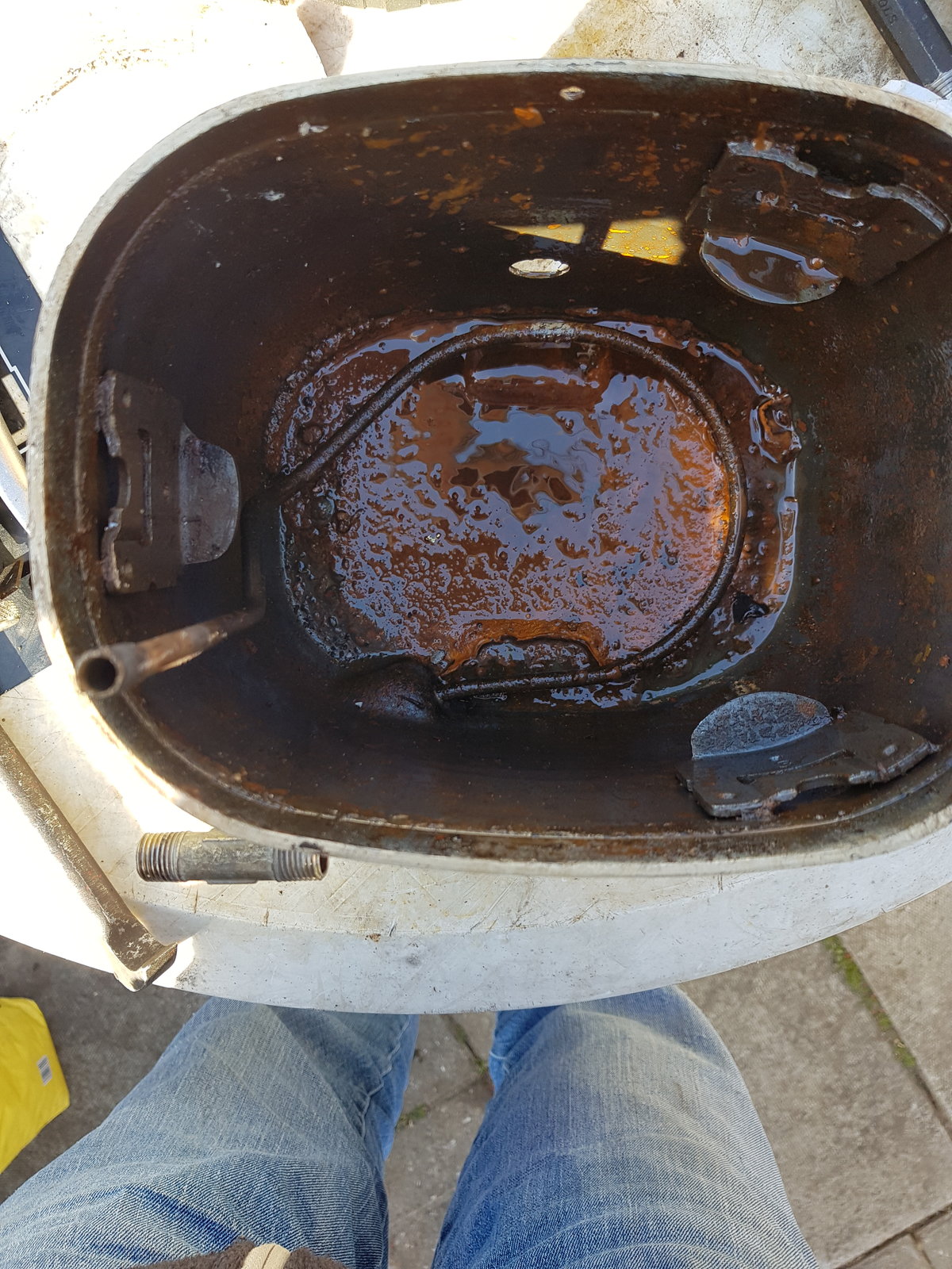

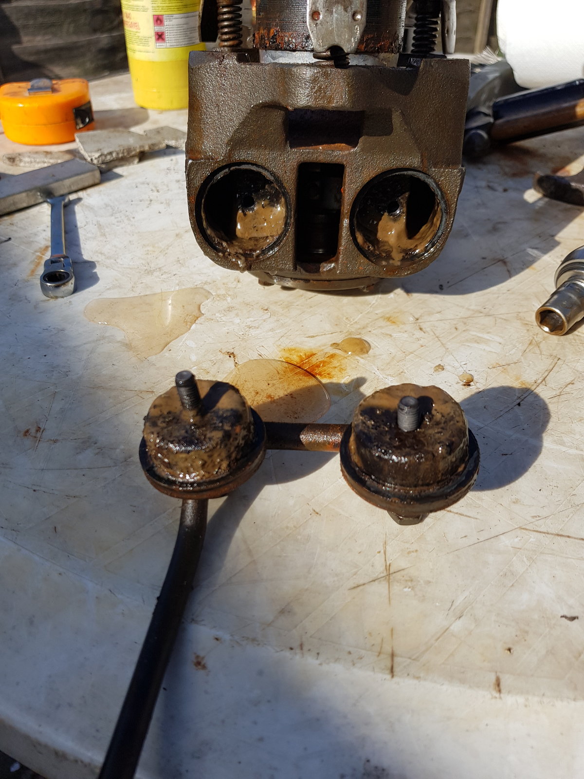

I'd previously removed the tops of the cans when I found that there was no life in the beast and, other than draining about a gallon of water out of the receiver and a good couple of pints out of the two heads
, that's how it was left.
Sorry about the orientation, Picasa just will not save the rotation.

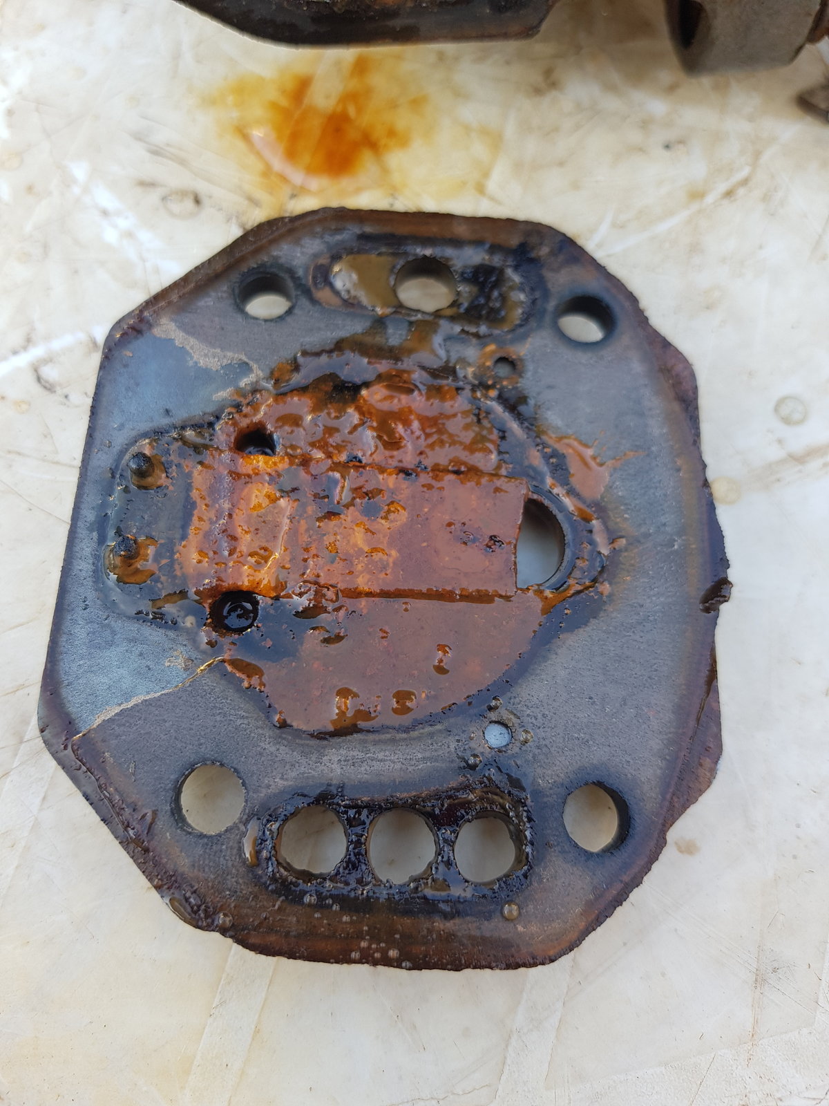

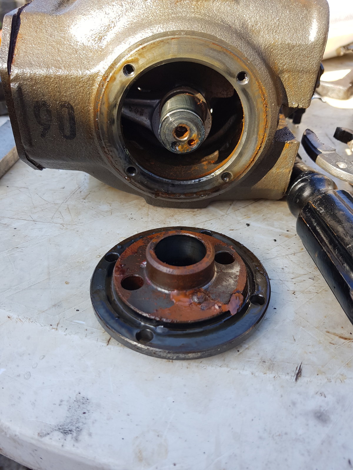

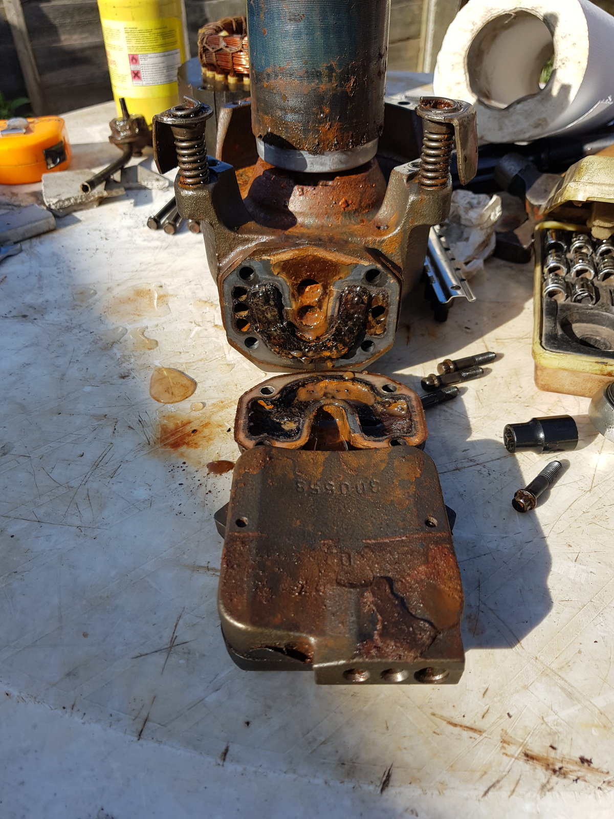

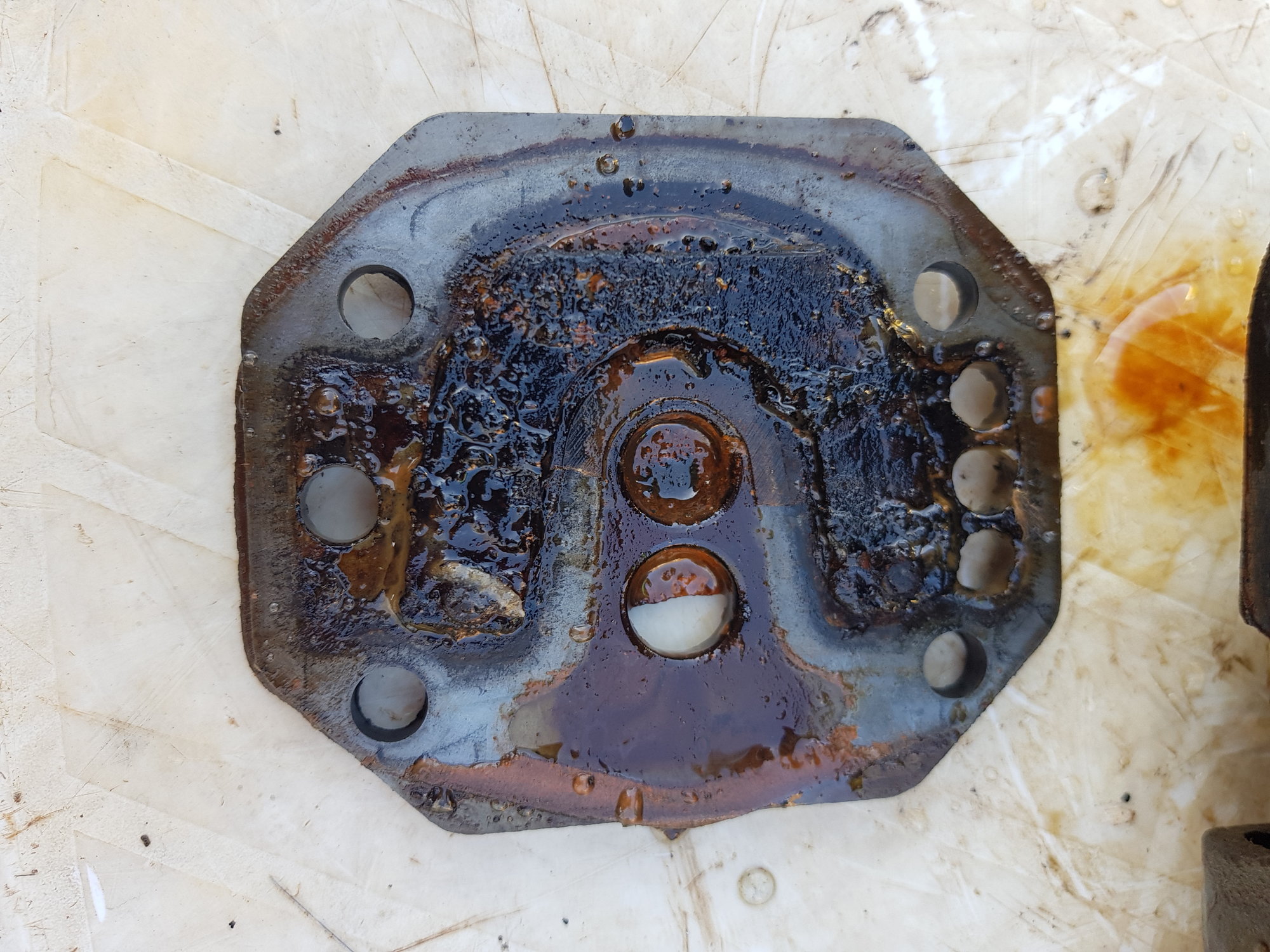

The pump head was removed and I set to work. I managed to drain some more foul liquid .

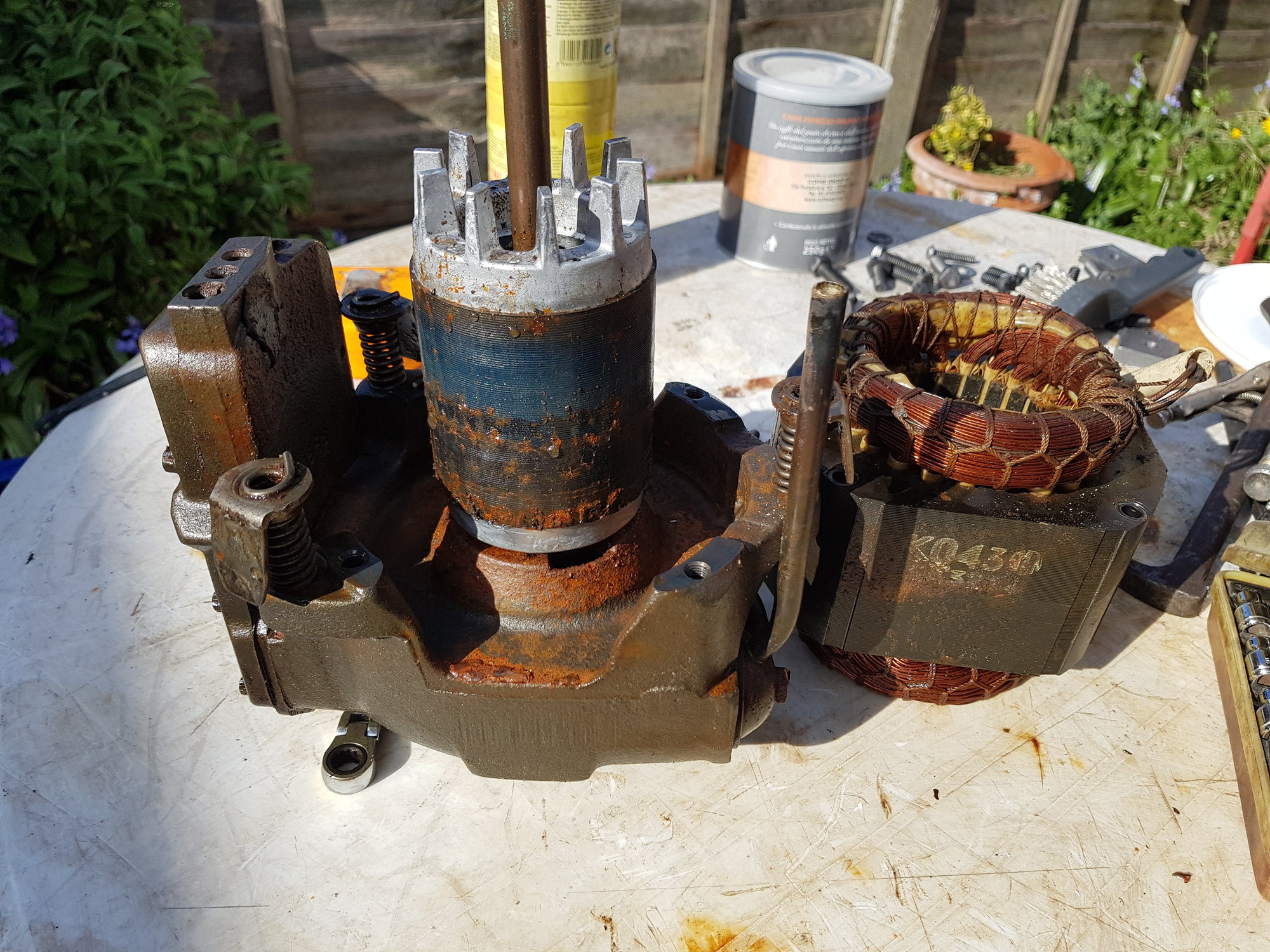

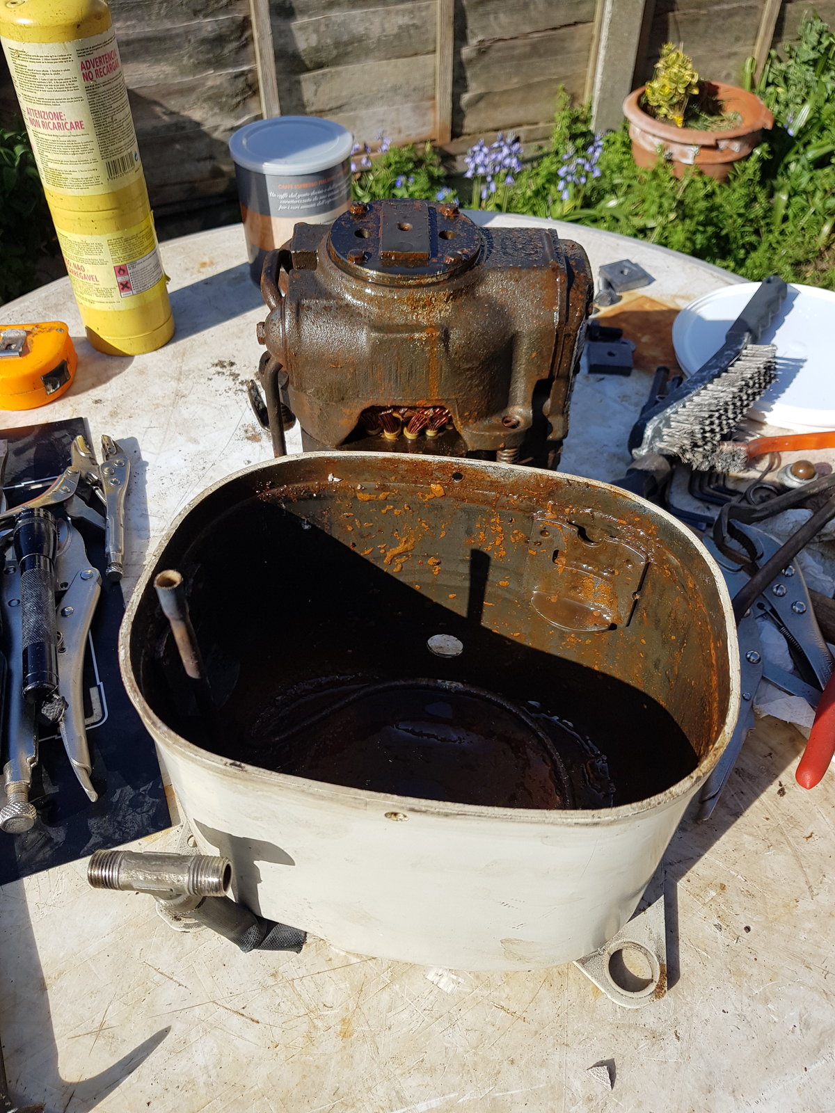

It took me well over an hour to work out how the disassemble the beast. Partly due to poor lighting, i.e.very bright sunlight and poor eyesight. I eventually realised that the spring mounts hooked into three brackets that were spot welded to the can, and were not all one piece that was welded on.
It took a while to find bits of bent metal to lever the beggars out, but it did eventually happen.

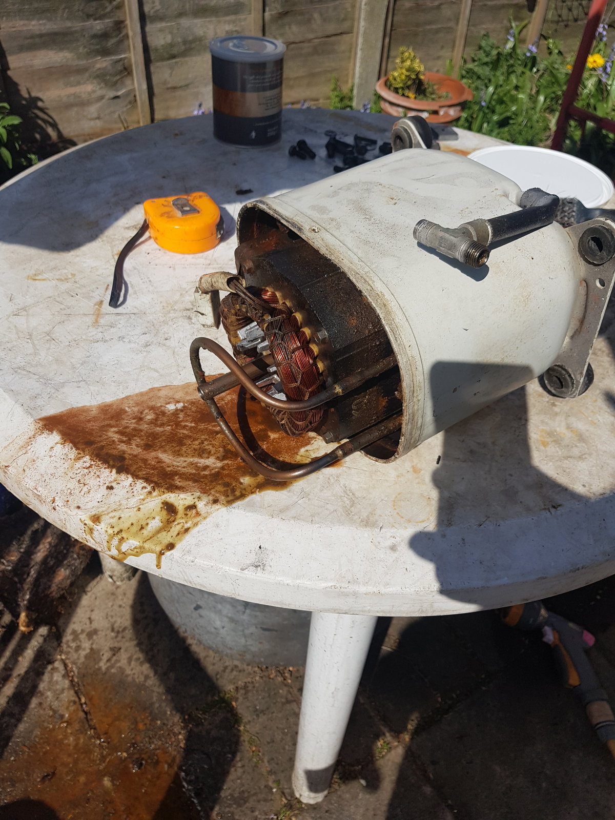

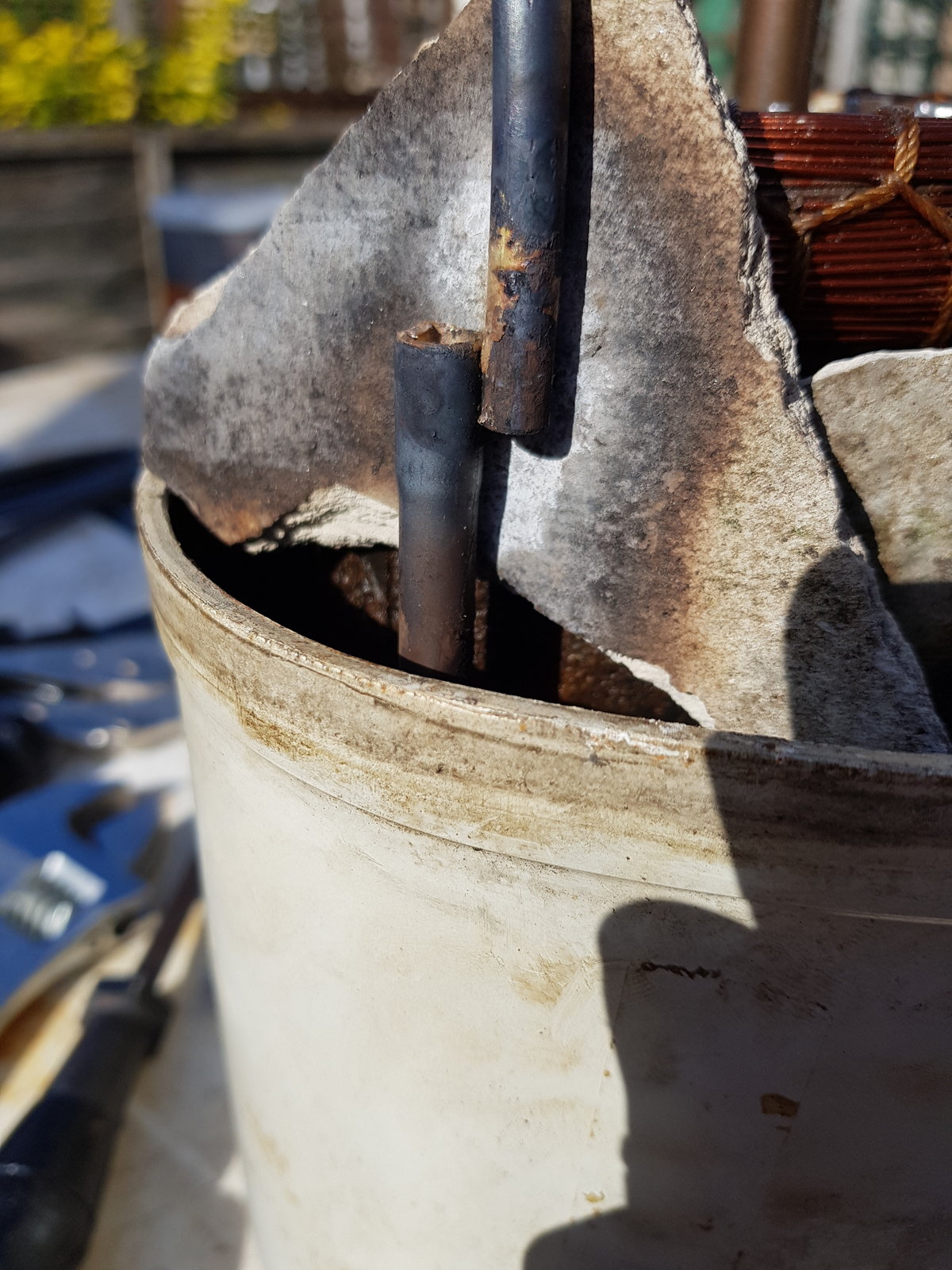

But, it still didn't want to lift out, being attached by a piece of pipe. I'd always wondered about the large loop of pipe over the top of the motor and, after another seemingly endless age, I worked out the the pipe run looped around the inside of the bottom of the can, came up the side and then looped over the top purely to allow movement of the pump and motor, which of course are spring mounted. It finally dawned on me that I'd have to unsolder the pipe loop, which fortunately was soft soldered, and came apart without too much of a struggle.
Out came the pump assembly
The offending curly pipe.
