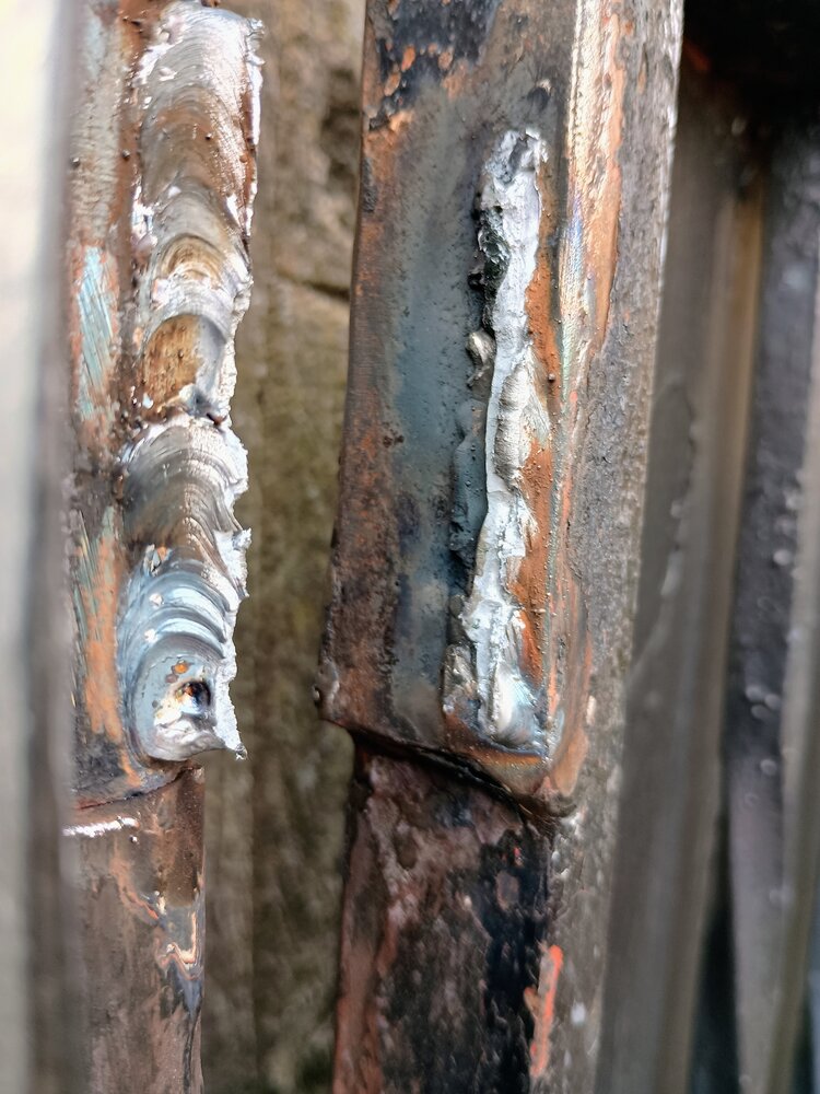

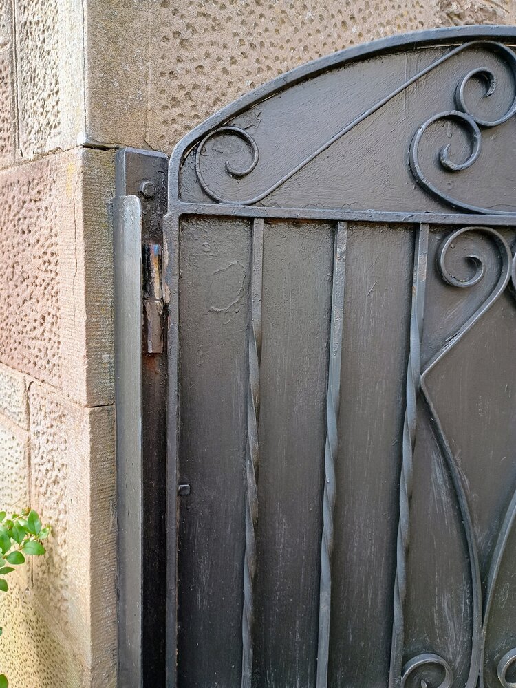

Top hinge on her side gate snapped off. She said it had been getting progressively more difficult to open and eventually broke.
I ground it down, preheated and then welded it up. Should have taken a pic at that point.
I then tried to close the gate to weld up the other side but could feel the hinge wasn't moving. The weld snapped.

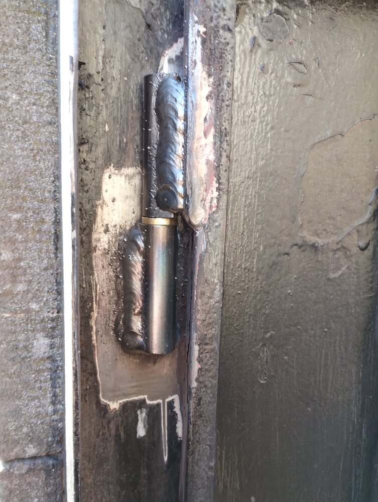

Tried to hammer the top of the hinge off but it wouldn't budge. Will buy a new hinge, cut off the old one and weld on the new one.
