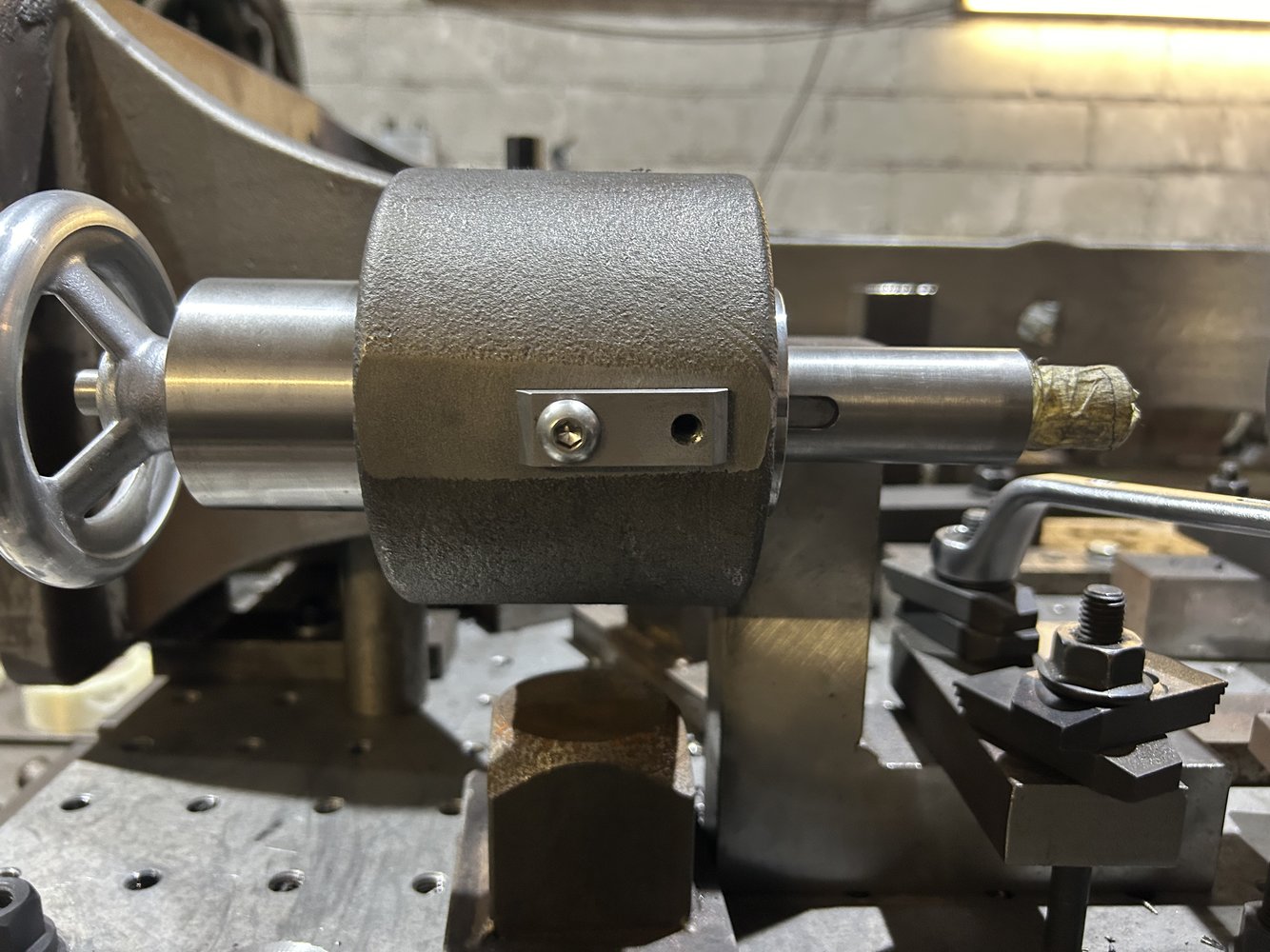

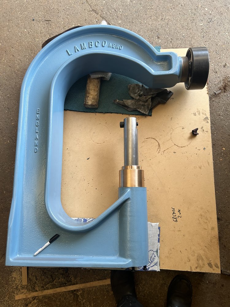

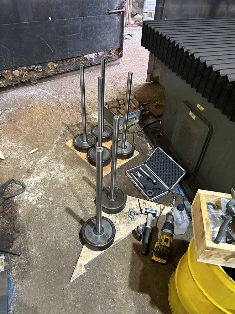

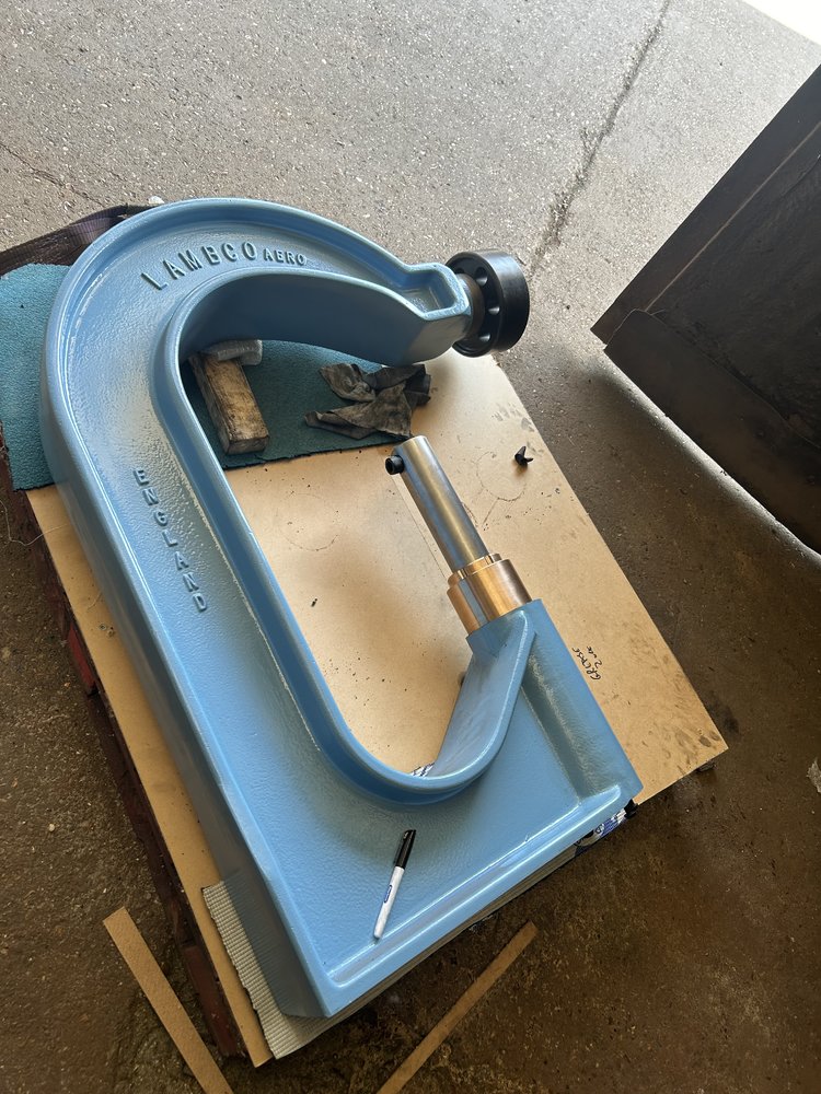

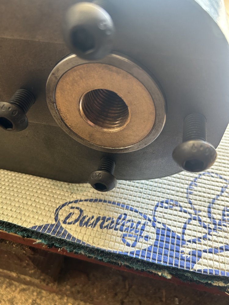

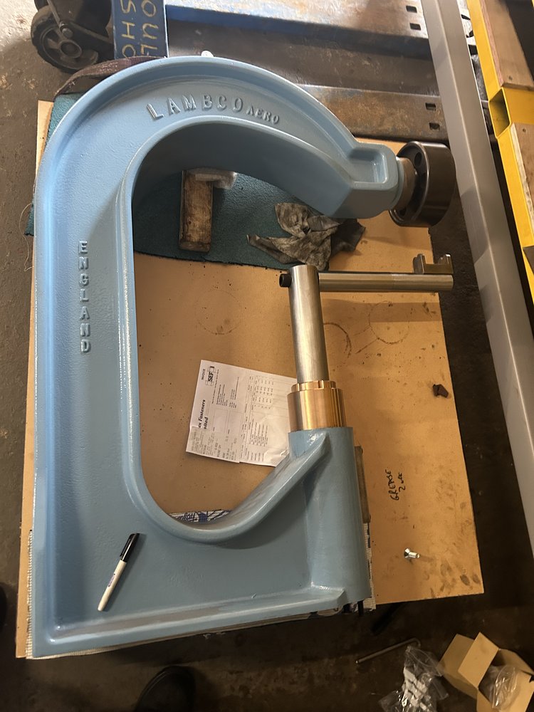

Aero cowling wheel progress

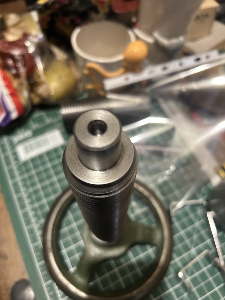

The main shaft was ground wrong by the hideously expensive contractor..
Managed to tickle off .0002 and it slides like a hydraulic valve . Lucky Devlieg can achieve grinding tolerances so bore was dead true
Glad someone asked...I was wondering about that too!What's the story with the shaft being offset from the top wheel, how does that all work?

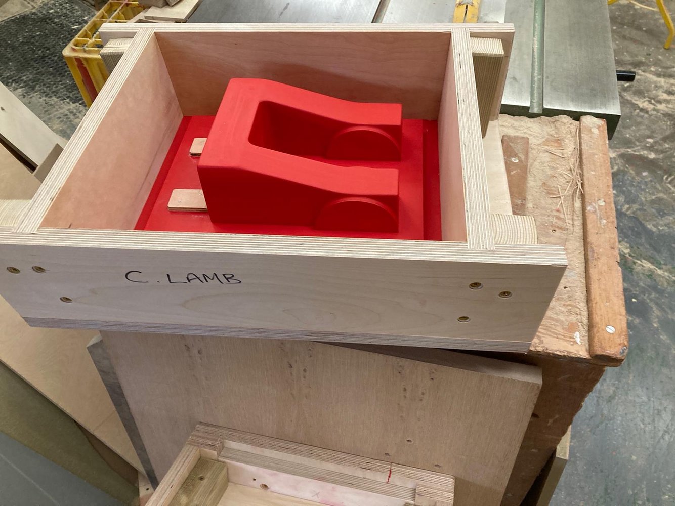

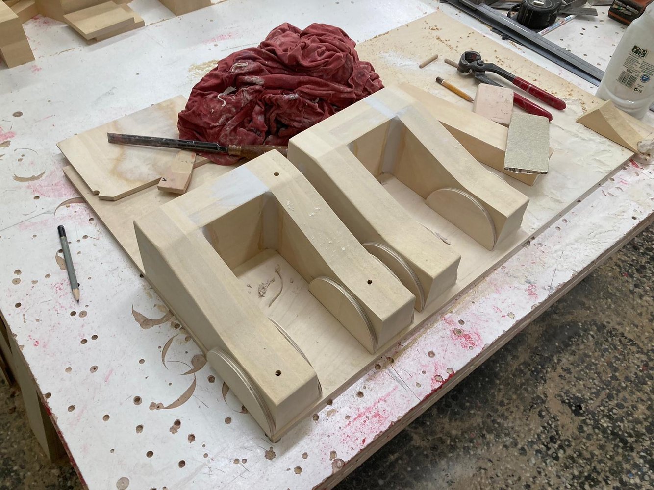

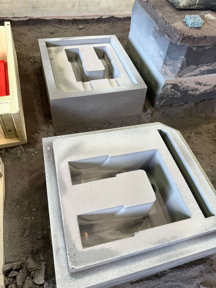

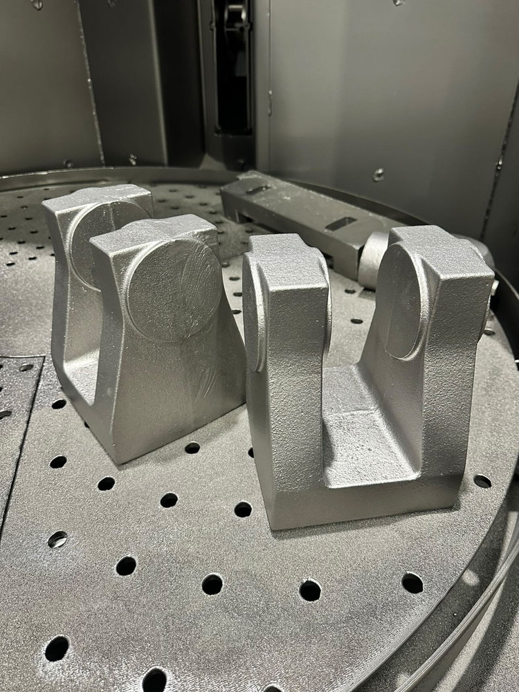

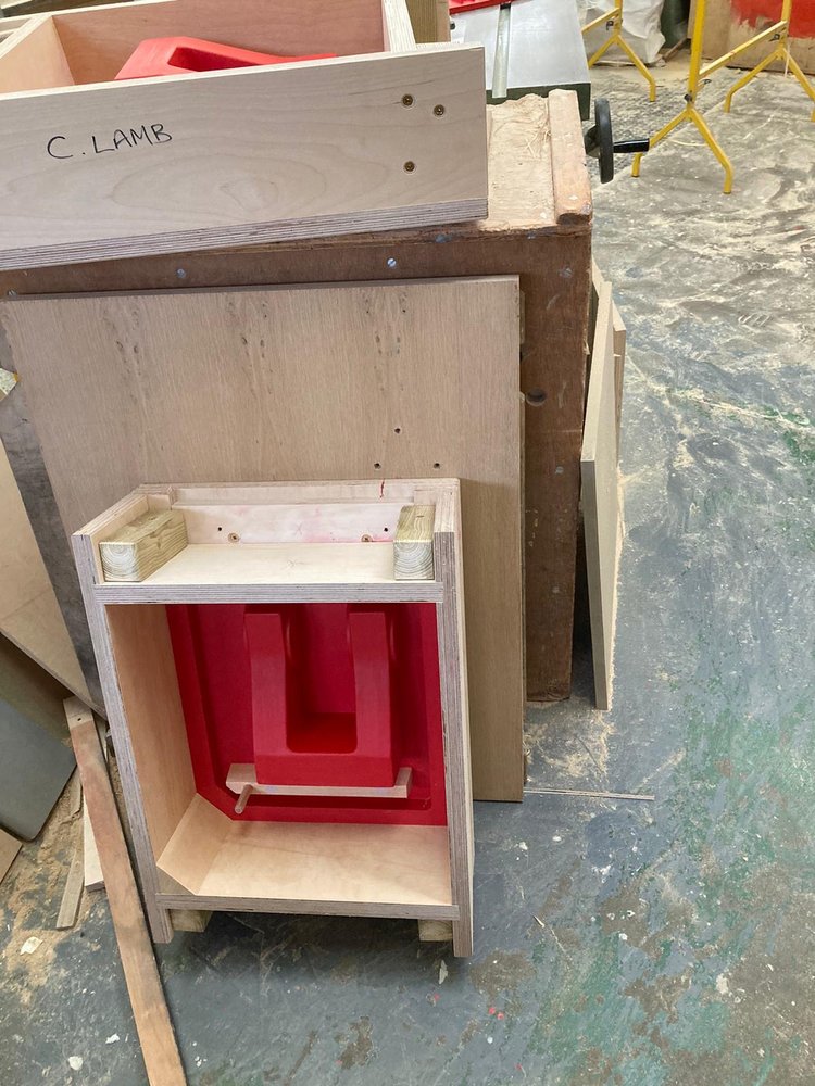

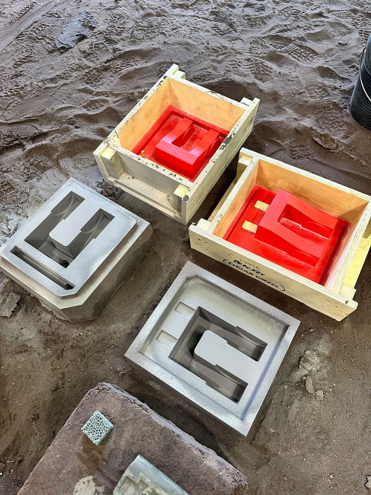

I make the patterns , or 99% of the patternsDo you make the molds?
