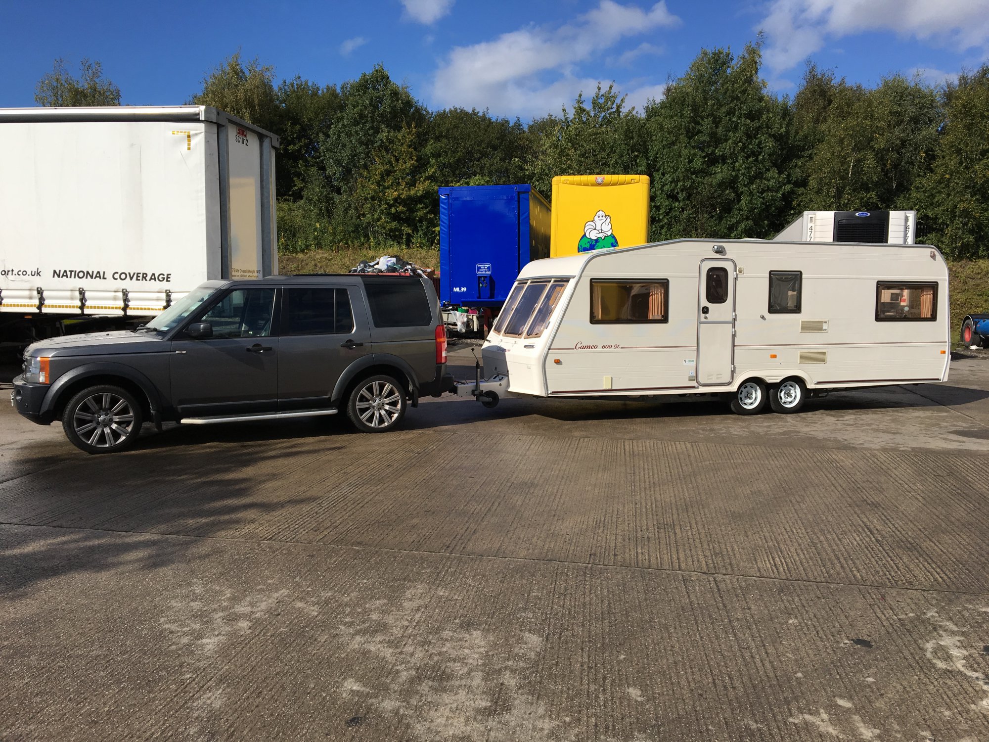

just remember with the disco the caravan has to be slightly nose down when coupled up you may have to fit a drop plate you do not want to tow with van nose up, also when packing van all heavy stuff on the floor over the axles after 40 years on the road most of it on HGV wagons i have seen too many caravan crashes with the tail wagging the dog and that van is big enough to wag a disco with no bother
Thanks for the advice, I've plent of towing experience but never with a Caravan.
Here how she looks hooked up, would you say I would need to fit a lowering plate for the ball? It's a removable tow bar so is it possibly to do so on this car?
