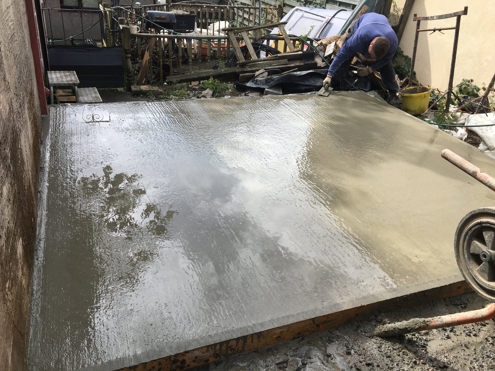

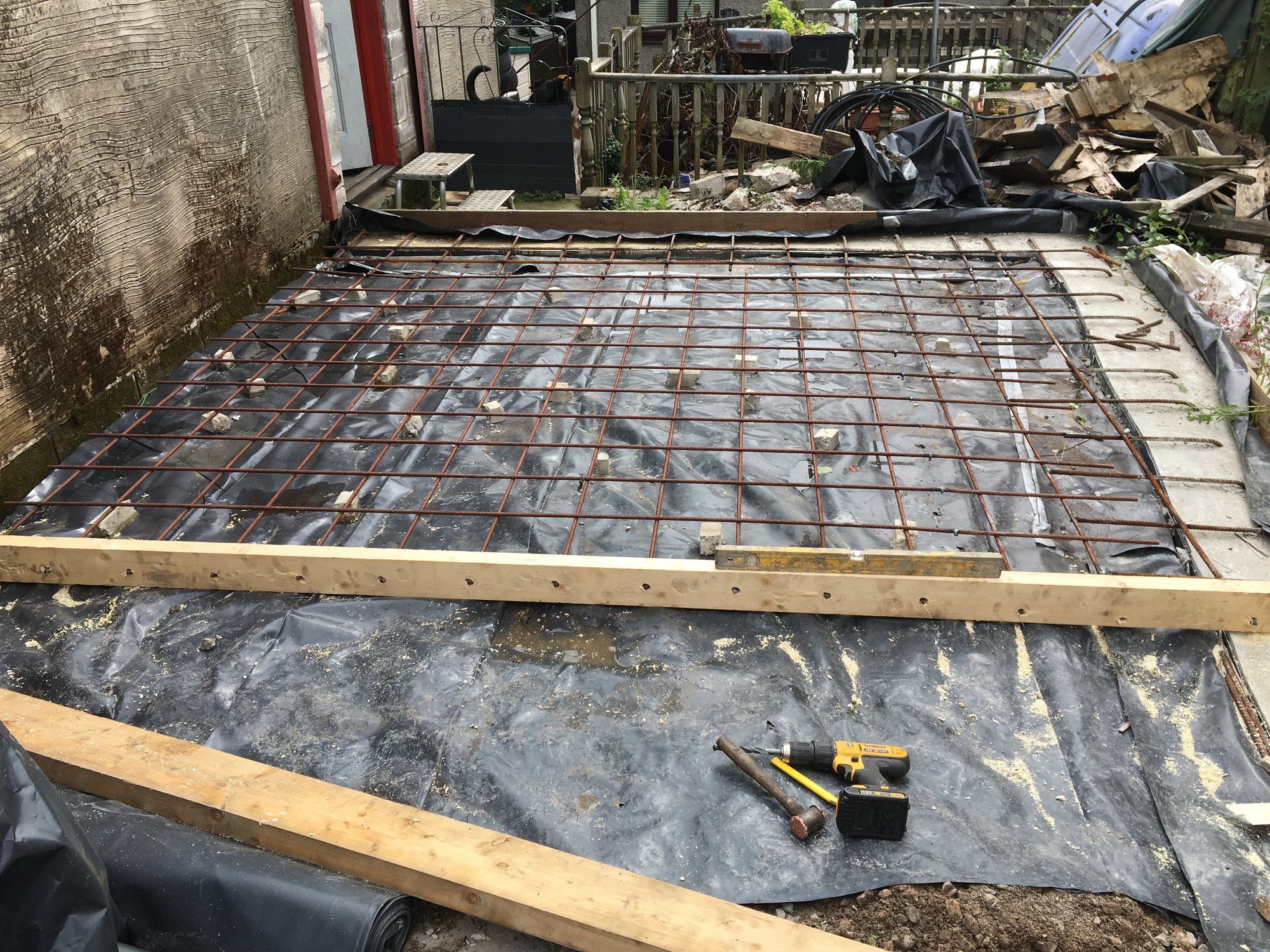

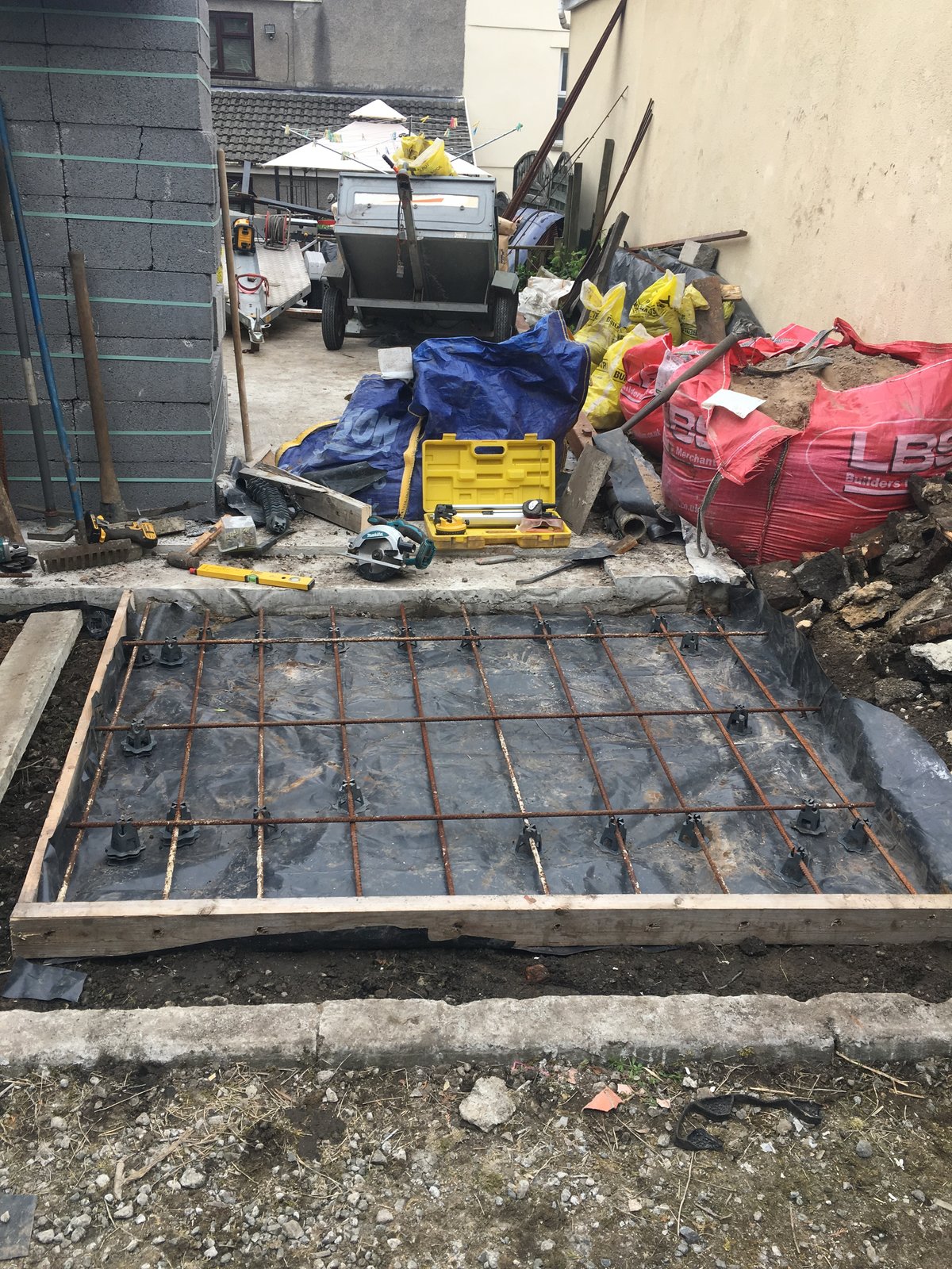

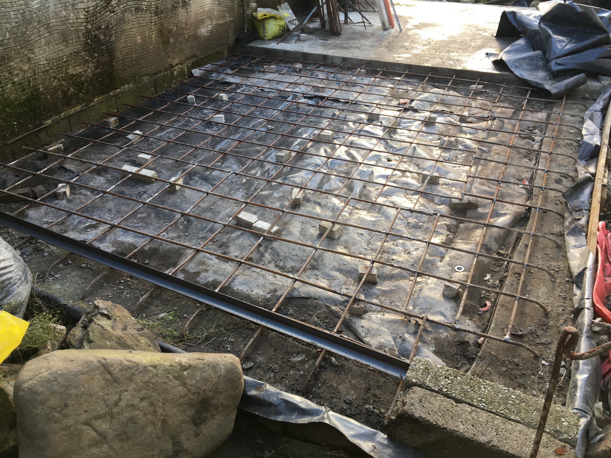

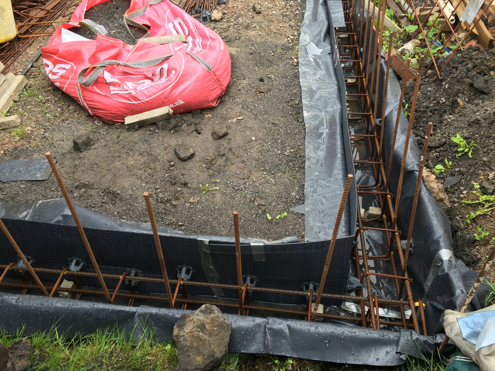

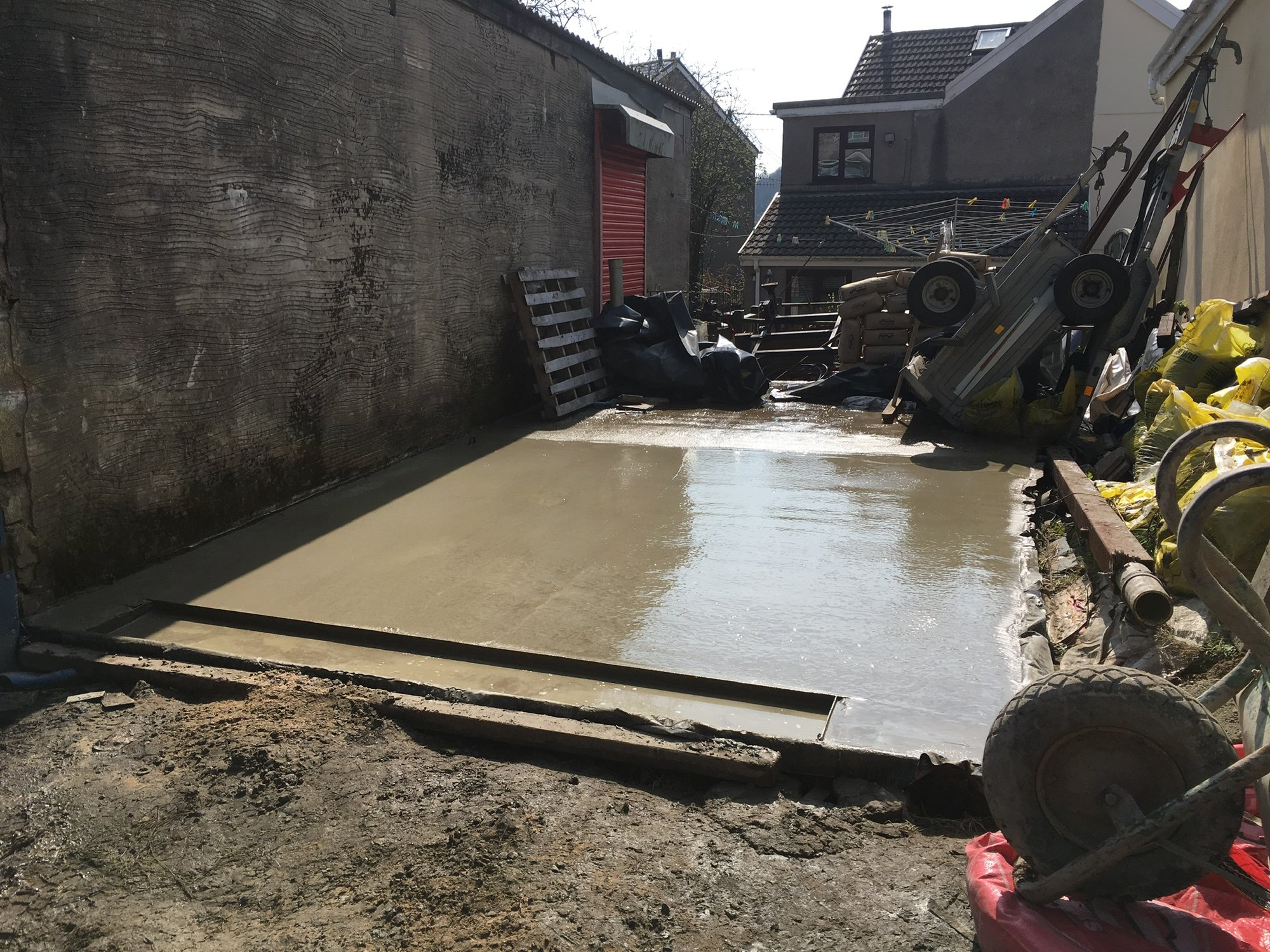

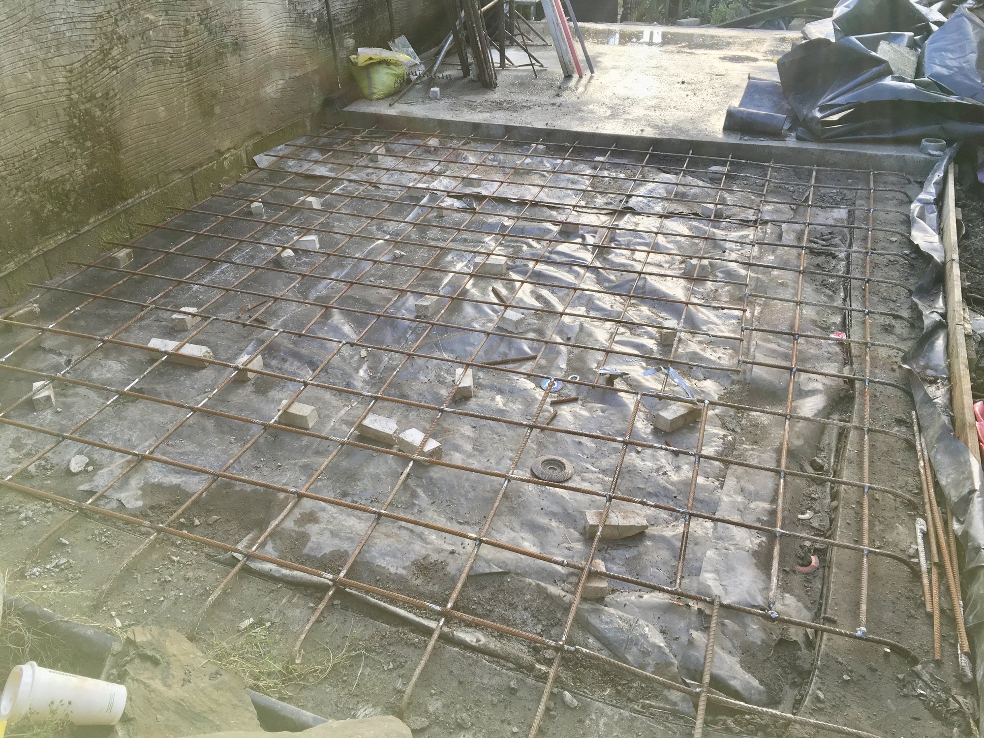

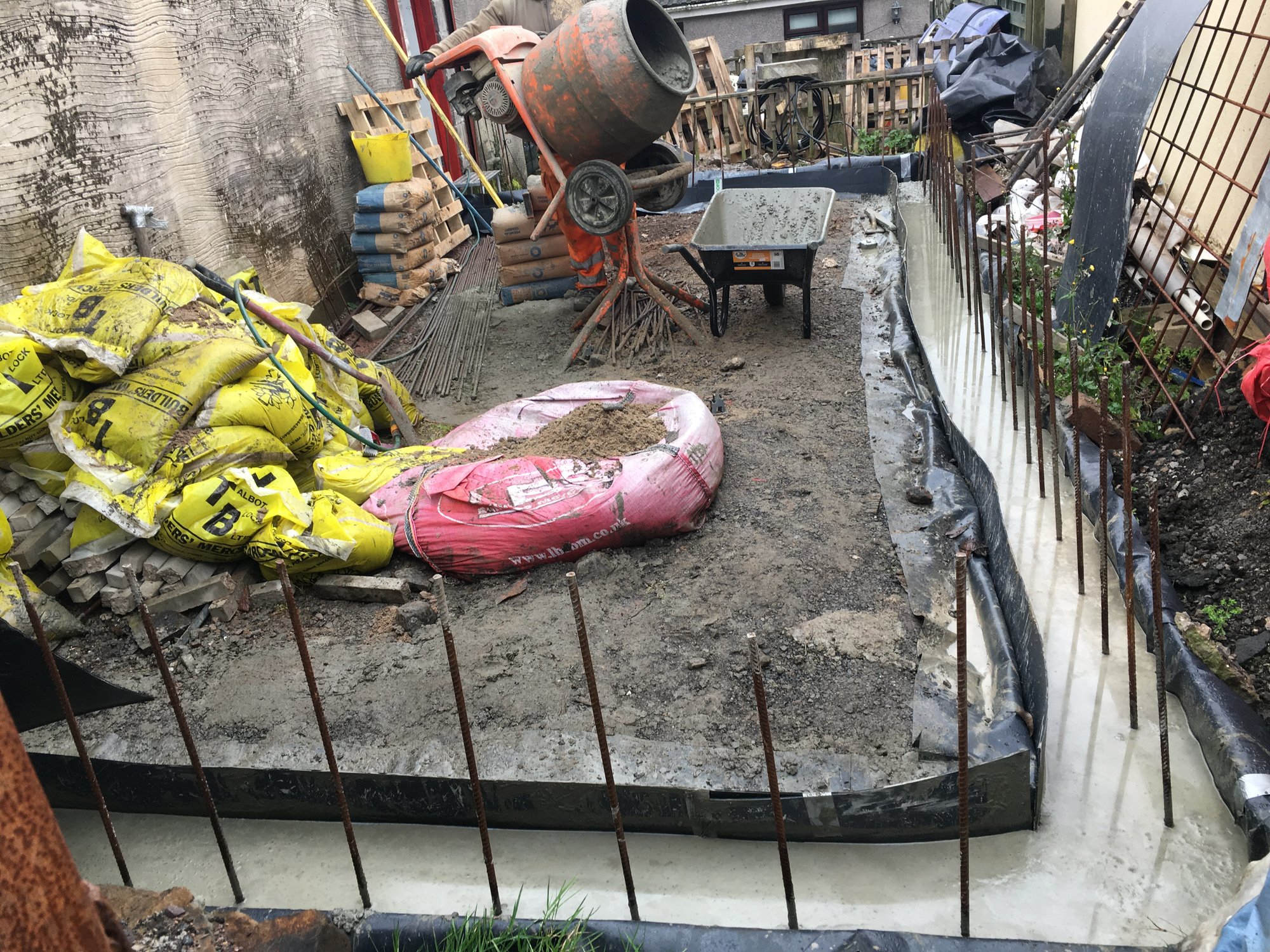

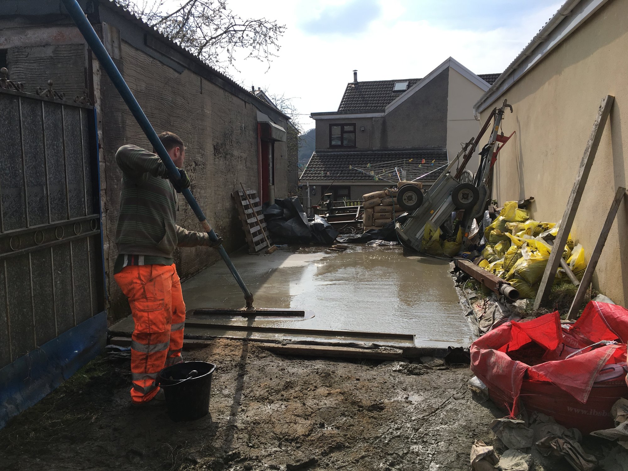

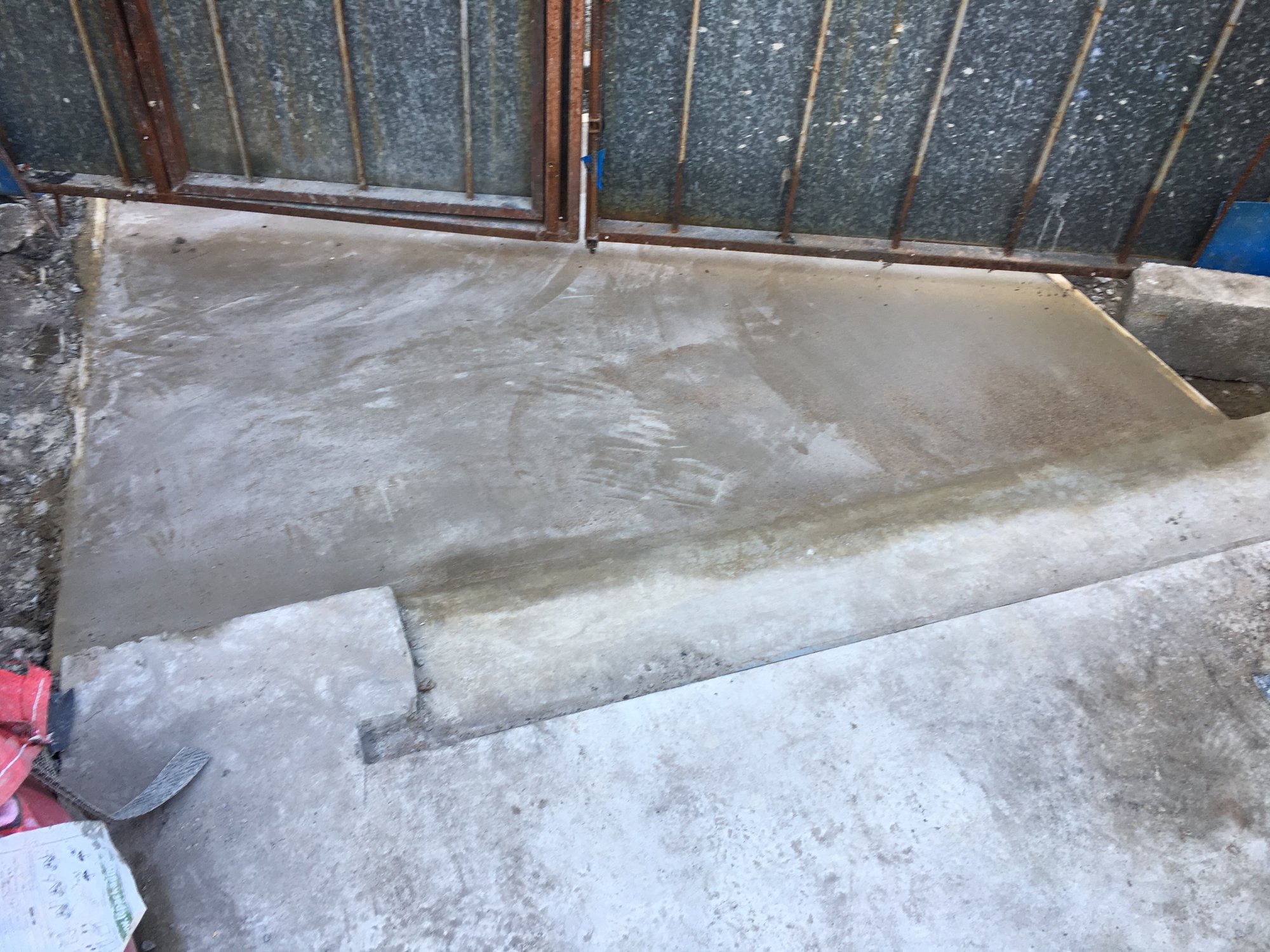

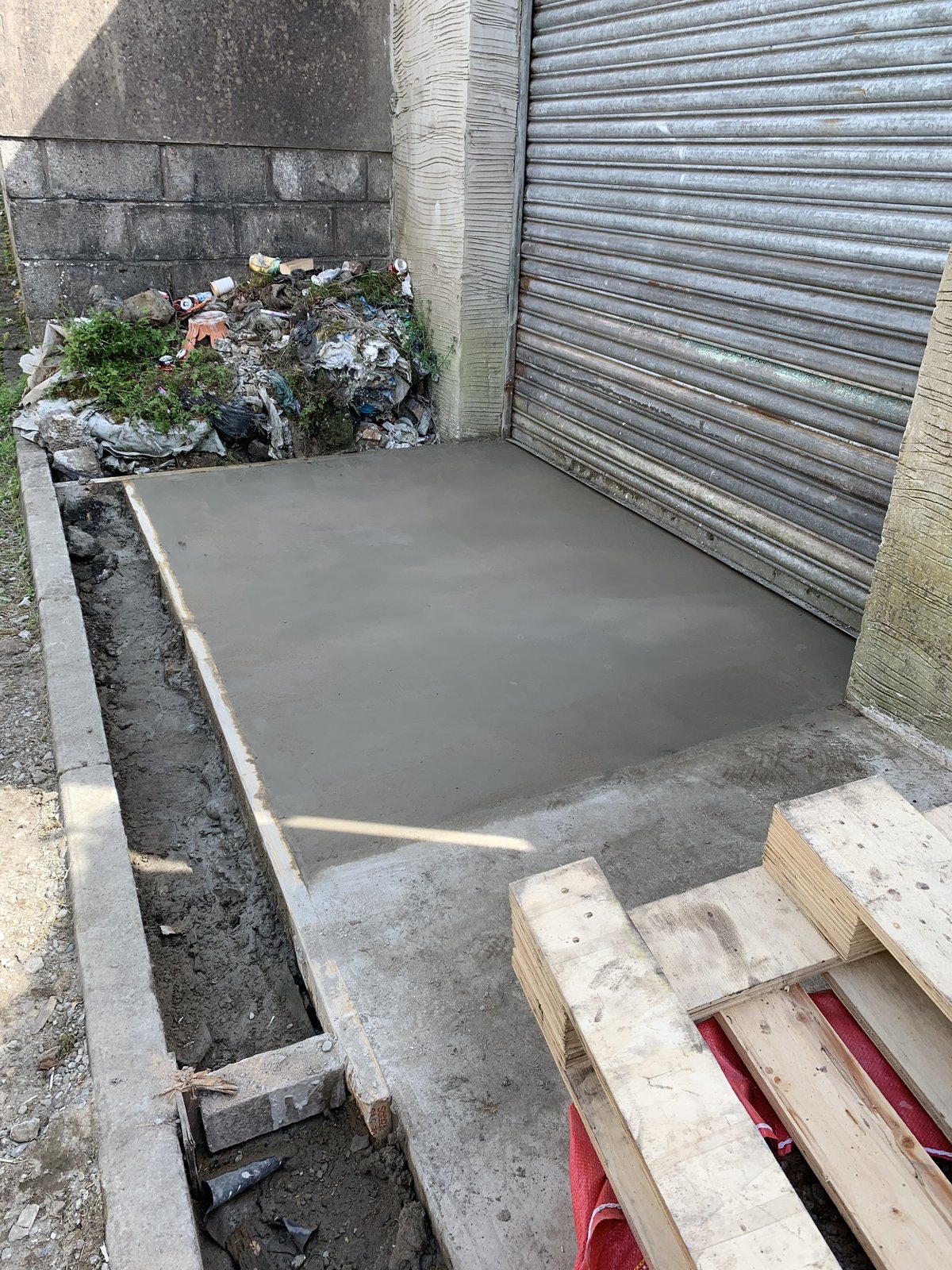

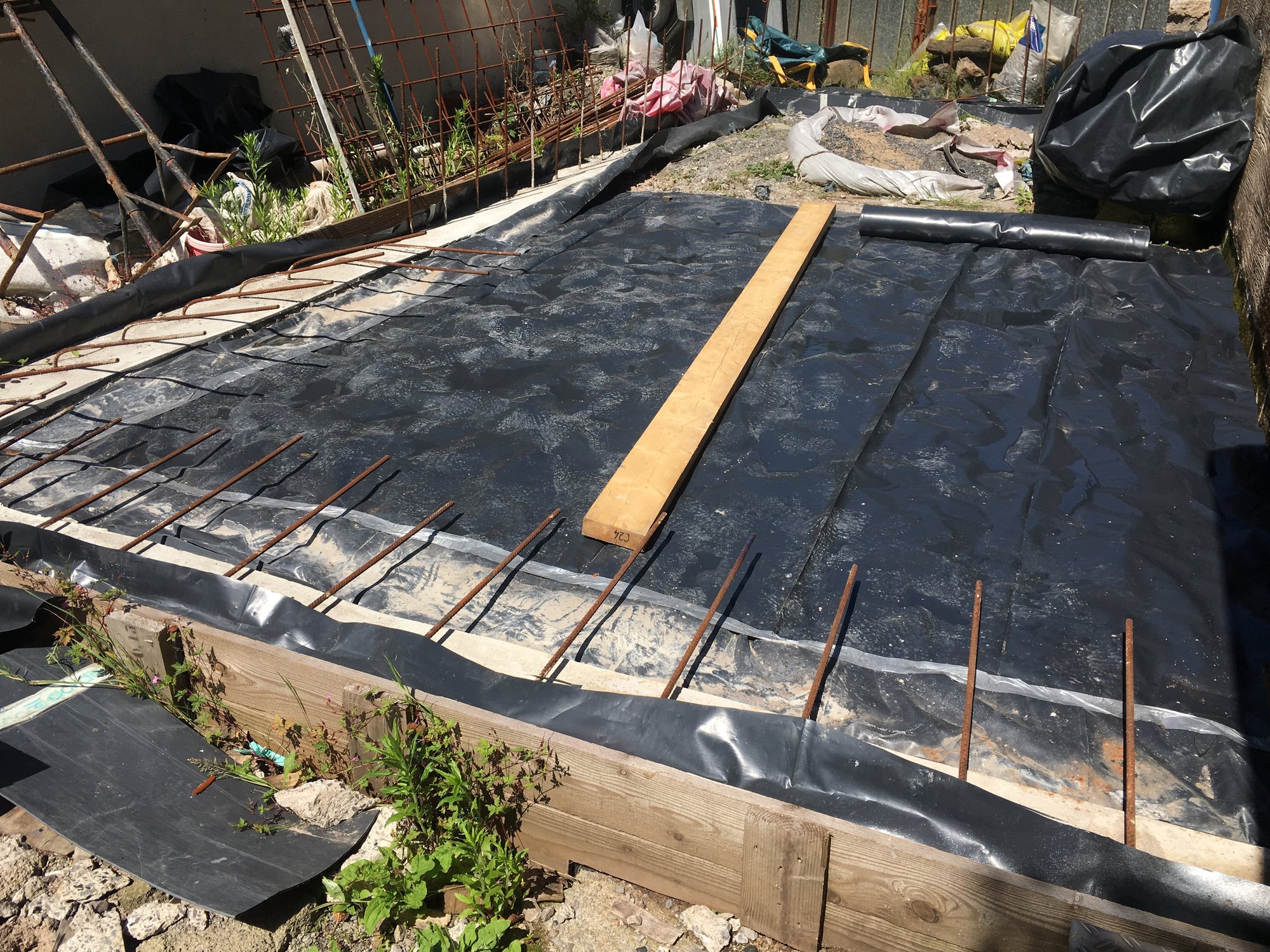

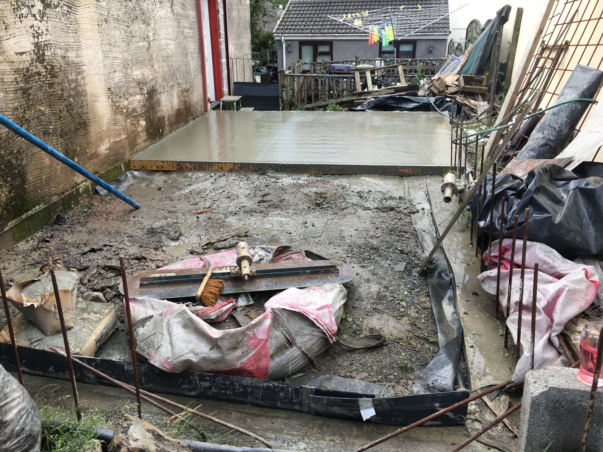

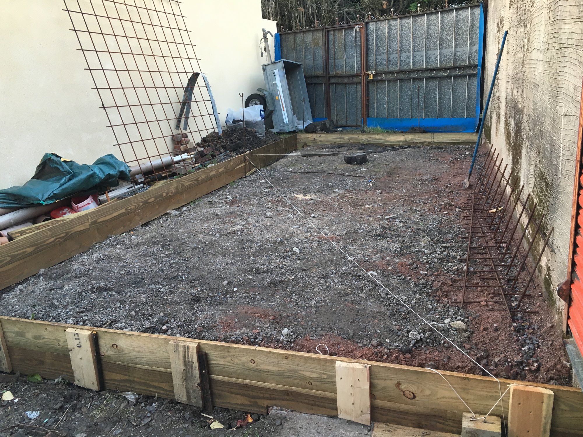

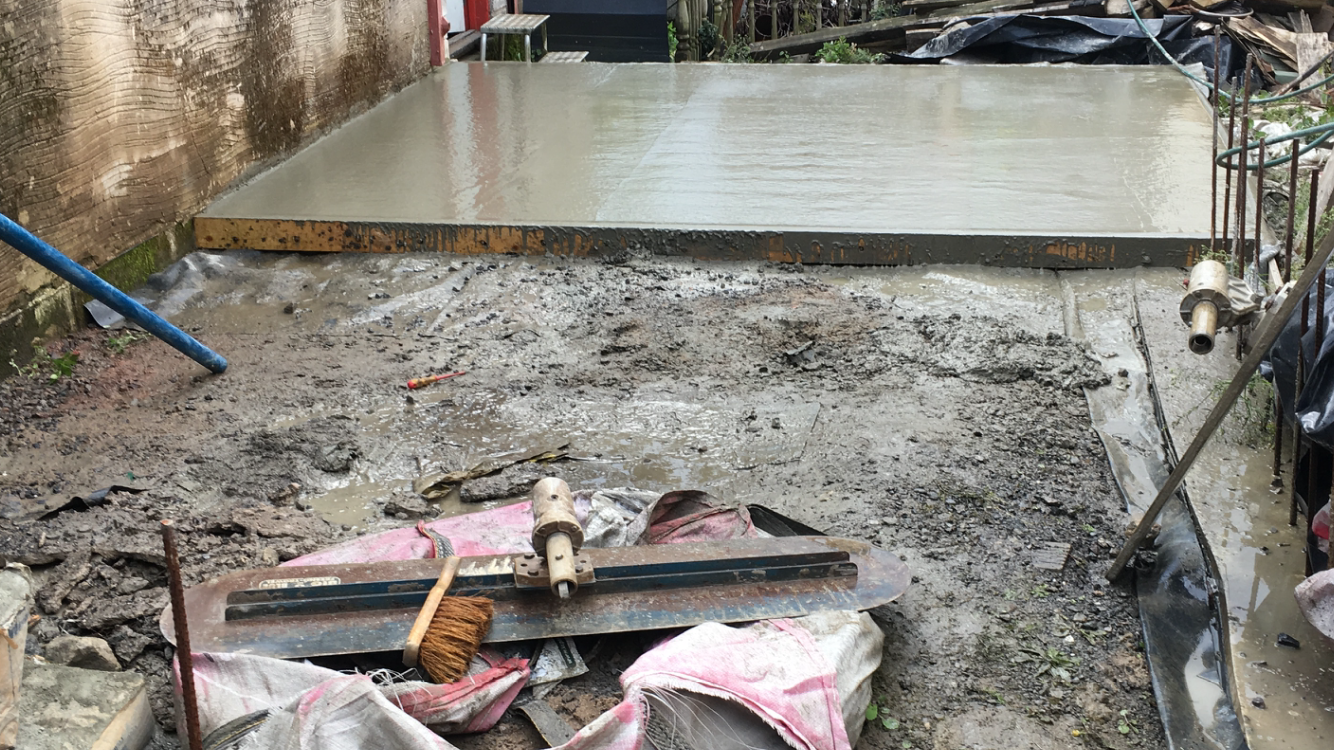

I've just dropped in a 450mm ring beam (well on 3 sides anyway) which consisted of rebar cages tied together and sat on plastic chairs or mars bars (50x50 concrete bars) to keep the bar off the floor in the footing which will then be bent over and tied into mesh once the decks have been cleared and the membrane has gone down. I am also contemplating batch mix or maybe doing it in 3 x sections making it easier to float off.
