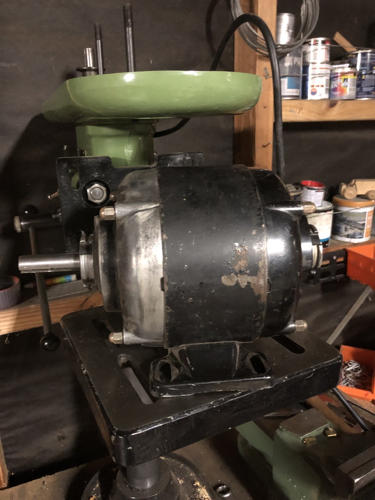

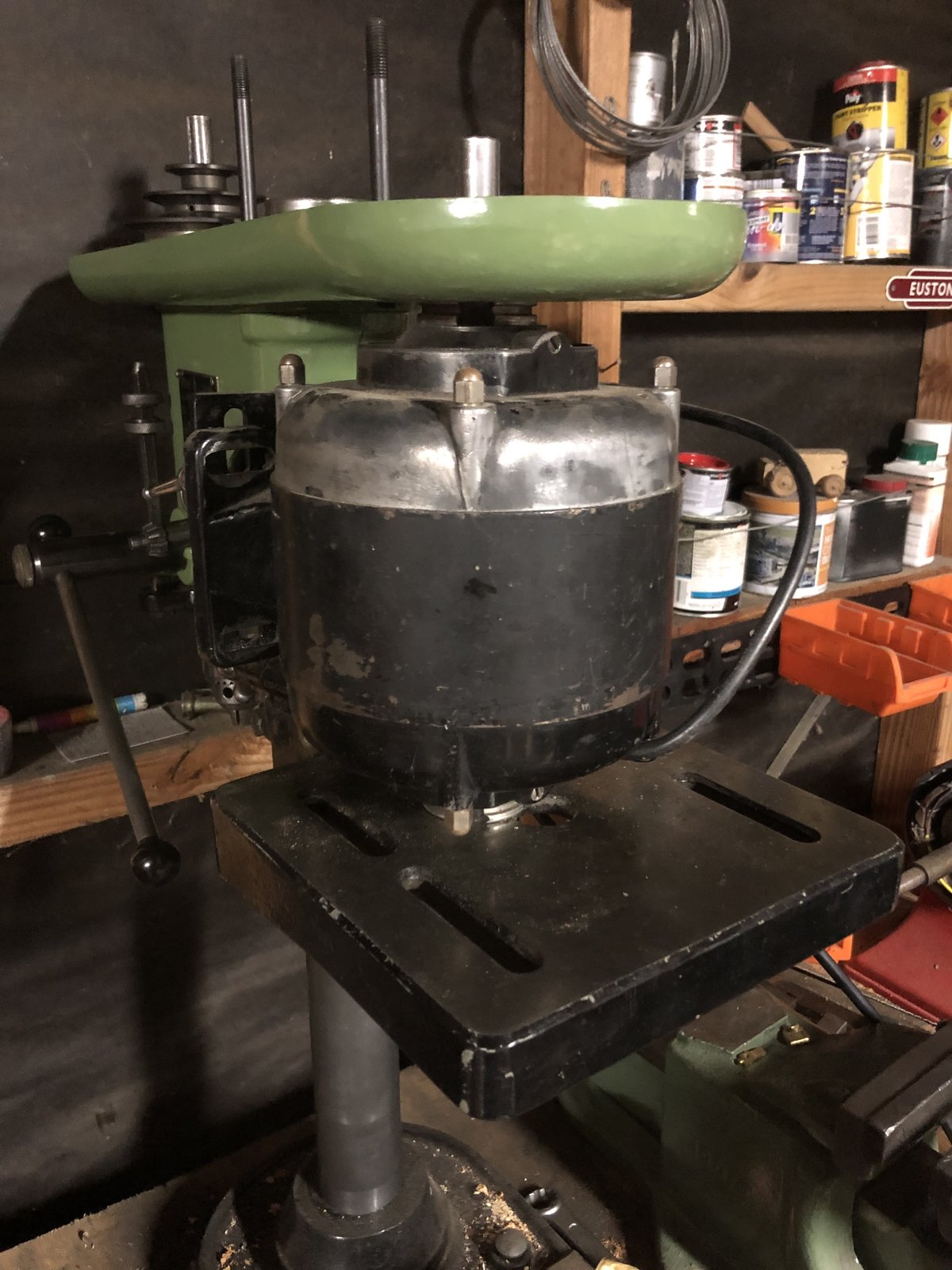

Remotoring to single phase might be easier to be honest. I took some pics for you tonight showing the best and most sensible way to remove the motor on a drill if you didn’t know. First raise the table up under it, then undo the bolts and let it drop down. Then sit it upright on its stand so you can disconnect it. Makes things a lot easier!
