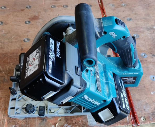

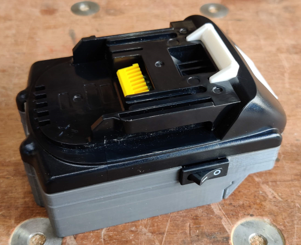

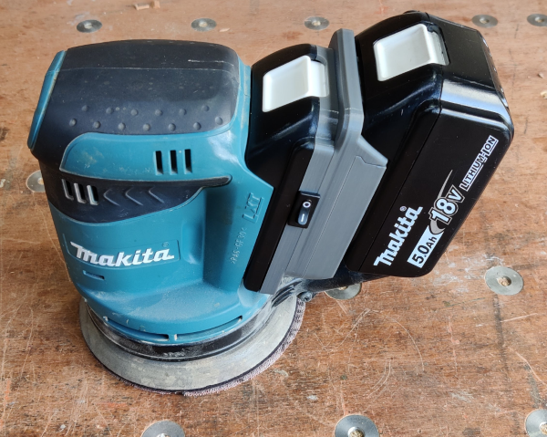

Today I finished making two battery adaptors, one straight:
and one with a slight offset:
These allow you to use Makita 18 V LXT batteries on Makita 18 V LXT Tools!
Don't give up reading this yet - there's more to it, honestly!
Offset version (which is angled up to avoid the vacuum hose on my sander):
Standard version (which sticks out a bit less):
e

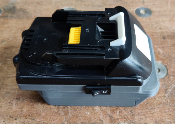

Unlike most battery adaptors though, these two have got a switch on the side. That switch has no direct effect on the operation of the tool.

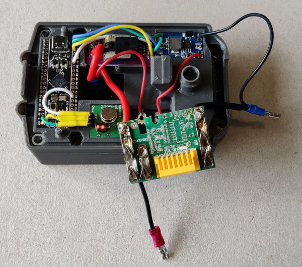

There's a bit more stuff in there than in your average battery adaptor:
Here it is without the wires attached for a slightly clearer view:
Starting at the bottom and working anticlockwise, we have:
The net effect of all that is that when I start the power tool, the vacuum cleaner starts automatically and when I stop the power tool, there's a couple of seconds of delay (to allow the vacuum cleaner to suck up any last bits of dust) and then the vacuum cleaner stops automatically.
Video showing it in action (first run is with the adaptor thing turned off, second is with it turned on) - watch the light on the power socket in the background:

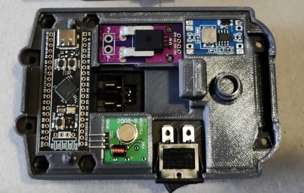

- A switch, which (when turned to "on") connects 18 V to the positive input of...
- A switched-mode power supply, which regulates that supply down to something more usable for:
- A hall-effect current sensor, which monitors the current flowing into the power tool and outputs it as an analogue signal, which is read by...
- A microcontroller development board (using its built-in Analogue-to-Digital Converter), which detects when the current goes over a certain threshold and then transmits a carefully curated signal via...
- A 433 MHz transmitter to...
