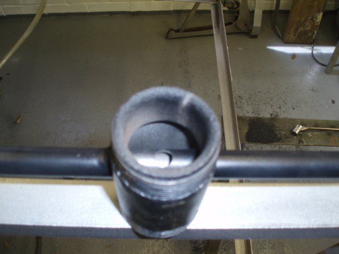

before i welded it onto the bottom of the cabinet
a little blured but you get the jist of it. note that the hole is in the underside of the pipe. i found if you have it in the top it will let too much media in no matter what you do with the air flow. with the hole underneath it has to suck the media in. it works spot on. i never get any of that gulping effect
