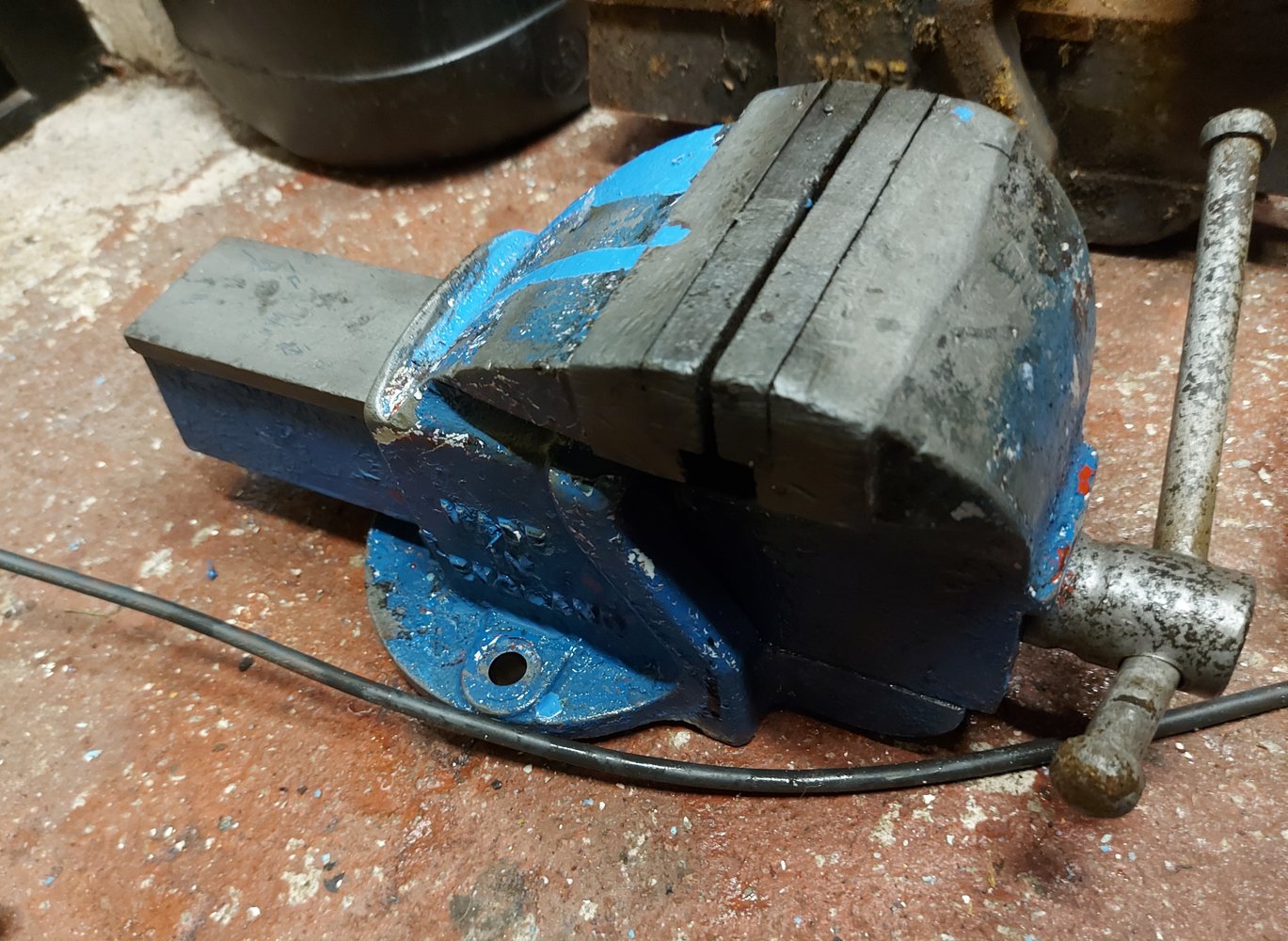

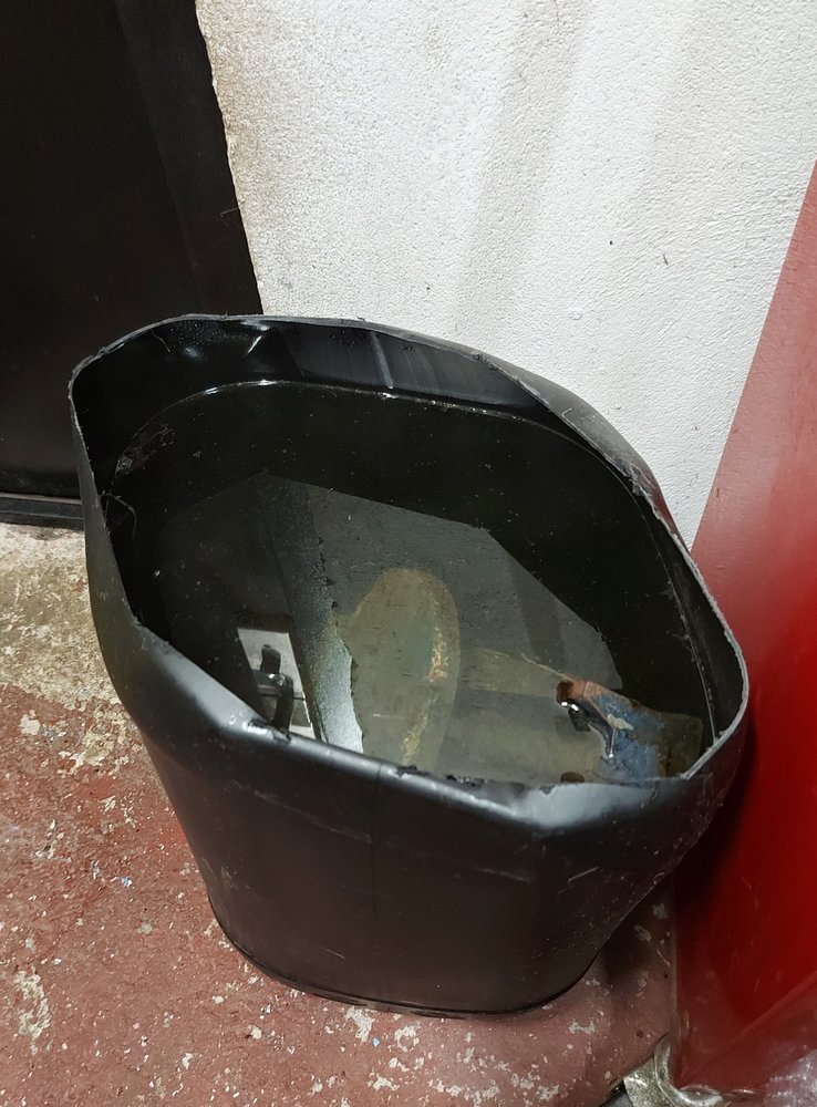

Today I cut the top off a 25L drum and added water + about 1.5 cups of citric acid powder.
I dropped in a rusty vice just to try this out more than anything else the vice will end up getting wire wheeled and blasted in any case.
Do I leave it in for 24 hours and check or how long really can you safely leave something submerged?
. With delicate stuff like that, I tend to err on the safe side, and keep an eye on it. Get some very pleasing results.
