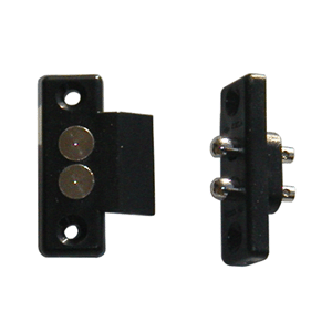

You would be bolting between the ball of the strut and the hatch which will conduct power
youre right i only saw one picture with what looked like an earth, my mk3 wasnt wired that way the wiring passed through a rubber boot at the top of the hatchSurely that would only work if the hatch is not earthed, which it almost certainly is. The struts are being used for the live feed to the HRW and wiper are they not and bolting between the strut and the hatch would give a dead short to earth.
If you can't get the OEM struts you may have to fit a flexible wiring connection near the hinges and go into the hatch skin there. I'm pretty sure lots of hatch-backs do it that way so finding suitable rubberware should not be too hard.
Could you redo the wiring and put an insulated contact between the boot lid and somewhere near the locking mechanism ...you would need to pass some wires through the lid....basically a contact which works when the lid is closed...am thinking you'll never need the heated screen when the boot is open?If you can't get the OEM struts you may have to fit a flexible wiring connection near the hinges and go into the hatch skin there. I'm pretty sure lots of hatch-backs do it that way so finding suitable rubberware should not be too hard.
