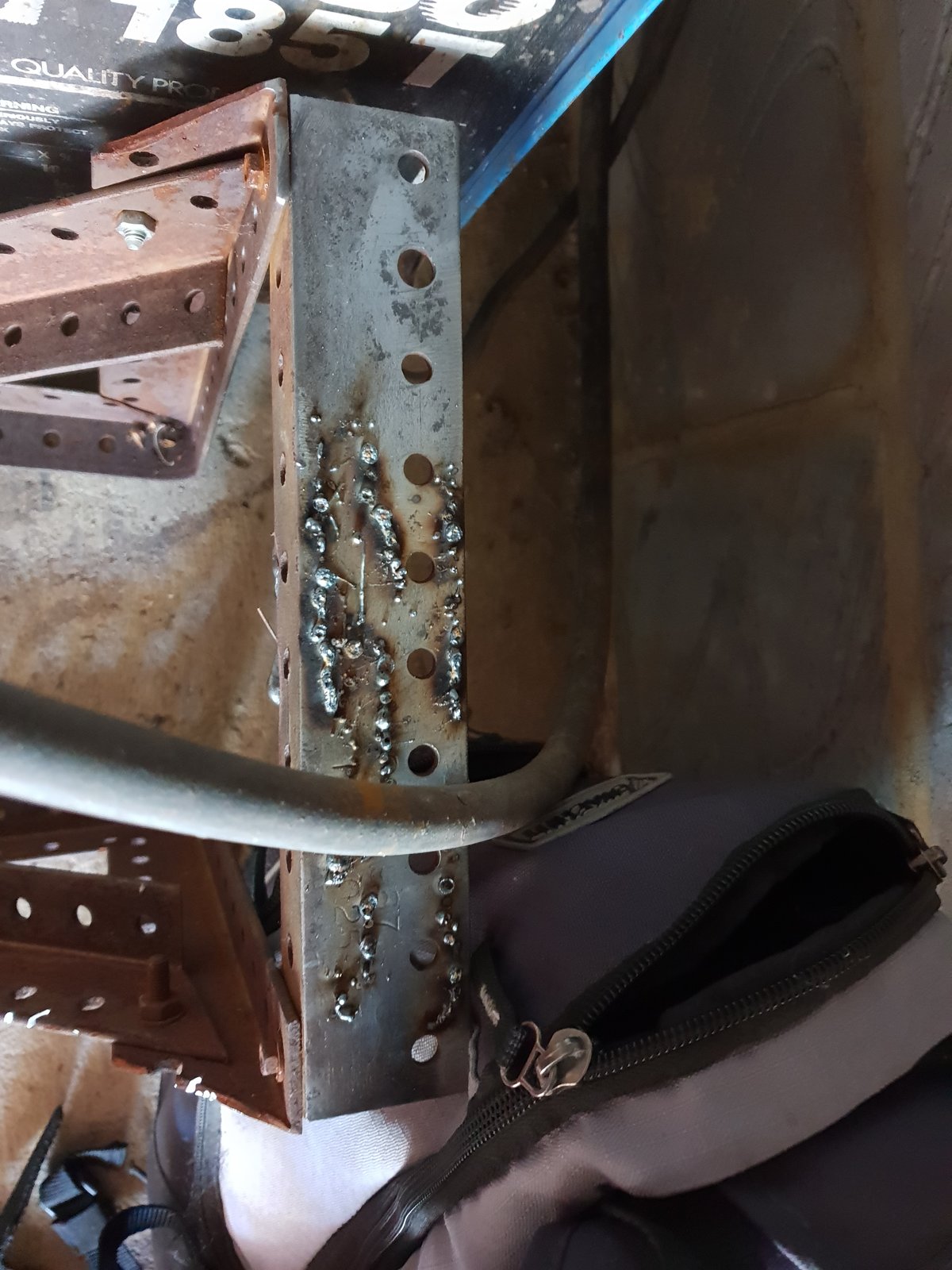

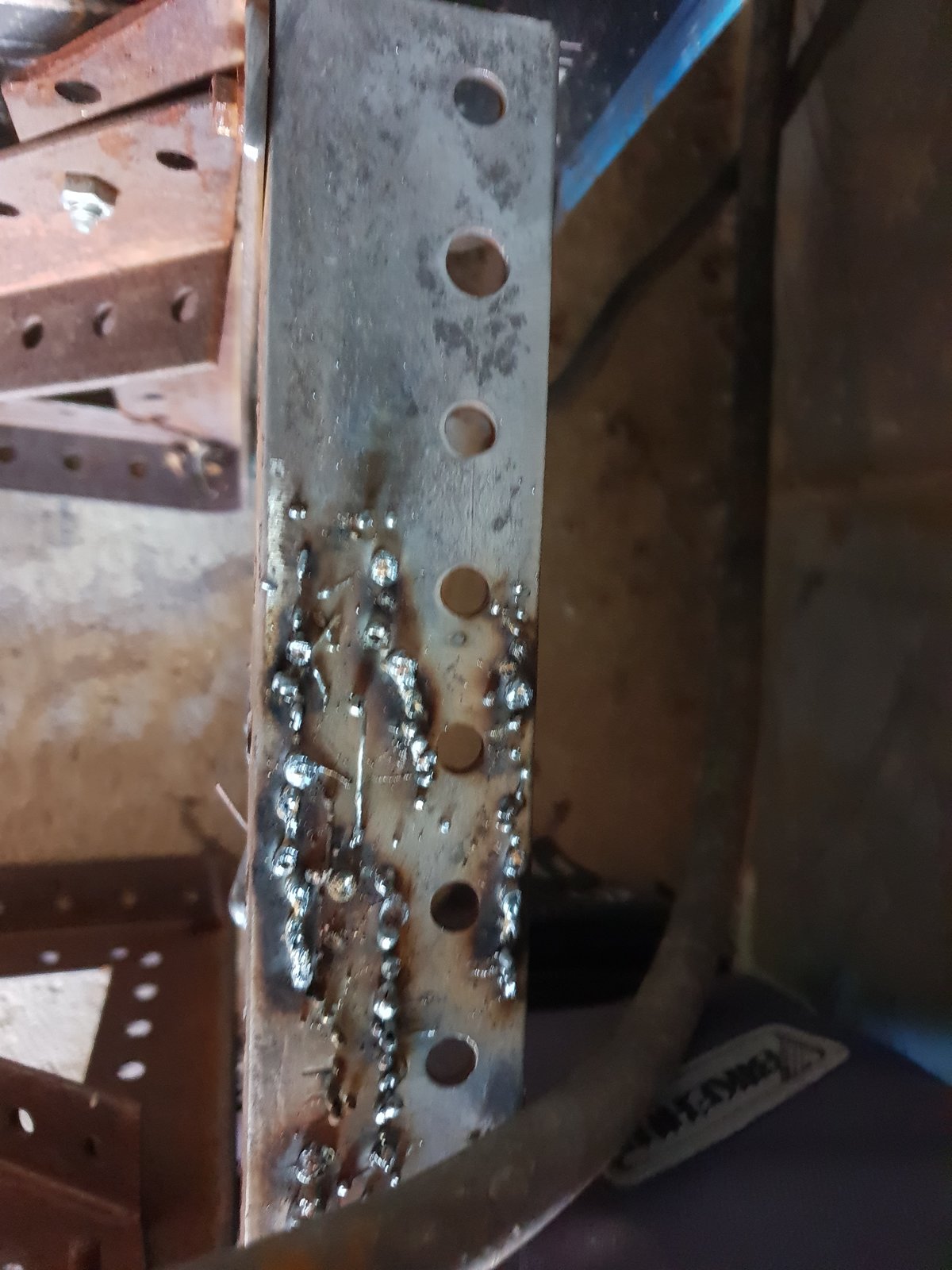

That's not welding.On a side note I was practicing with my mig (clarke turbo weld 185T) after a while not using and thit was spitting a lot of metal at me, not sure if the wire was coming out to quick or I was to far View attachment 225088 View attachment 225088 away or too close but this was the result any advice?
That's not welding.
Practice on clean steel (grind the scale off it), get some clean sheet, search this forum, then show the results - before starting on your car - you have some learning to do, but if I can do it anyone can.

Shouldn't be, but I may not have had the right pressureAre you out of gas?
Thank you Patrick that's great advice I appreciate it.pull the trigger, you can hear the gas hiss, or not, looks like no gas to me, I would take a good look at the rust in the sills and only cut as far up as you need to, pattern sills rarely fit as the originals did and are often thinner although that would be hard with a Renault ! come up say 1" past any known rust, cut a line and reassess, cut he repair panel say 1/4" taller and joggle the edge for it to go behind rather than trying to do a but on waffffer thin steel, take a look at mustie1 on ebay, he is no professional welder but has been welding up a rusty orange pickup recently, some good tips there, don't look at binky on youtube as that will put you off for life, well do look at it but not for inspiration, it has taken them 5-6 years so far!
