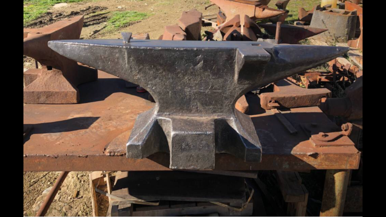

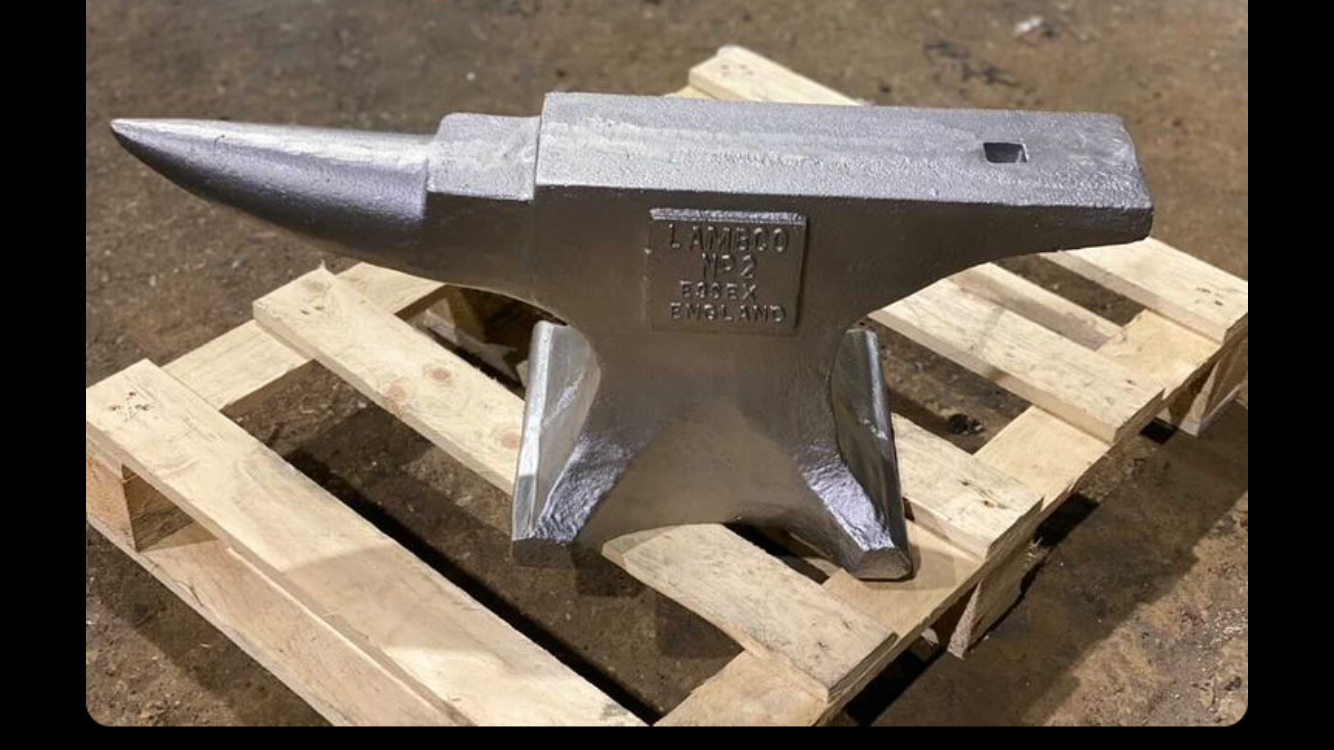

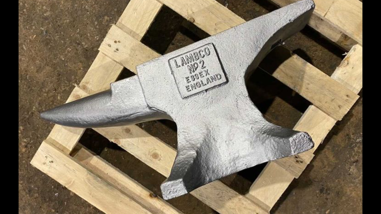

very nice there no set weight for them so i wouldnt worry . i have one i bought 50 years ago about half the size of the norm and its well heavy enough to take a beatingRunners and risers cut off and shot blast
Next step fettling heat treatment and plough grind the top
Gutted as it only 190lbs but it was a complicated shape to eyeball to weight View attachment 272978View attachment 272980

Have you never been warned about hitting two hammers together?My consultation with those who know would suggest a soft anvil ie medium carbon would be soft and useless and a toolsteel heat treated to correct hardness is best
To be quite frank I’ve consulted with those in the know who make anvils both hand and power hammer and I’m going with them not someone off t netHave you never been warned about hitting two hammers together?
I didn't say anything about using mild steel, although a mild steel with a higher carbon steel top work fine as an anvil. I make hammers for a living so i've half an idea what i'm talking about.To be quite frank I’ve consulted with those in the know who make anvils both hand and power hammer and I’m going with them not someone off t net
We are not talking stupid hardness levels but can assure you mild steel would be useless , infact mild steel isn’t of much use for anything in a high load or wear situation.
