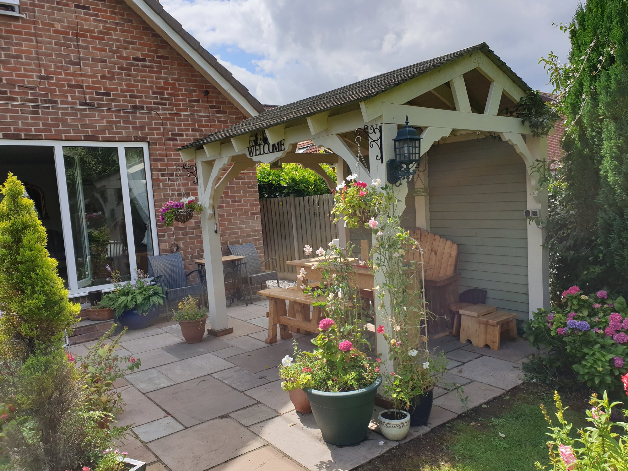

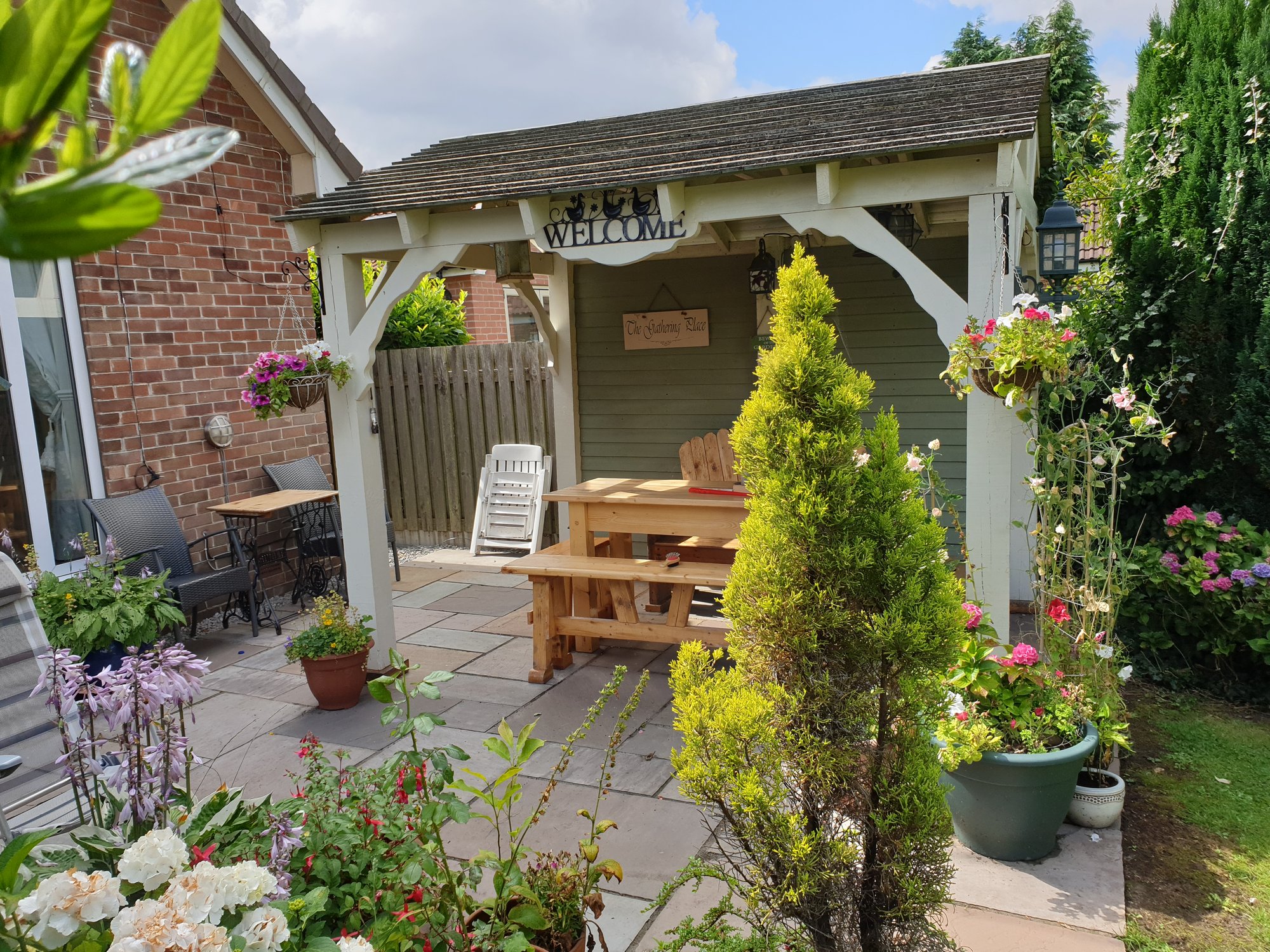

at least...scraping and painting......its actually rotting at the ridgeWow, I like that!
What does the roof need? Looks good to me![]()

Here is my gazebo.....its a bit high and the rain comes in.....Id like to put sides in but I think it would look a mess
and the roof needs something....built it in 2013

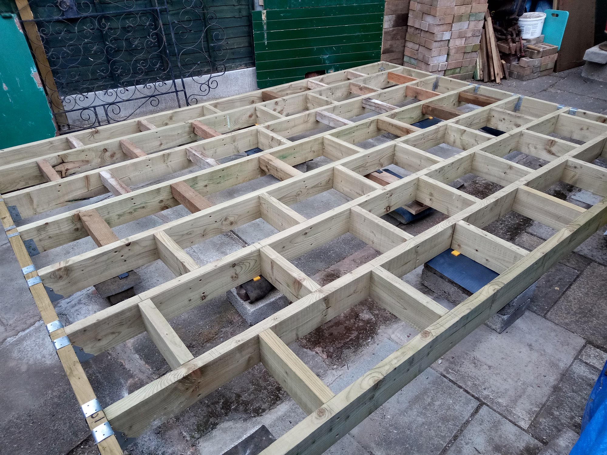

Whats the chance of taking the load off and cutting 6” or more out of each leg to drop it down?6x2 was almost given to me so not to be passed up. Yeah I know it's wrong after seeing other builds . But two late now. It's starting where it is now.
Its possible....Ive got a jack that would do it....its finding the enthusiasmLooks very posh.Whats the chance of taking the load off and cutting 6” or more out of each leg to drop it down?
either go up or go down you have plenty of bricks so go down and you can use your frame to get the bricks level
lay those every 3ft apart apart or do the ones at ends middle and far end let them set and when lowering make a bed of cement and put brick onto it and lower the frame down to the new height the cement will push out to new level until rested on the old solid bricks prebuilt there
Hi I haven't even started the walls yet but I will be using 4x2 for walls. But unsure on on roof was going for flat roof one end higher than other allowing for fall off.
Overall size of base is 12x9ft so what would be best size for roof lumber ? 5x2 ?
It will have 18mm osb3 on top of roof rafters then maybe that rubber epmd ? If that what it's called.
pref 5x2 for the 9ft gap
6x2 for the 12ft gap
factor in your stood on it and also boarding it also stick to 16" spread but can go wider the wider you spread the rafters the more it bows in the middle when your stood on it
