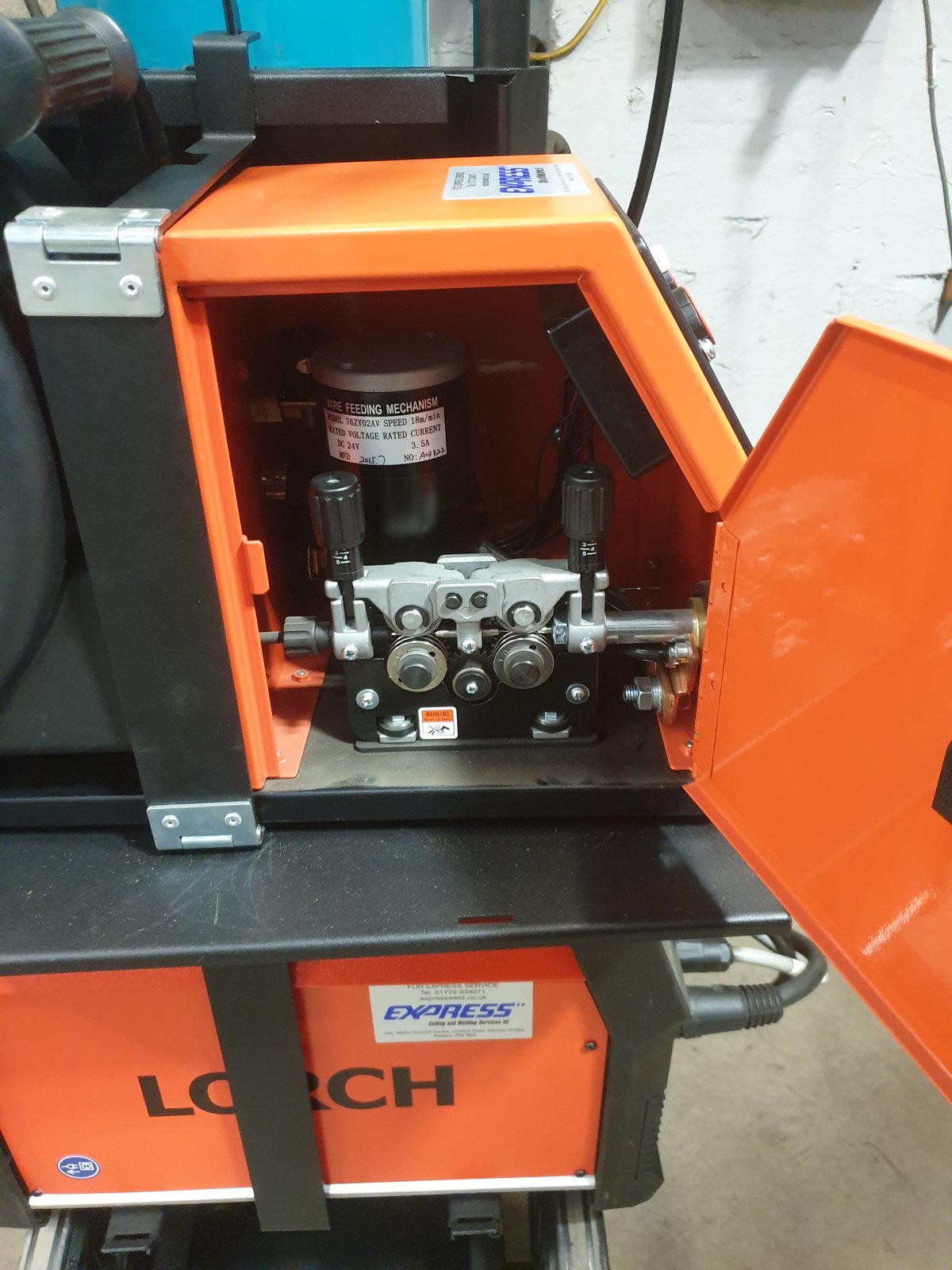

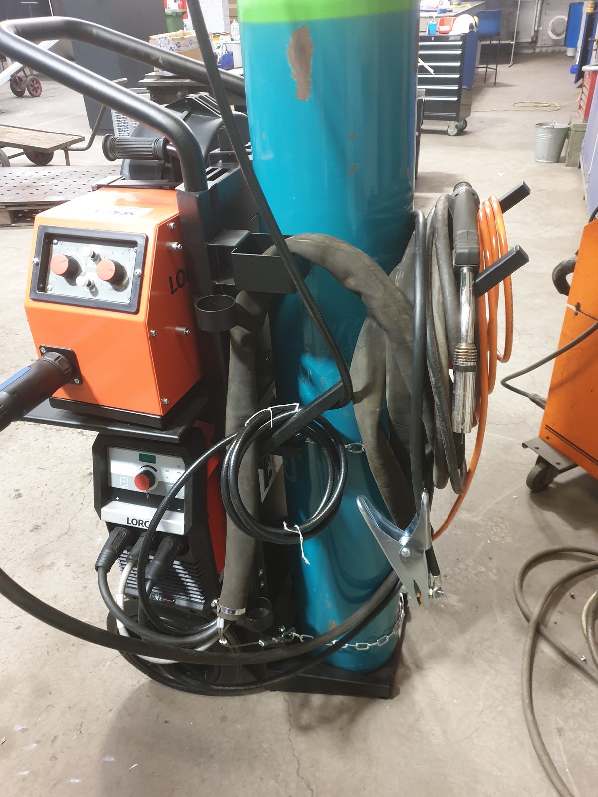

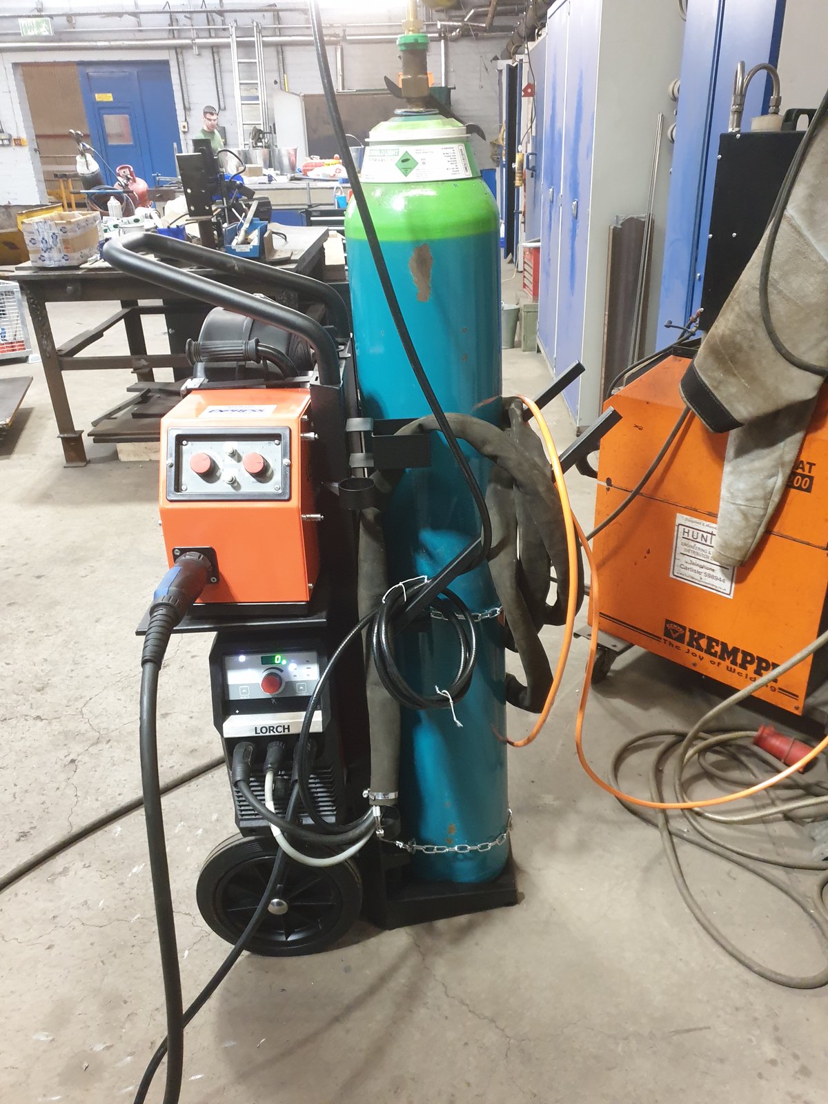

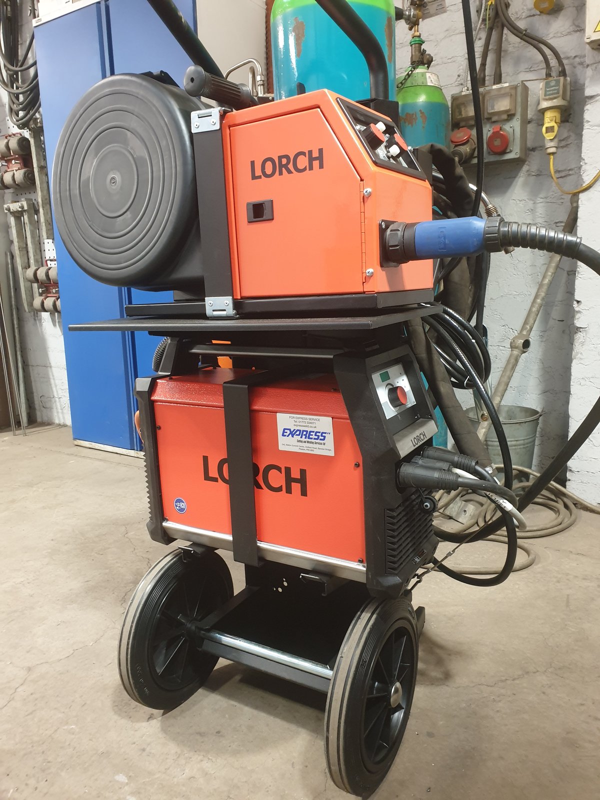

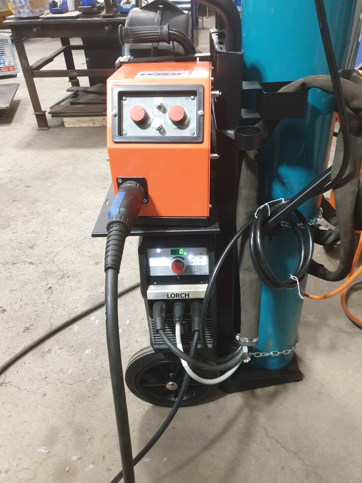

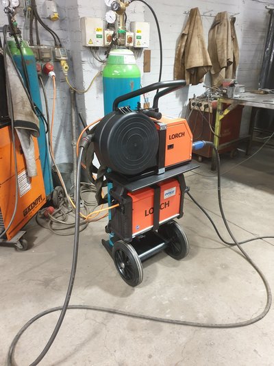

I got the go-ahead this morning to get the MX 350 package as well. We're building a new production line next year, so a portable MIG/stick set will be really handy.
We've went for the full package - feeder, 5m interconnects and the proper trolley, sack barrow style with the bottle on the front.
The wirefeeder isn't made by Lorch, but it's a hefty, well built unit. The only downside of it is there are no digital readouts in the feeder. Not a problem for us, since we'll leave the setup on the trolley 99% of the time.
The unit has a synergic line built in, in fact it's a bit tricky to get out of synergic and into manual. The synergic line had wayy too much voltage the way it was set up, but I was told it's possible to tweak the line in the backgroud? It was useless, as it was. Solid 1.0mm wire, argoshield light.... actually, thinking about it, it probably would have been a lot better on argoshield heavy.
