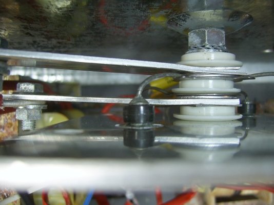

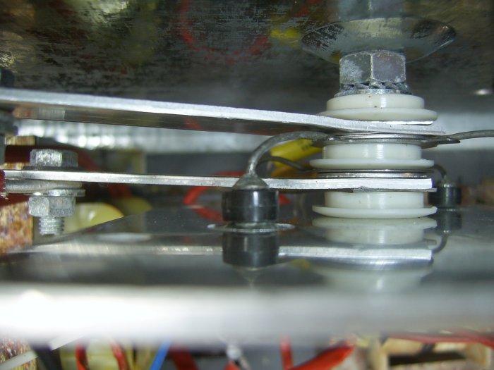

no numbers or color codes on the diodes, one is shorted and the 3 others have the cathodes pressed into the heat sink, which does not make sense if it is a bridge.
It's not usually a full-wave bridge in a MIG set, there are usually multiple diodes in parallel to share the load in a half-wave bridge configuration.
