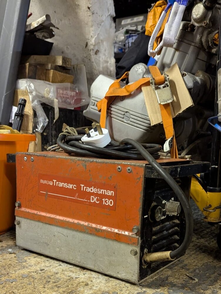

I acquired this very cheaply (£40 I think it was) - a bit battered & grubby but seems to work perfectly.
Weighs 29Kg so a bit hefty compared to my little inverter...

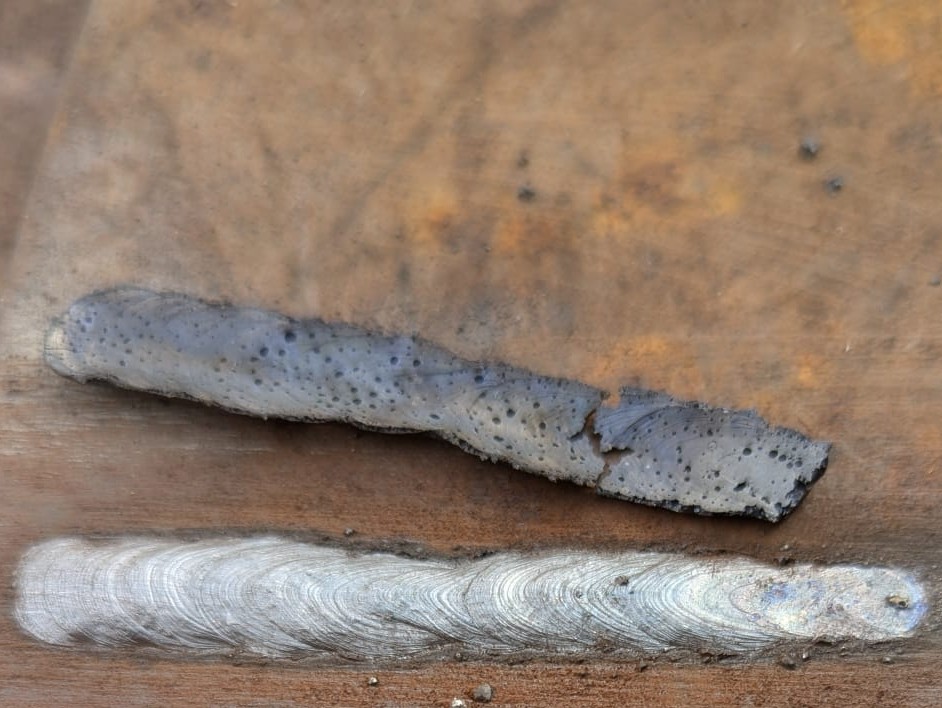

Got a nice peeler when I tried it on some unprepared scrap...

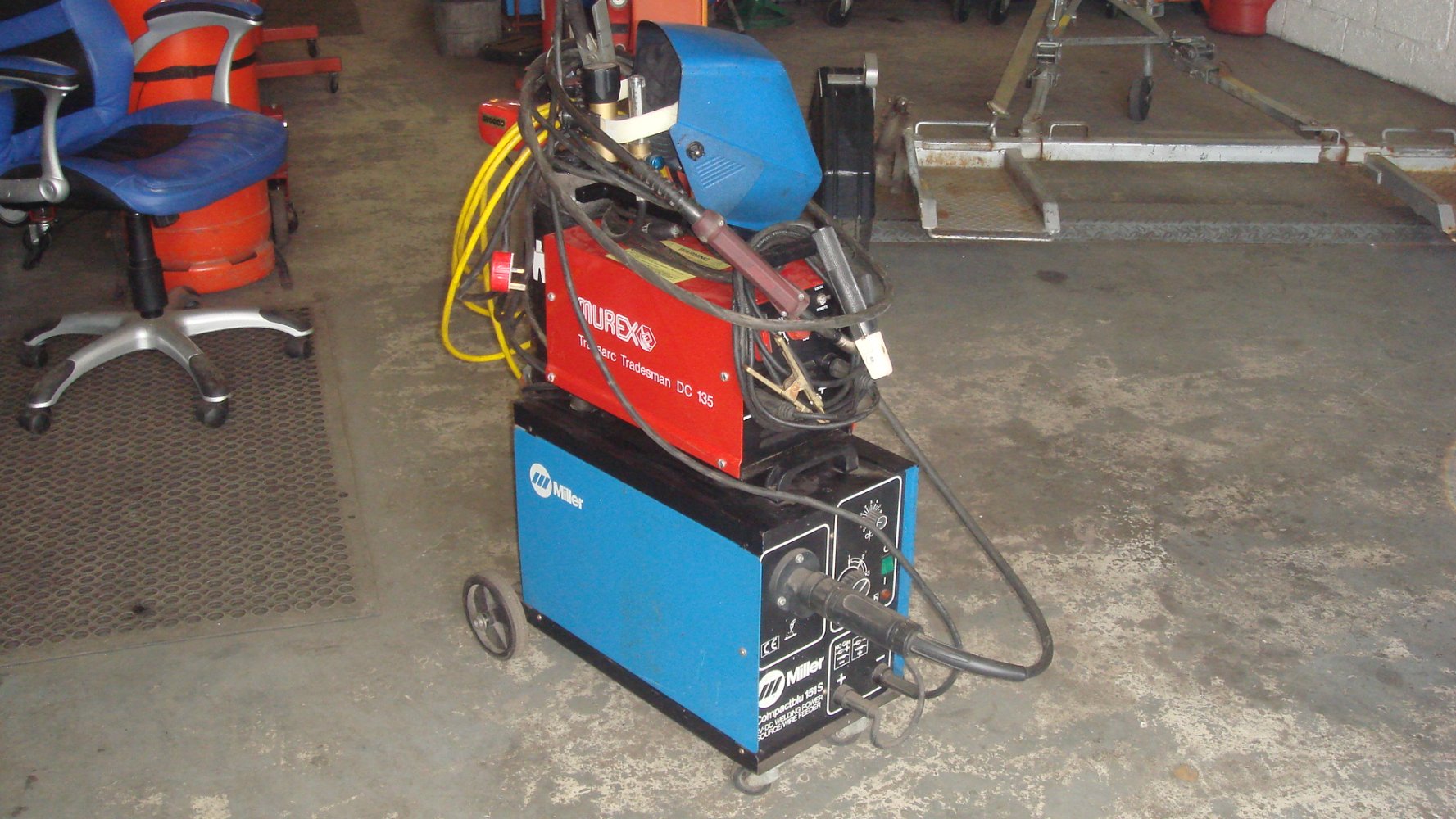

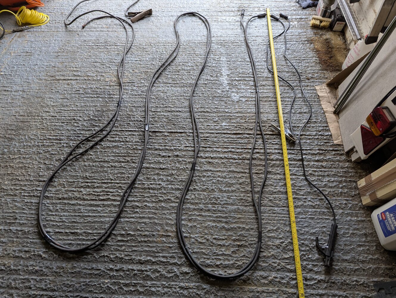

I didn't really need the Murex as it's my 3rd Arc but the leads were too good to miss (9 metres long) !
... shown here next to my existing, embarrassingly short, cables.

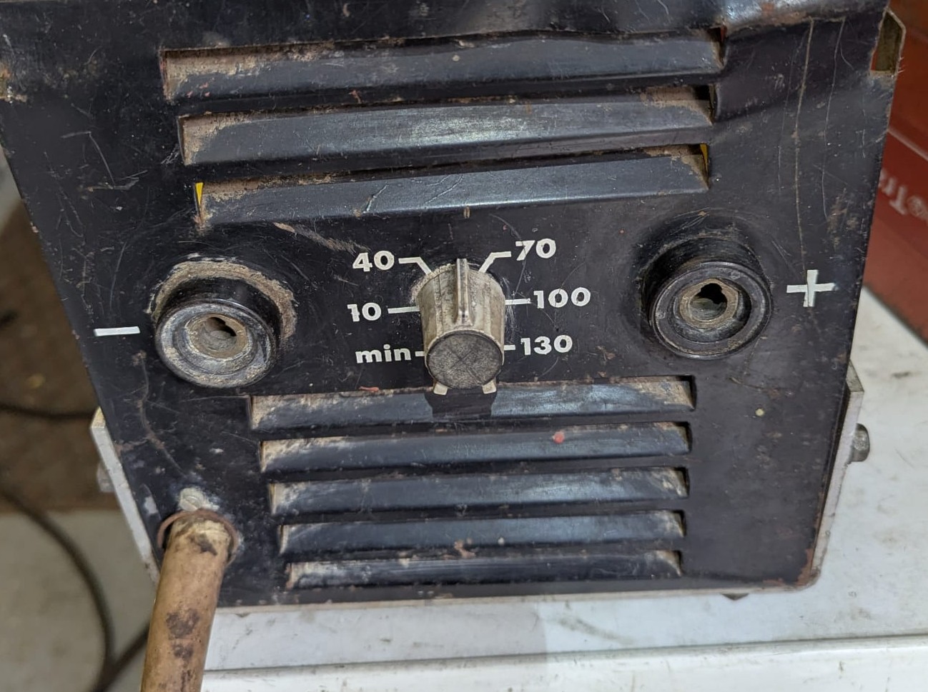

But as it works, I found the manual online to get familiar, and read that it can also do lift Tig, which kindled more interest...
Has anyone on here tried this as a cheap-ish way into Tig? I'm tempted to give it a try, in a "The Good Life" kinda way.
My usage would be for small items, metal models, where Arc is a no-no and even Mig can be a bit too fierce...
I started one several years ago but stopped when one part needed some careful Tig more than Mig... so put it aside for the "one day" ...

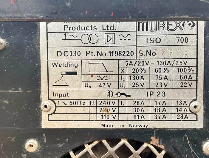

The manual and the data plate say it operates as low as 5 Amps... - does Tig really work & get used with settings that low?
I found a "looks like a bargain" torch which seems like it should work with the unit - https://www.ebay.co.uk/itm/388221572589 or is it too cheap to be any good ?
I realise the Murex has no modern adjustments like cleaning, pulse, gas delay, anything really, so entirely manual for gas-on/start/weld/stop/gas-off.
I know I'd still need Argon & regulator, tungsten & wire, so still not exactly cheap...
Question is, would you give it a try ? Or done do already ?
