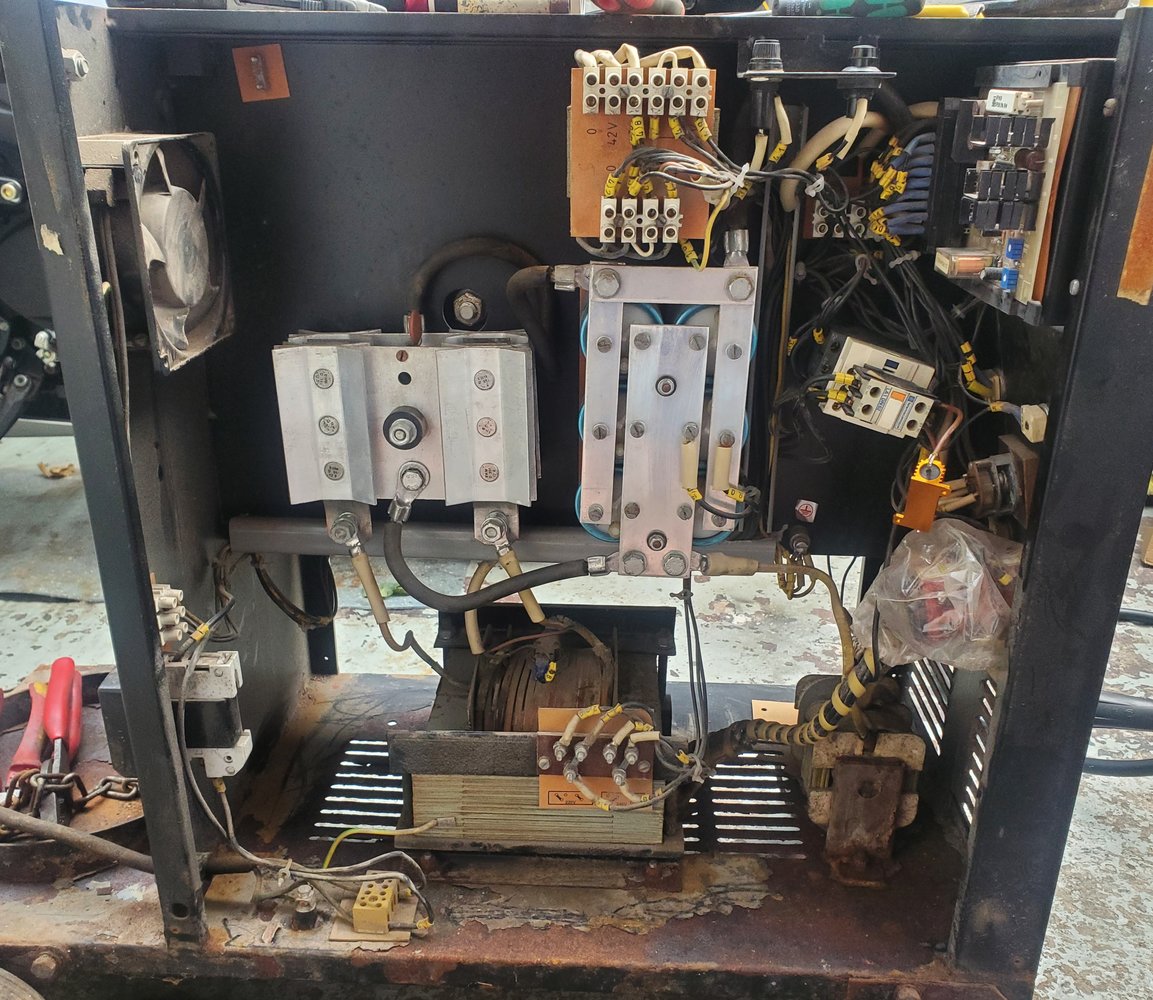

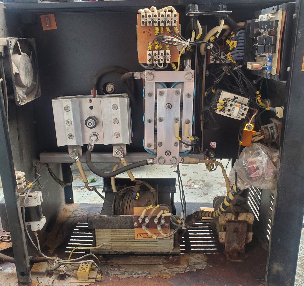

I've now fitted new resistor, earth lead/clamp and new torch, cleaned machine out as best I can and cleaned all contacts with spray. Tested DC voltage at tip in each power setting, results as follows.
1-20.65v
2-21.06v
3-21.80v
4-23.40v
5-24.93v
6-26.61v
7-28.90v
8-31.18v
Do these seem okay or do i have a issue i need to look further into?
Many Thanks
Steve
