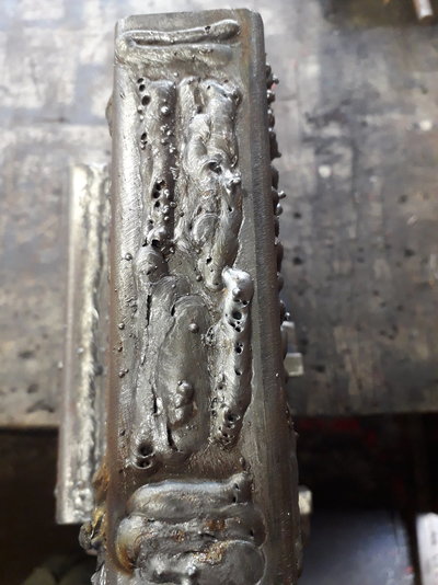

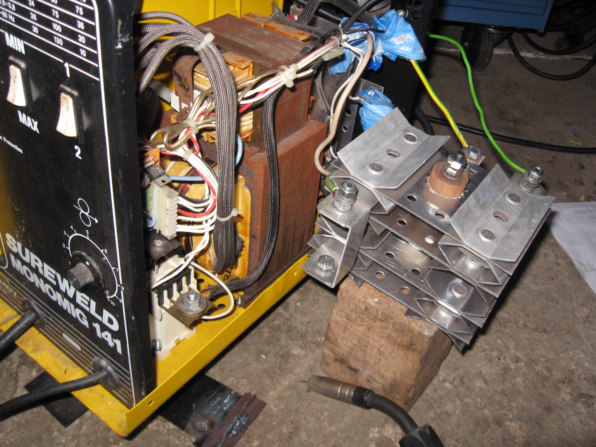

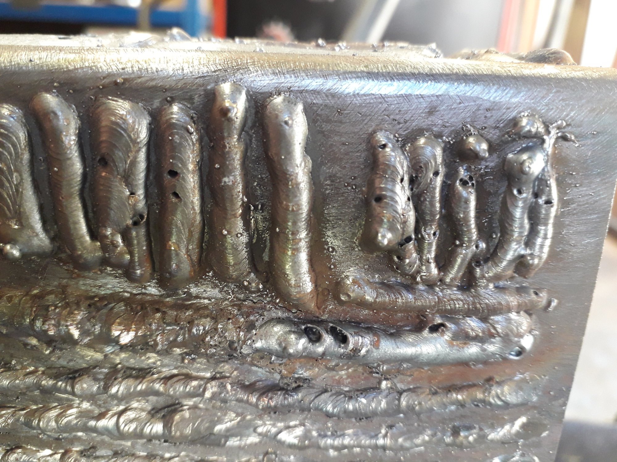

The other approach i thought of was to put the ac mains into the rectifier unloaded, with the outputs insulated and disconnected from the welder,with an ac current clamp monitoring the load input on the live only. in theory there should be no current being consumed ,but due to efficiency losses it may draw something. if however it was sucking loads of juice,say above 1amp at 240v ac then it would be clear that the rectifier is partially shorting and wasting power. You could put a bulb across the output,ive never tried lighting up a bulb at 240 volts on dc. Beware!!!! anybody else have any thoughts?
I understand that, I think I would like a second opinion as to whether that is ok to do purely because that is kind of on the limit of what I would understand. I would be quite happy to do it safely, just whether I am likely to blow something up!
