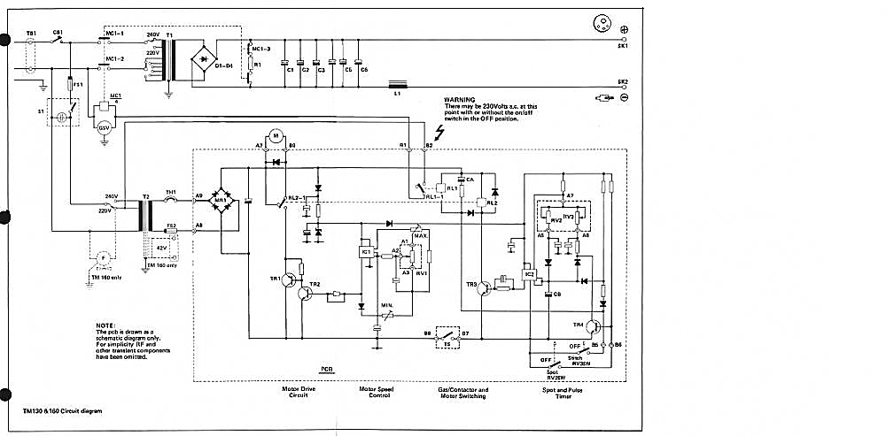

Hi all, I have an old Murex 130S which I haven't used for a while, powered it up had wire feed but no gas or power to the torch. The main contactor is not pulling in, I popped a meter from tip to earth, pushed in the contactor and I then get welding current on all settings. There are a few circuit diagrams on the forum but most are .jpg and have no component identification or voltage information and when you expand them to print the quality isn't great. Could anybody point me in the right direction or post a diagram in .pdf format?
