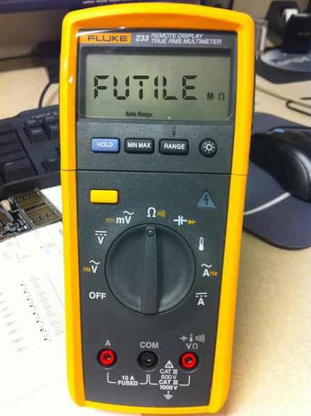

have you got one of these Fluke meters, they have a special range on them for people like you![]()

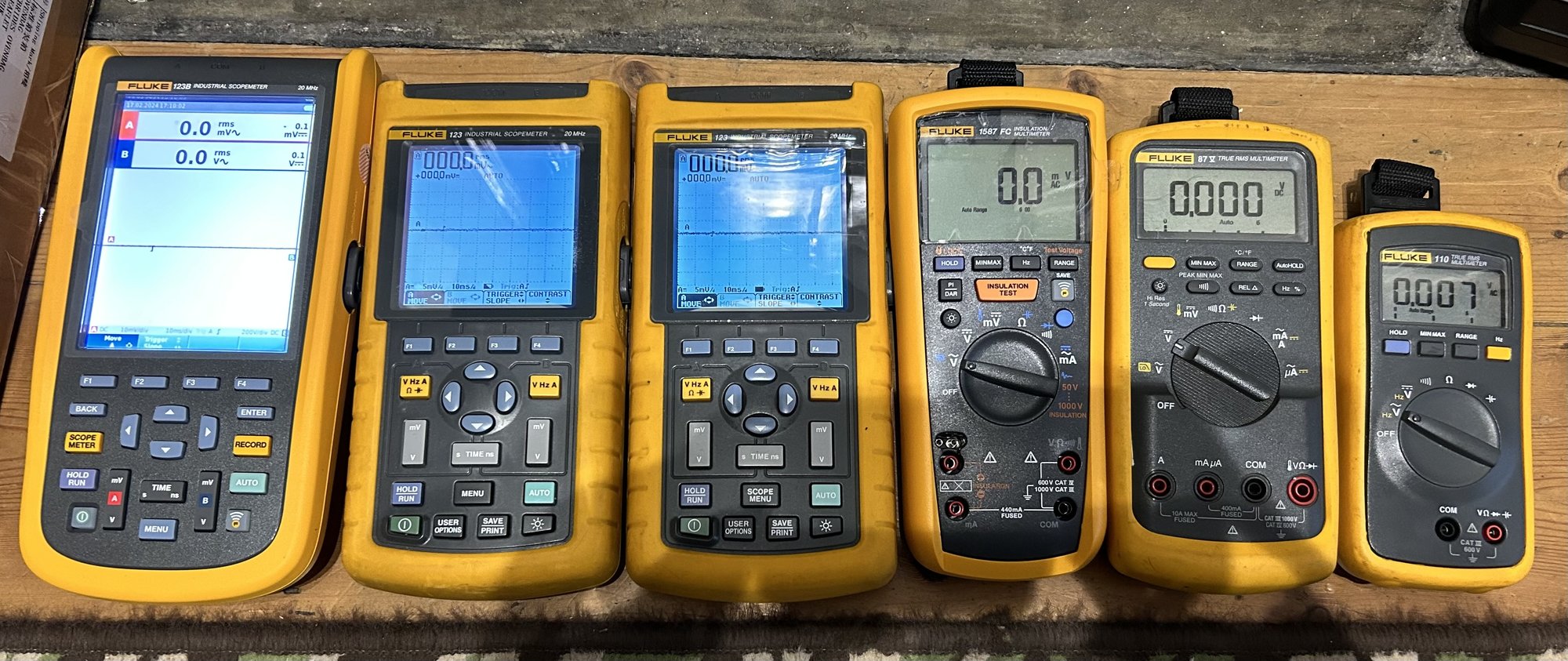

When I'm on my death bed though, I'll never be thinking: "I wish I'd...". I treat every day like it's my last.Can’t beat a fluke, I use one most days, usually the cheapy on the right unless stuff’s going wrong…
Secure power, briefly dipped into solar farms but they are horrendous bodges in most cases with no one wanting to spend a penny. 90% now is data centre power.
Use these to capture rectifier input waveforms etc, step upto 3 phase power meters to monitor load steps, capture transients on transfers, monitor efficiency etc
Use far more expensive Flukes but the 435 and up we borrow/share/rent etc

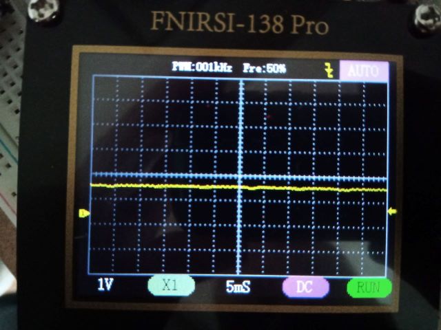

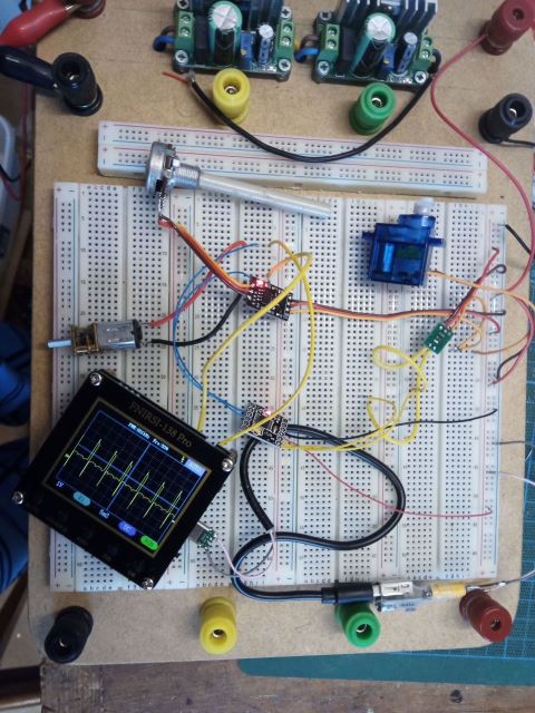

I was planing on taking it to our model engineers meetings to give 5 minute talk on them and planned to show how they can be used with radio control to show the waveforms that operate the servos (50hz square wave with 5 to 10% duty cycle) and speed controllers). then thinking about it further I thought why not build a handheld unit with a oscillocope only (FNIRSI 138 Pro for less than £20) to show how the electrical signals change
to show the electrical signals that work in radio controlled models using a cheap oscilloscope.
A) I can show the analog signal (voltage) across a variable resistor.

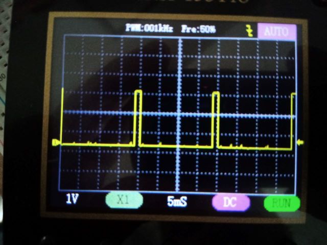

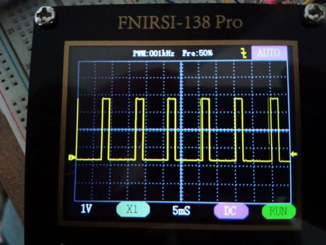

B) I can then feed that into a servo tester, which converts it to a 50 Hz pulse width modulation signal with a 5% to 10% duty cycle (which is the standard type of signal that a radio control receiver sends to the servo or speed controller to actuate them.

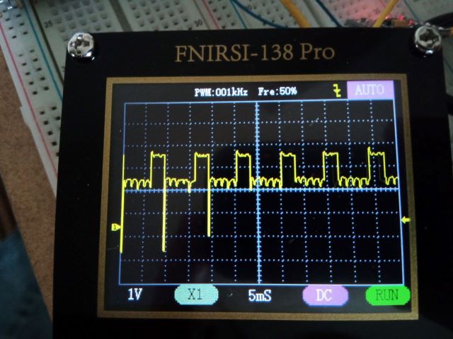

C) I can then use that to operate a servo and also supply an electromagnetic servo driver (as I havnt got a speed controller with a low enough switching frequency for the pulse width modulation). and I can show the modified signal. I can then feed that into a H drive motor drive module to operate a DC brushed motor.
D) I can then show the negative voltage spike when the switching occurs, and shows the voltage generated by the motor just after the motor has been switched off at part power
just waiting or a box to be delivered so I can shove it all in.
with your name on here, I would hope that you have a good knowledge of electronics, for someone who uses an oscilloscope once or twice a year it can put then in the rough area of what they are looking for.
