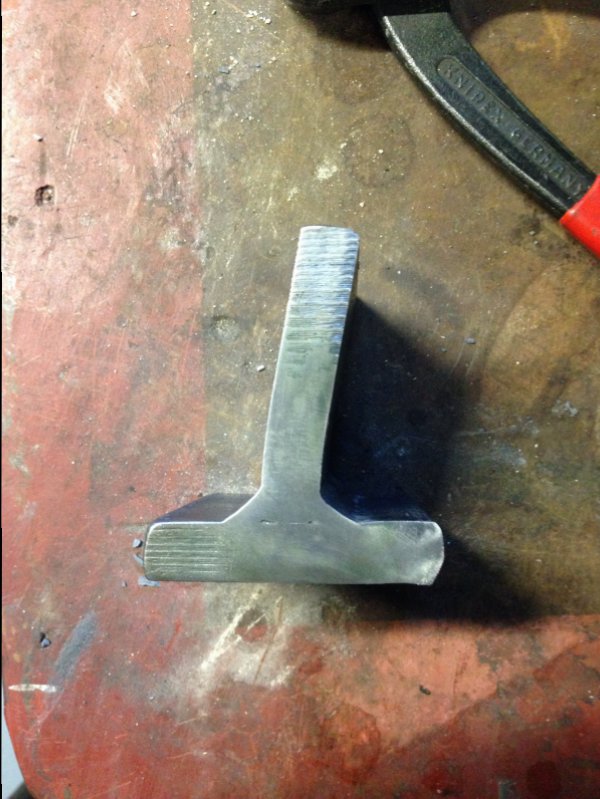

You got it. The 10mm will suck that heat away so quick you'll end up dropping a very cold slug in there. This is also the reason we pre heat thick section so that is slows down the cooling rate to avoid cold cracking. Pre heat won't aid with fusion/penetration much mind.So if you set a mig to get full penetration on a bit of 2mm plate, and then move over to some 10mm plate you won't get the same penetration (2mm)
Is this due to the large mass of the 10mm drawing heat out of the weld puddle?
There you go. Never knew that. Half a dozen lemons in the tool box is the key then.Very interesting read.
Citric acid works for weld etching too.
