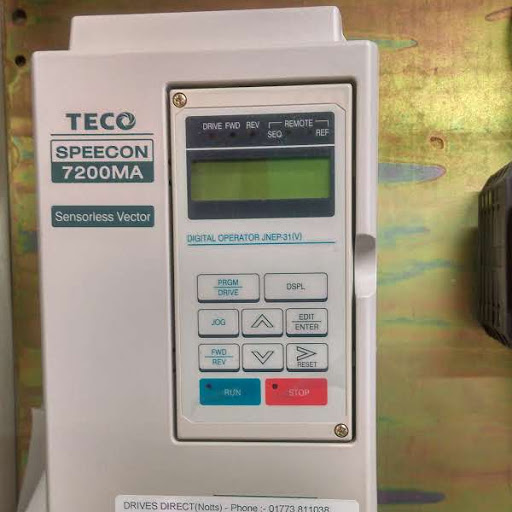

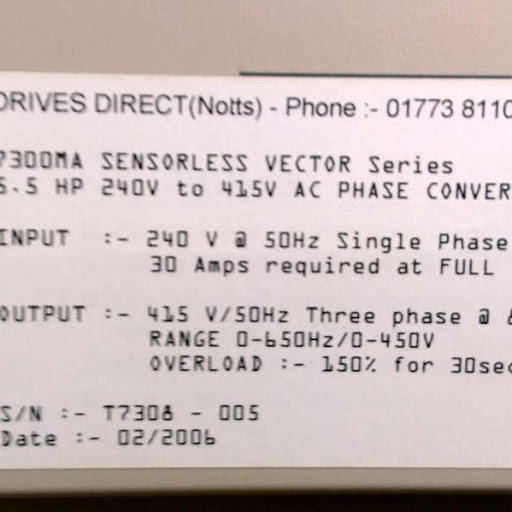

I don’t understand why you cant have a contactor in between the vfd and motor.
I dont intend to use the contctor to operrate the motor, just direct the vfd supply to the correct outlet.
Can anyone see a problem with that?
is it a back emf thing, with motors being inductive?
as I've said before, it's 30yrs+ since I did any electrickery theory, but that rings a bell?
