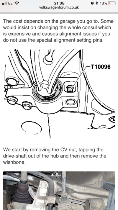

Same as our Skoda Fabia. Similar bolt seized and in the end simply bought a new alloy part. Dead easy to change.Never seen a full alloy one on a 9n2 polo,
(I may be wrong though but usually there)
A steel centre with a replaceable outer section each side
What’s the deal with changing the front bush?
