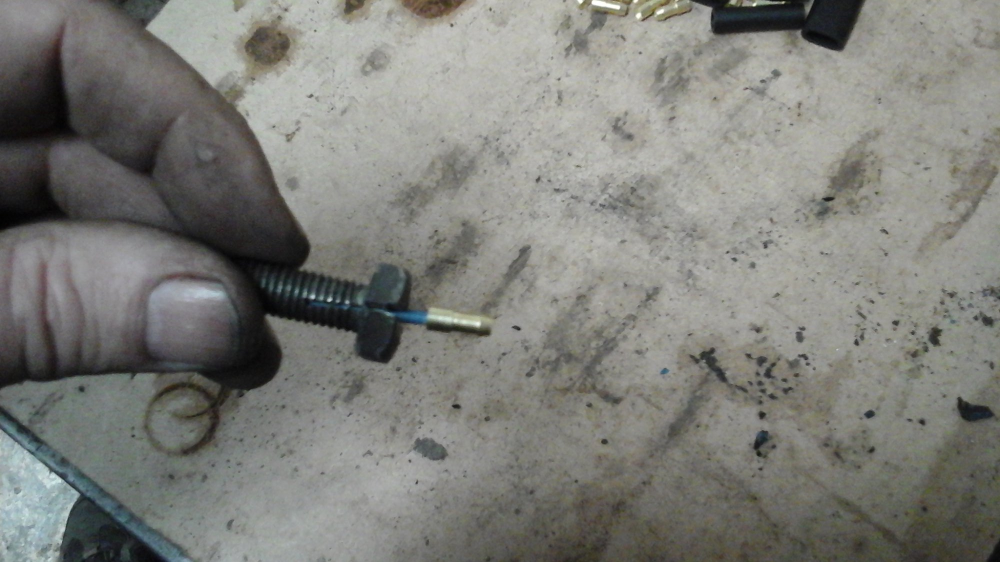

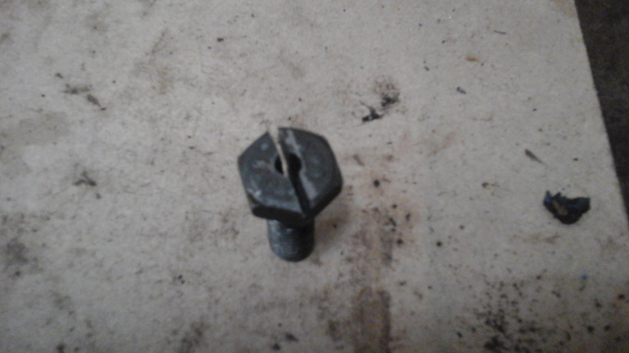

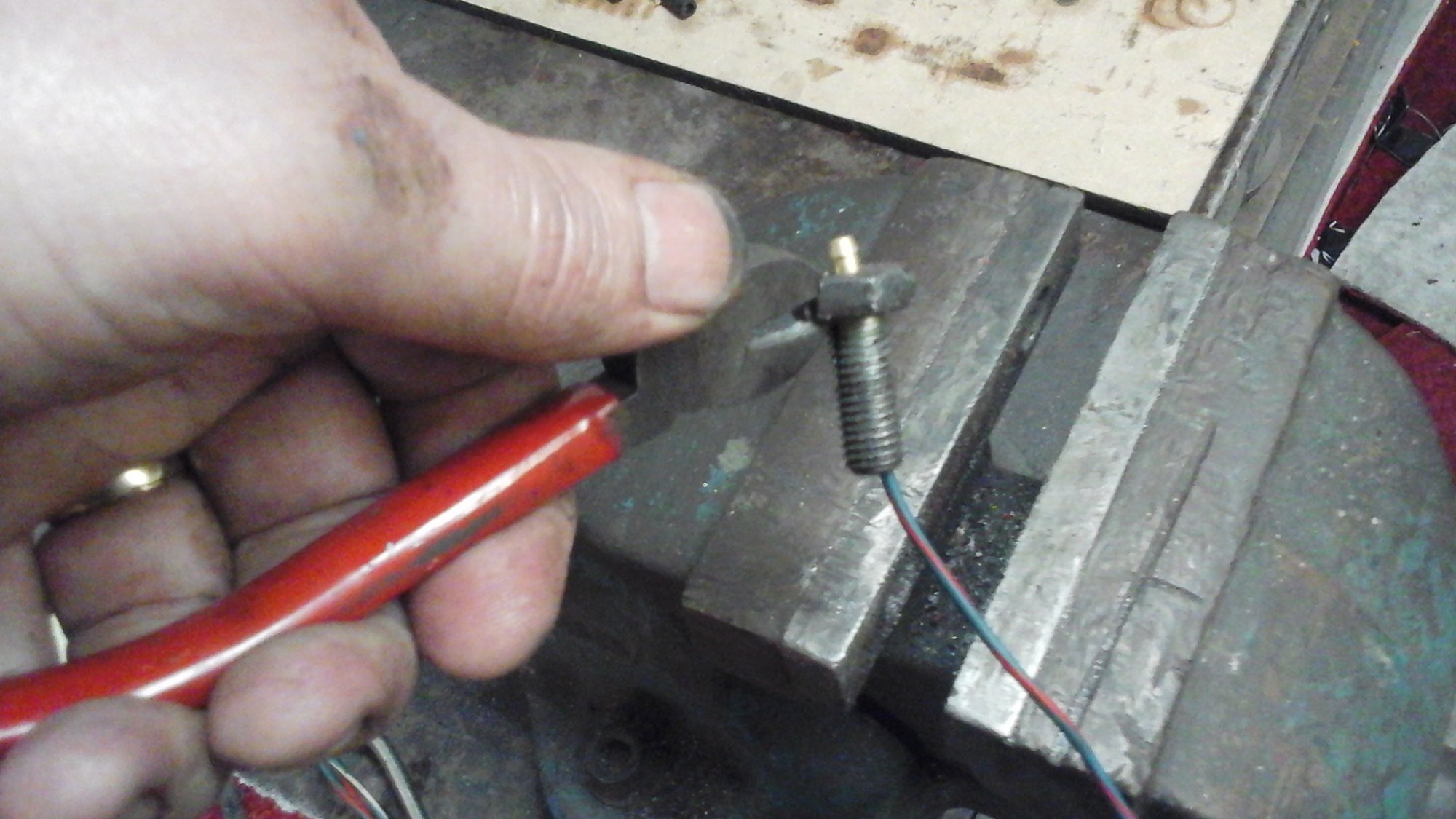

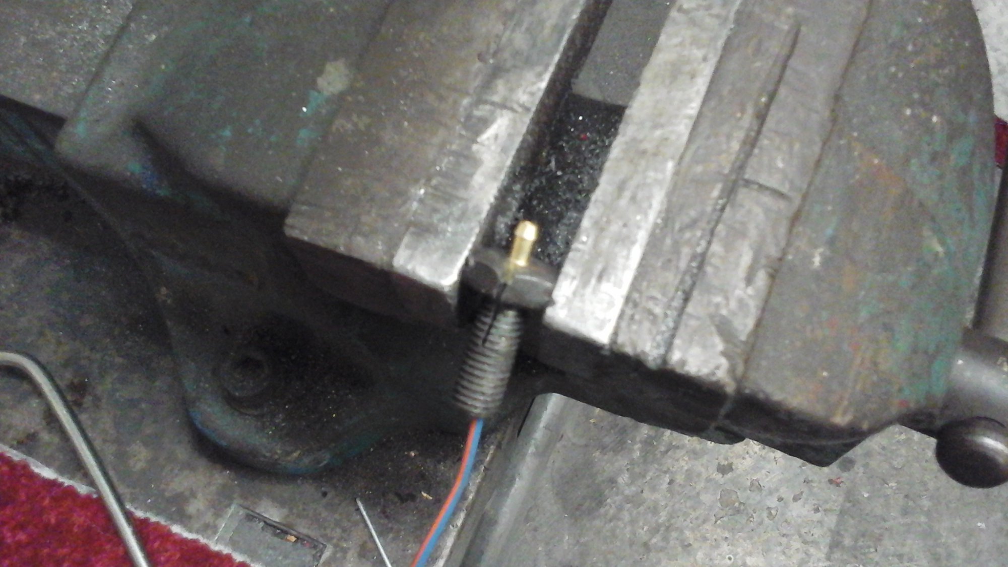

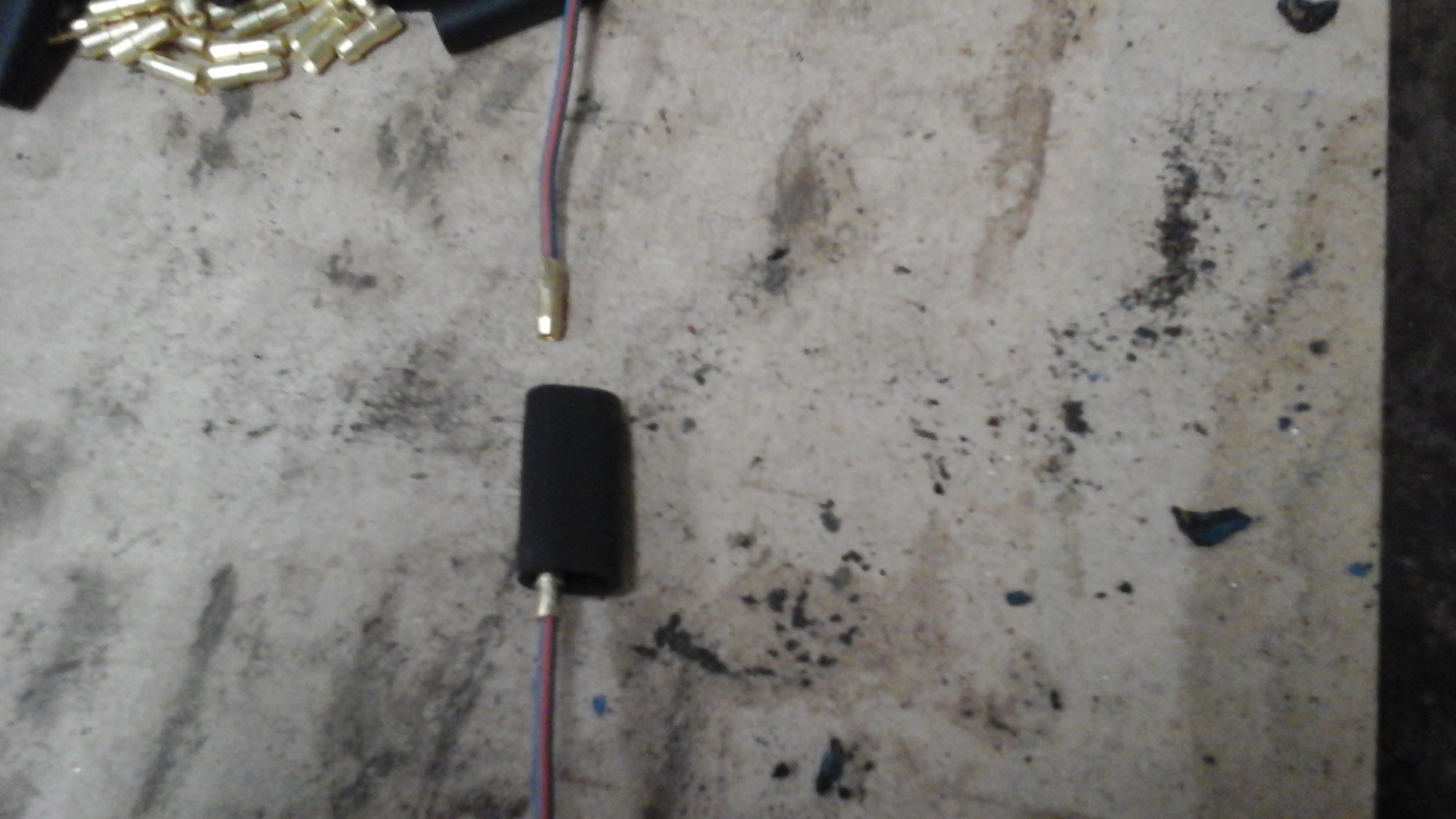

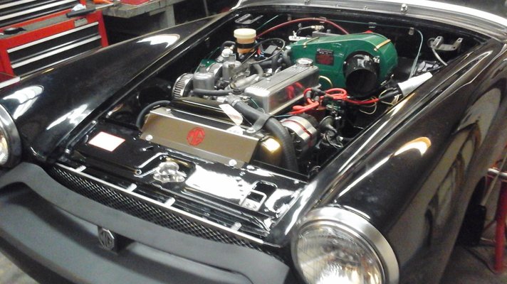

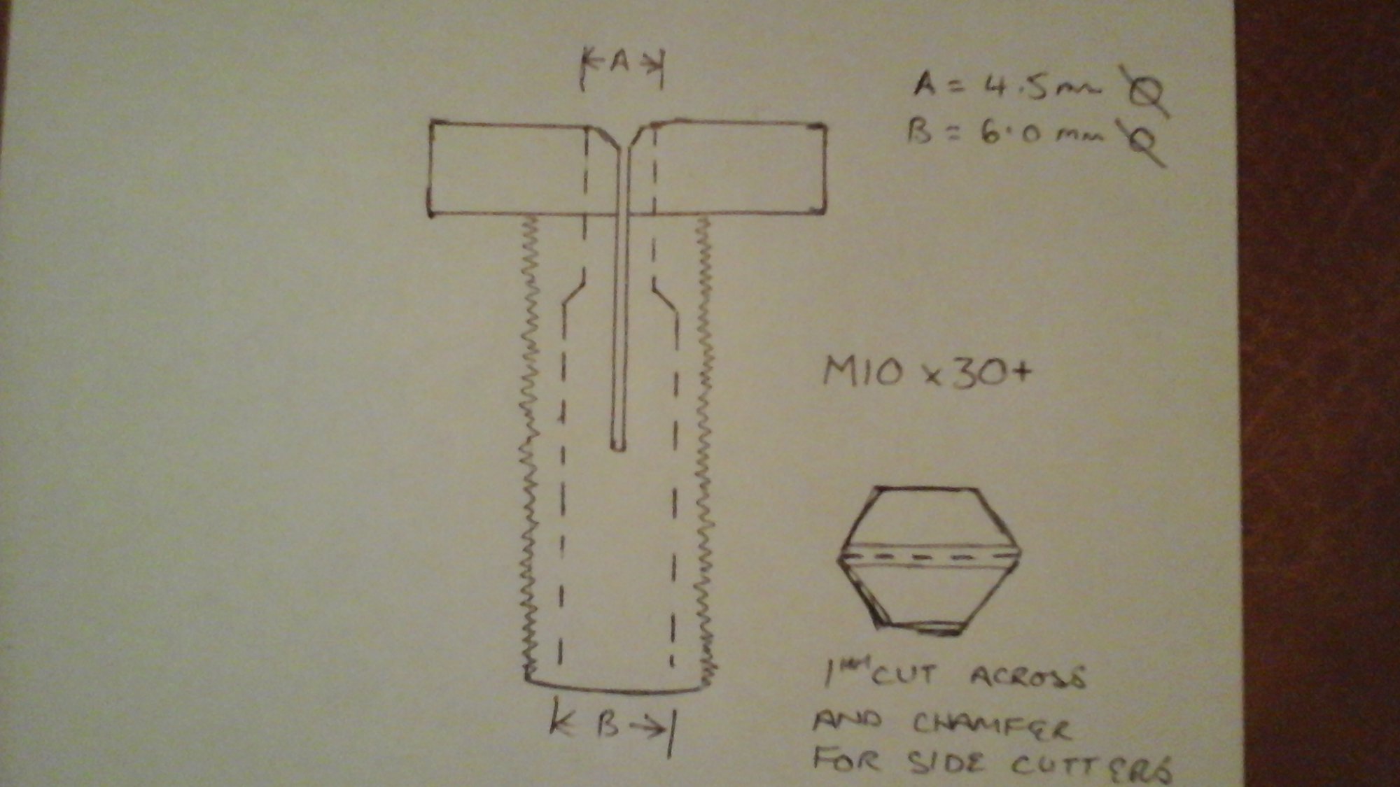

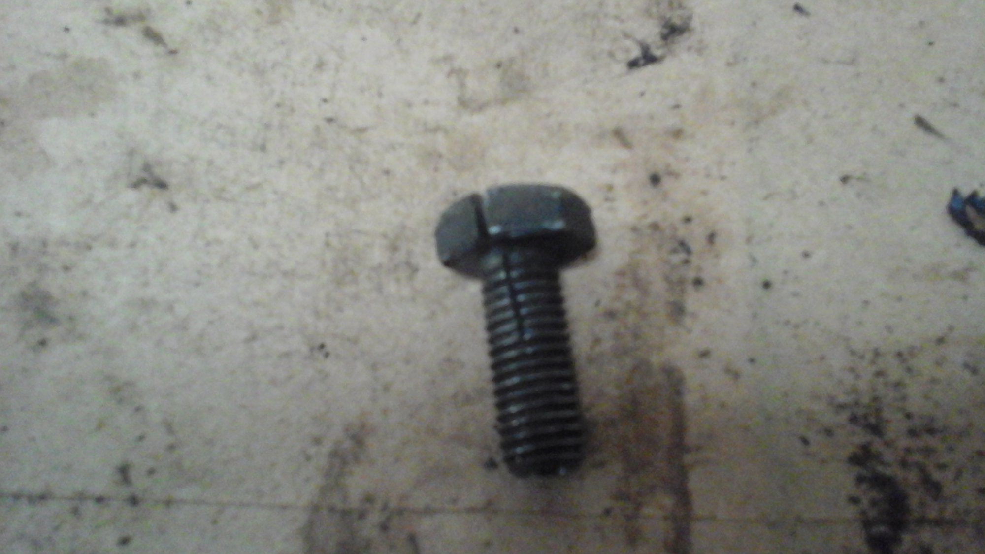

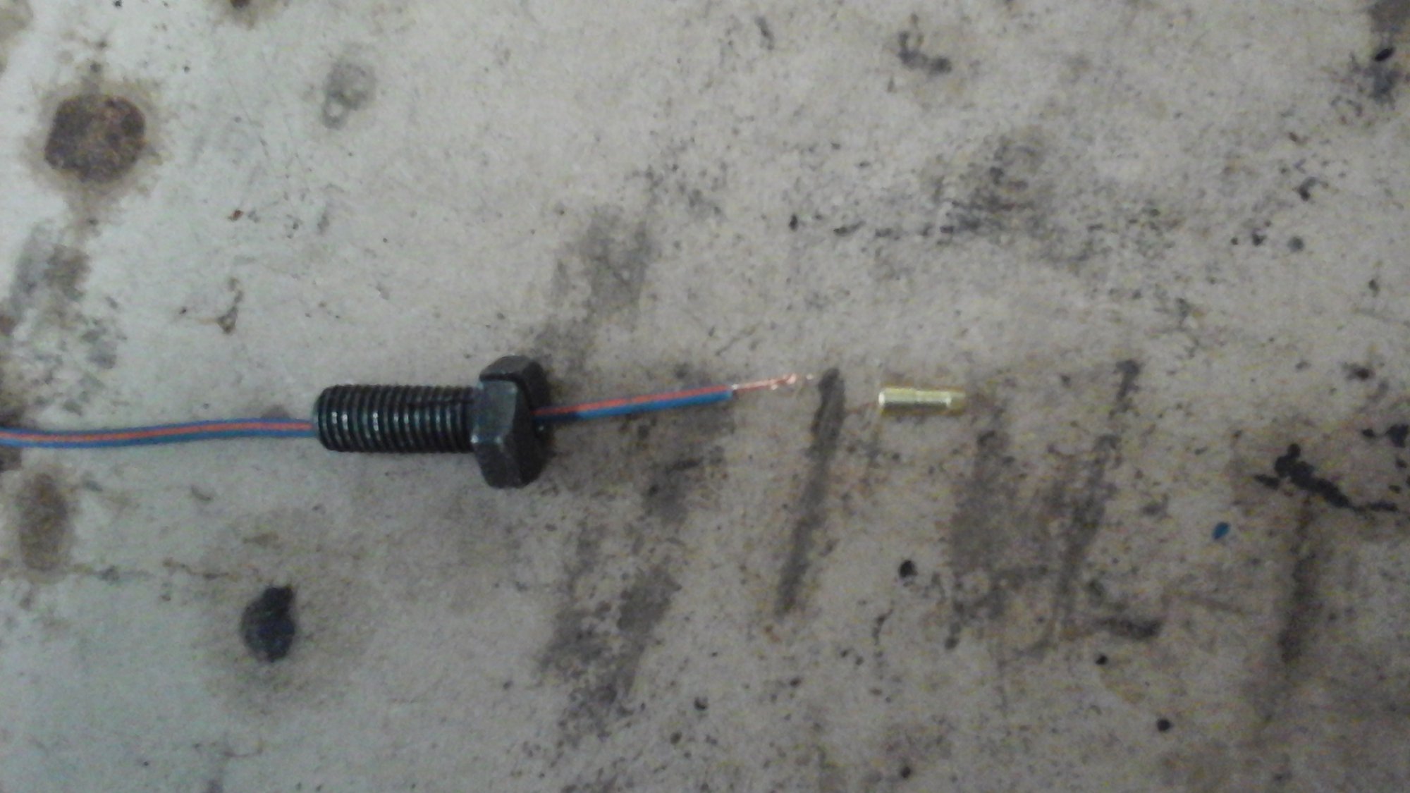

On this sad day, Thought I would share this little gem with you. Had to replace a few of the lucas bullets on the Midge. The bullets are made of brass and the decent tool is not cheap. Here's a tool I made a while ago from a 40mm M10 screw.

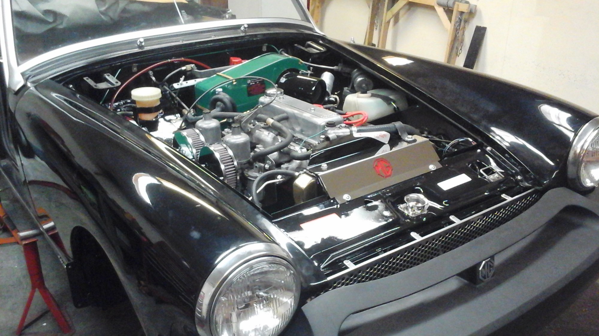

car is looking cracking!
