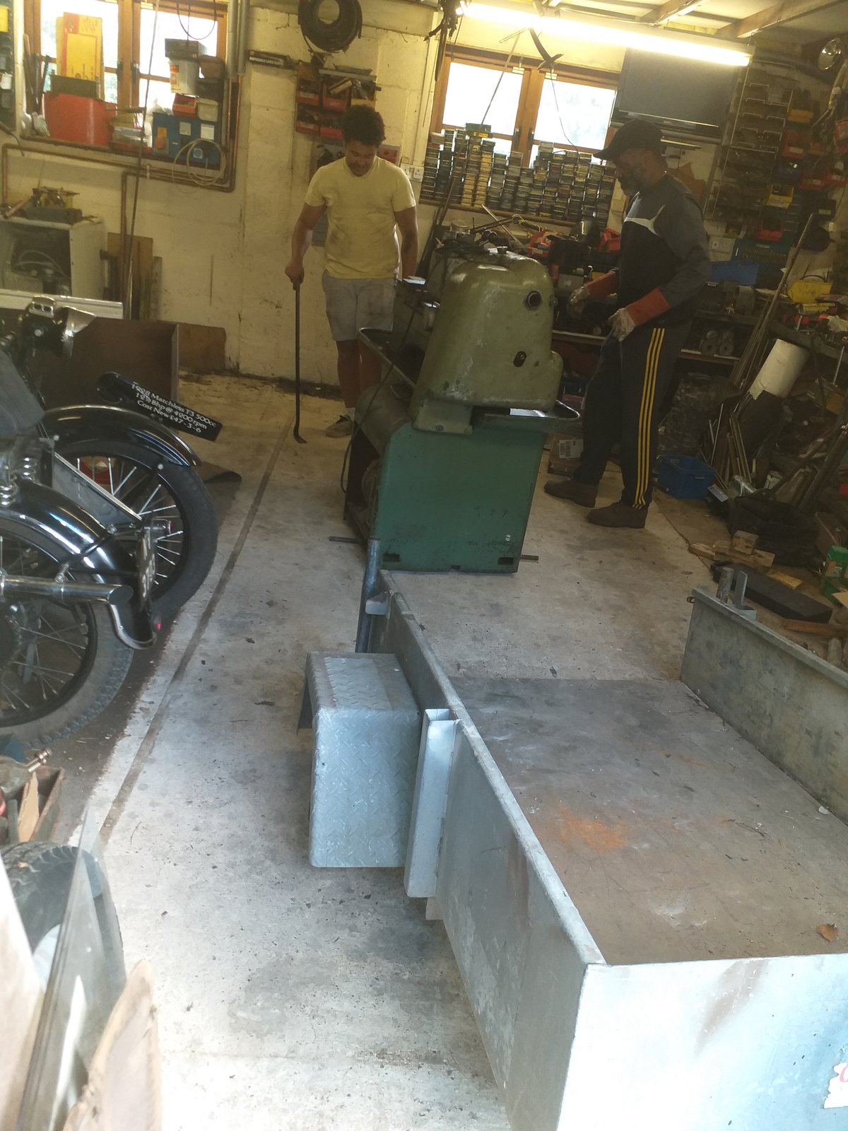

You're right they are bloody heavy. 2-man lift to pick up the bed alone. The bare cabinet I could just load into my van for shot blasting.

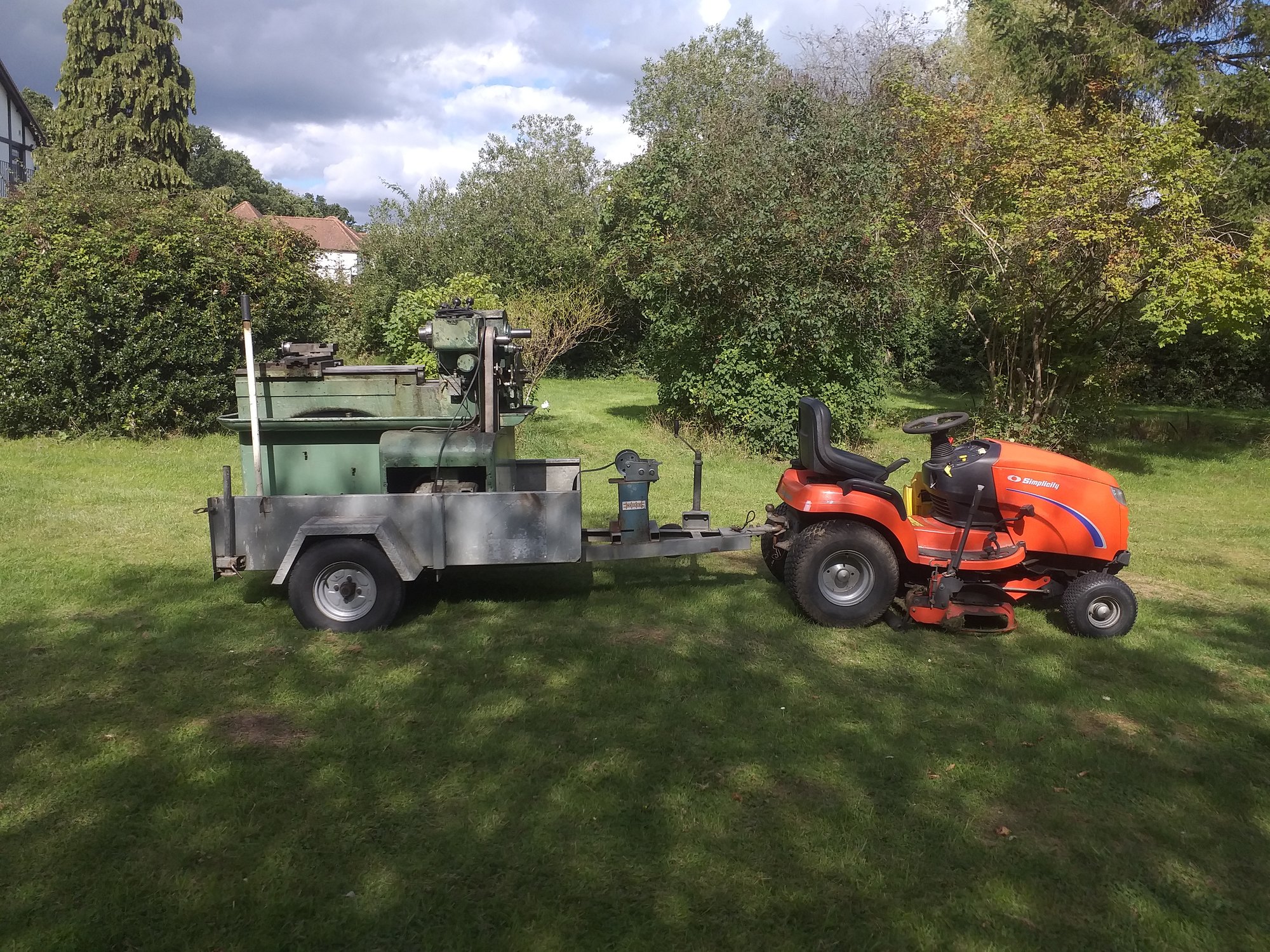

I collected mine on a trailer and used a tirfor to pull it up the ramp.
