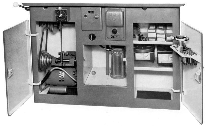

Even easier solution.That lever is supposed to be just under the tray on the left side of the stand
Please could you expand your comment and discuss whether locating the lever in the same place on his machine would be a possiblity or point out any pitfalls should he choose such a direction.
The lever was on the left hand side of the cabinet on the MKI.That lever is supposed to be just under the tray on the left side of the stand
huh that is a good place for it, I wonder if there is rood up there on my model as it has the extra gear box ect for screw cutting and power feed.That lever is supposed to be just under the tray on the left side of the stand
maybe I think it will be difficult to retro fit it up under the tray now thoughEven easier solution.![]()

If you want to fit original parts tgen you need to dismount the lathe from the cabinet.huh that is a good place for it, I wonder if there is rood up there on my model as it has the extra gear box ect for screw cutting and power feed.
Yes removing the lathe from the cabinet is not going to happen.If you want to fit original parts tgen you need to dismount the lathe from the cabinet.
That's why my MKI still has the lever in place, even though I changed to the later tensioner.
