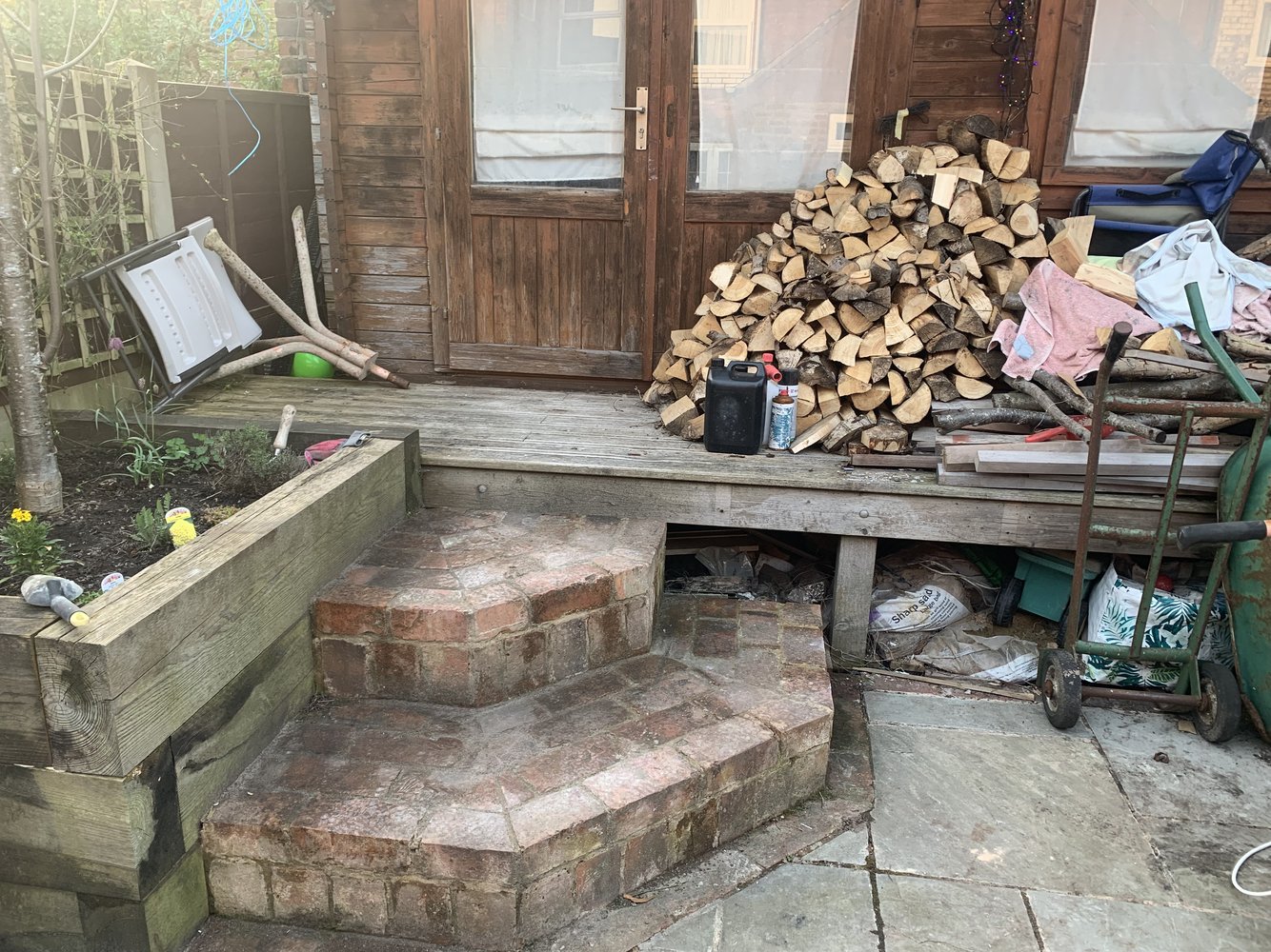

As @brightspark said, make sure you chock / support the planks, go straight over those steps, lots of wooden block / concrete blocks.Thanks for all your suggestions,feeling a bit more confident that it’s doable now. Just took a pic to show the workshop steps
i wouldnt trust that decking and certainly not with all that junk rotting its frame workThanks for all your suggestions,feeling a bit more confident that it’s doable now. Just took a pic to show the workshop steps
Fair point.i wouldnt trust that decking and certainly not with all that junk rotting its frame work
you would have to pack over the doorstep and have another pieve over the doorway
so thats 3 high steps to get over id make frame work of 6x2s on end and strongly built it can be done in 4x2s as long as you pack under them at every 2ft
2x 4x2s screwed together and packed underneath by a 4x2 packed under it as your loading it per leg
