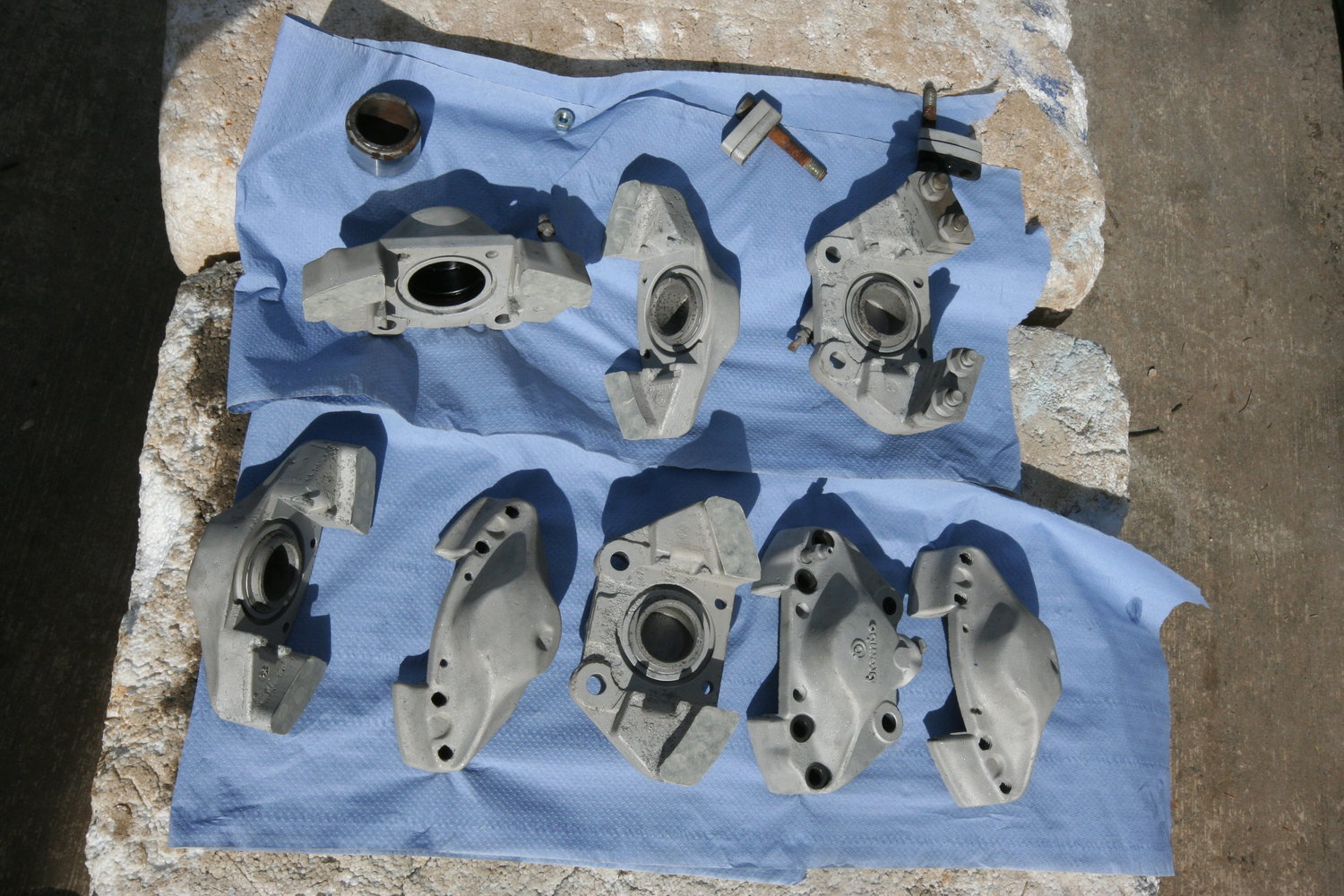

When you clean the bodies also clean out the seal grooves.
This, the groove shape is one of the most important bits of caliper design, and the differences are all in the tapers and small radii - make sure it's spotless.

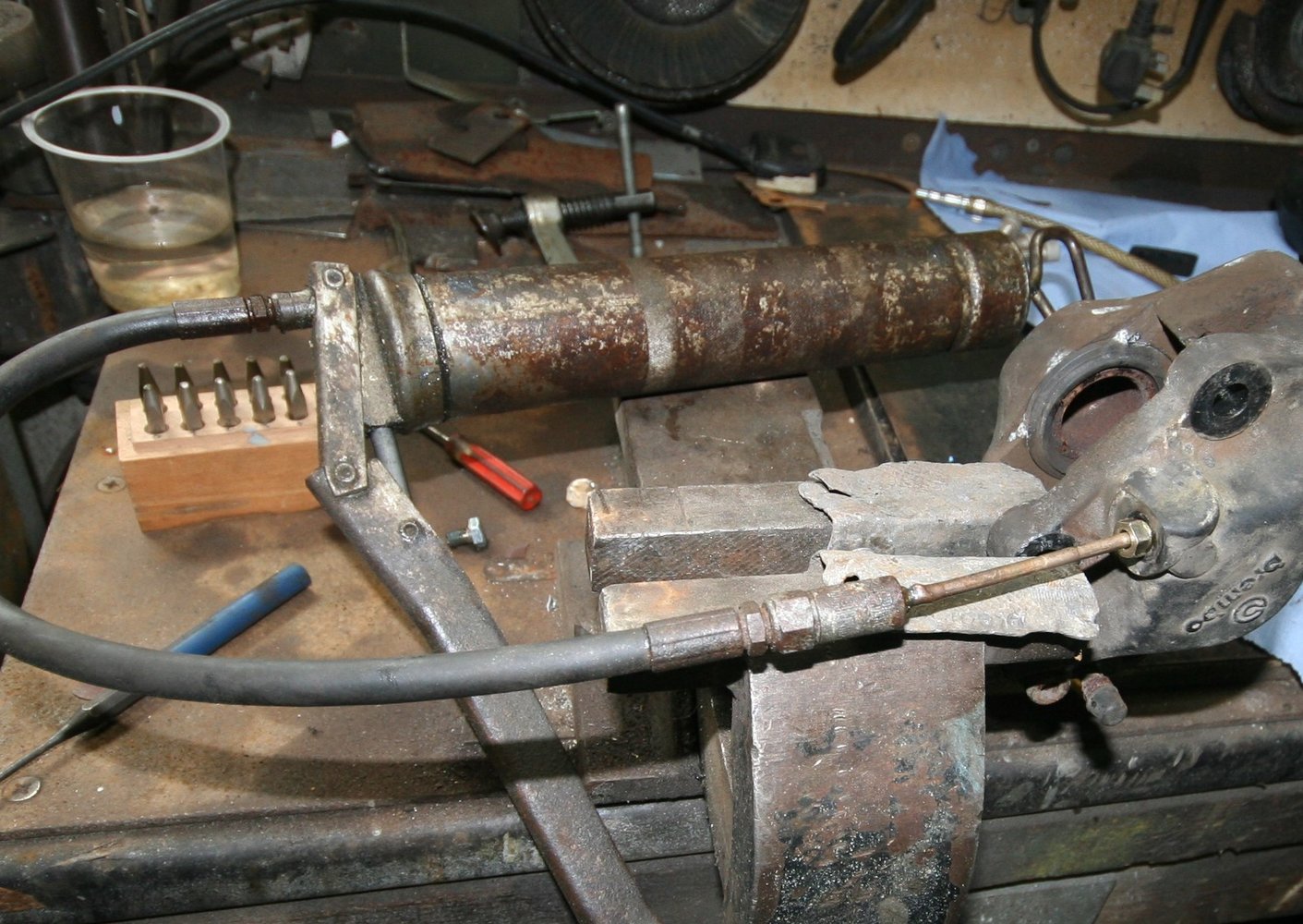

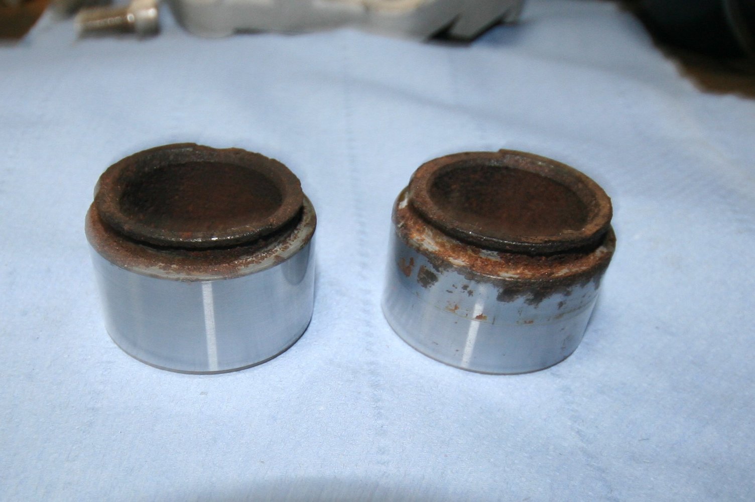

. Why do some pistons just push in first time, but others just don't want to know?
