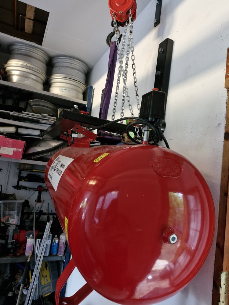

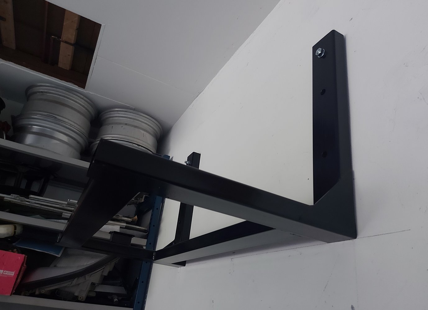

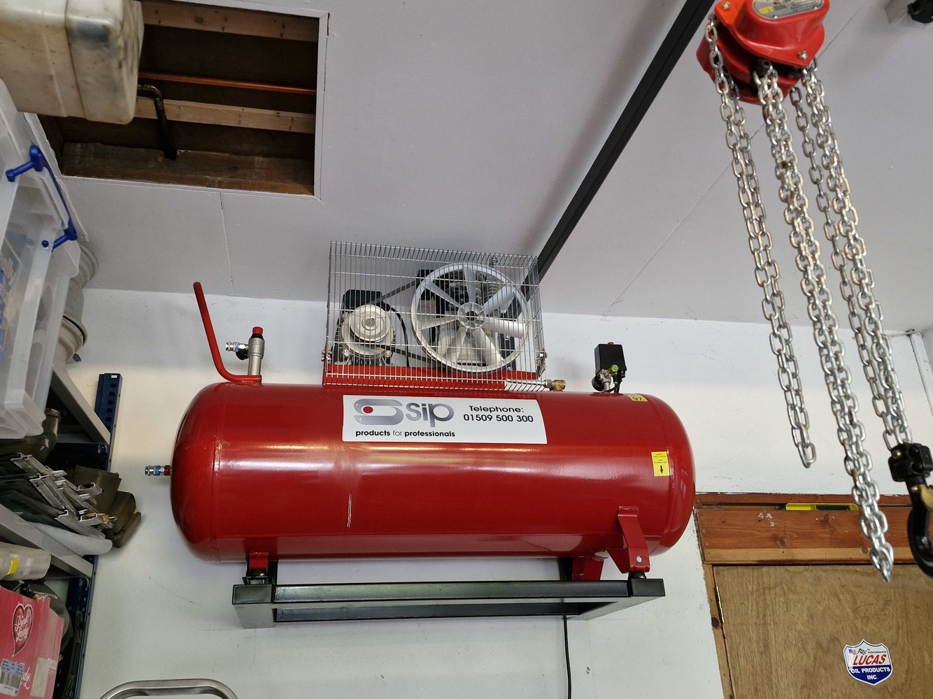

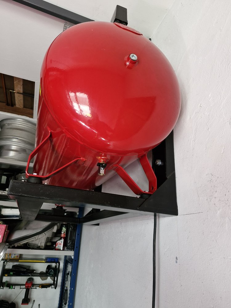

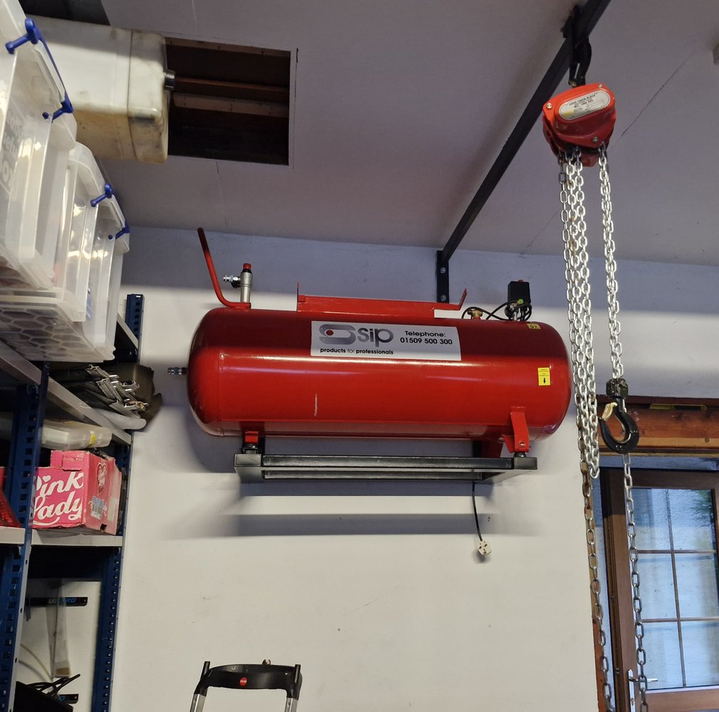

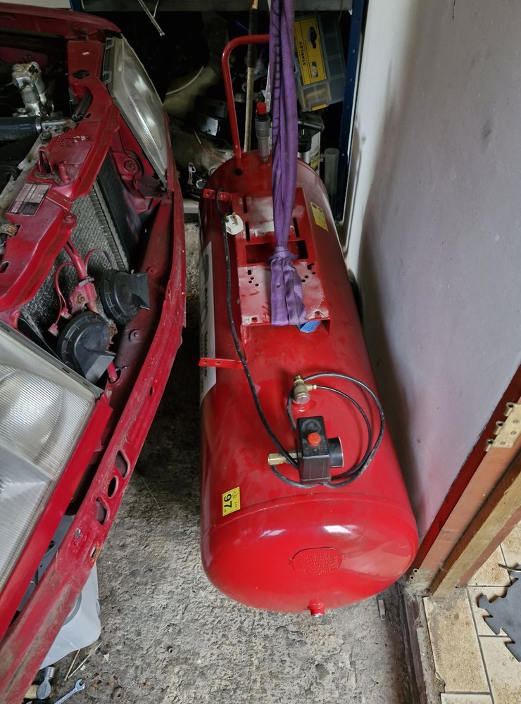

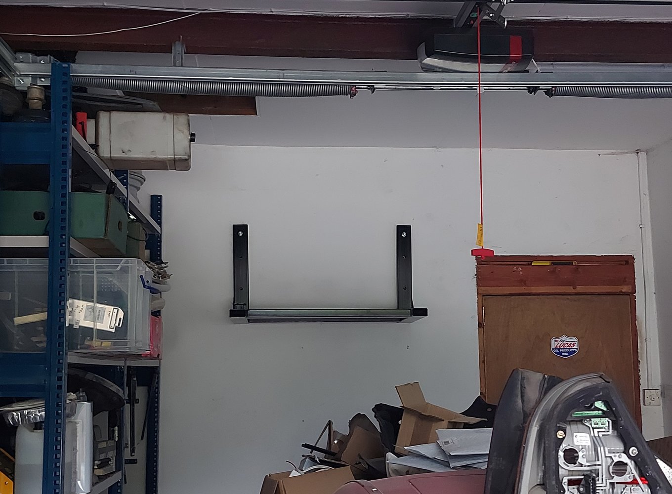

I got the frame painted this morning and hung on the wall

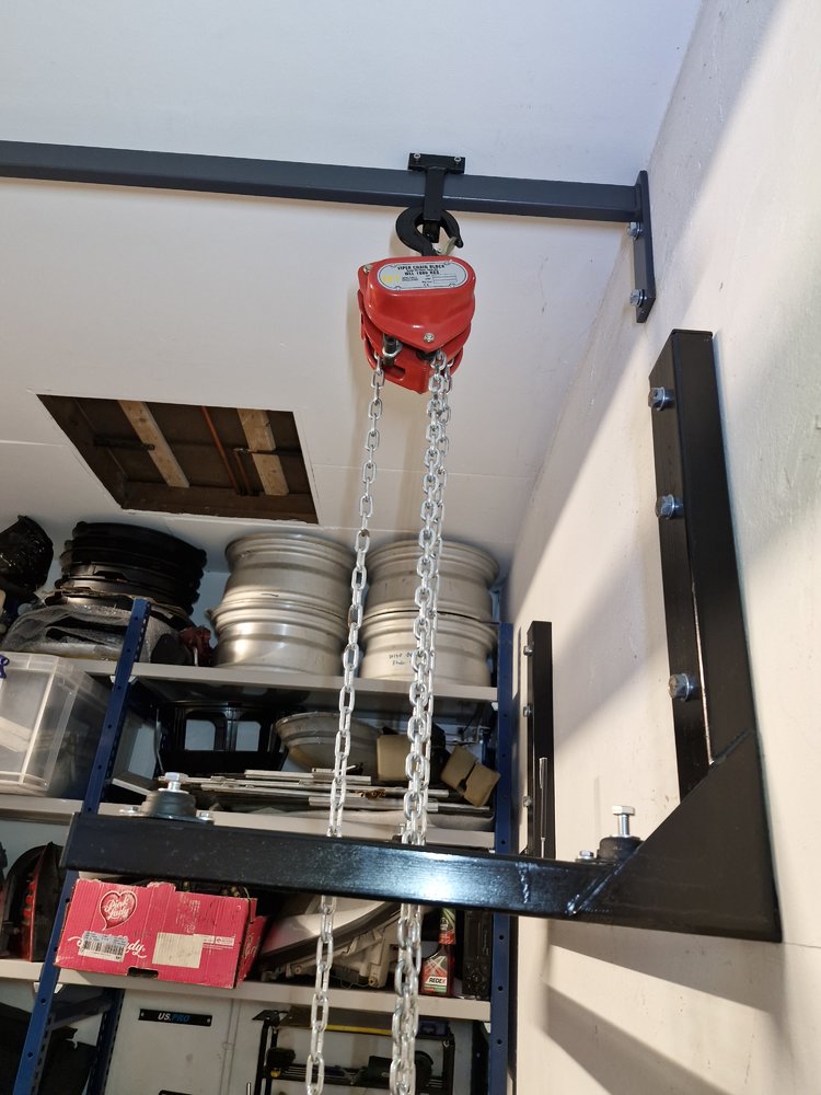

I then went ahead and set the other 4no m12 bolts in resin. I set them in last to ensure the frame didn't get hung up on them.
Tomorrow evening I will tighten the bolts, cut off any excess thread and tack weld the nuts on so they don't vibrate loose in future which would be a bit of a disaster!
I am 6ft2 and can walk around the front of the car with 2 inches clearance. Works out well.

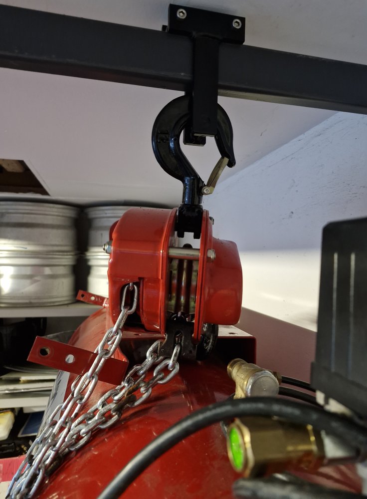

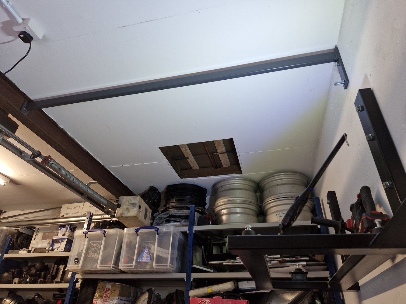

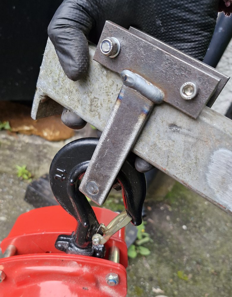

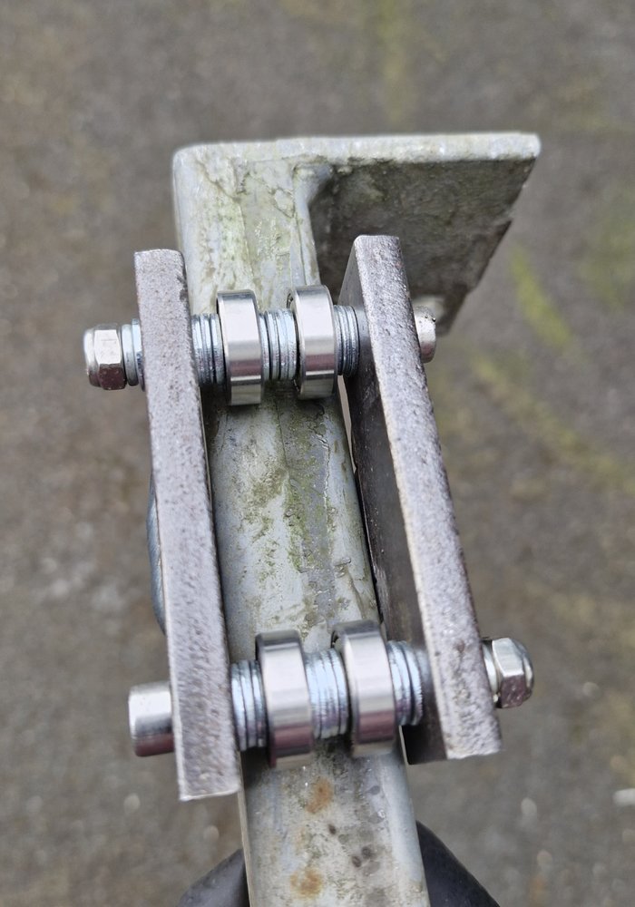

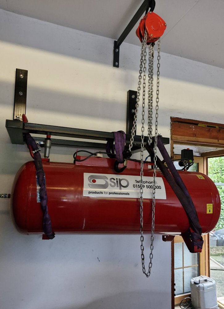

Next challenge is making a lifting beam to go above this for securing a chain block to for installing the compressor in its final home.
