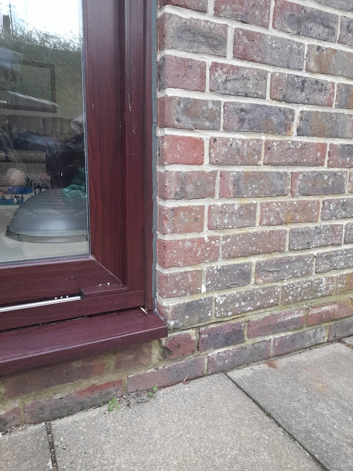

yours looks bottom and being sucked up by the plasterboard
youve siliconed the outside but you havent done the bottom sill
like welder pauls you dont have a silicone down the d bead either water can still get behind there as only superglued onto the frame in dash and dabs
water is then tracking backwards on top of the dampcoarse
if you siliconed in winter you will have to wait till summer when its the drier time to find out if cured but any wet times it will show at high speed with mold
