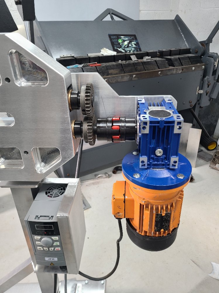

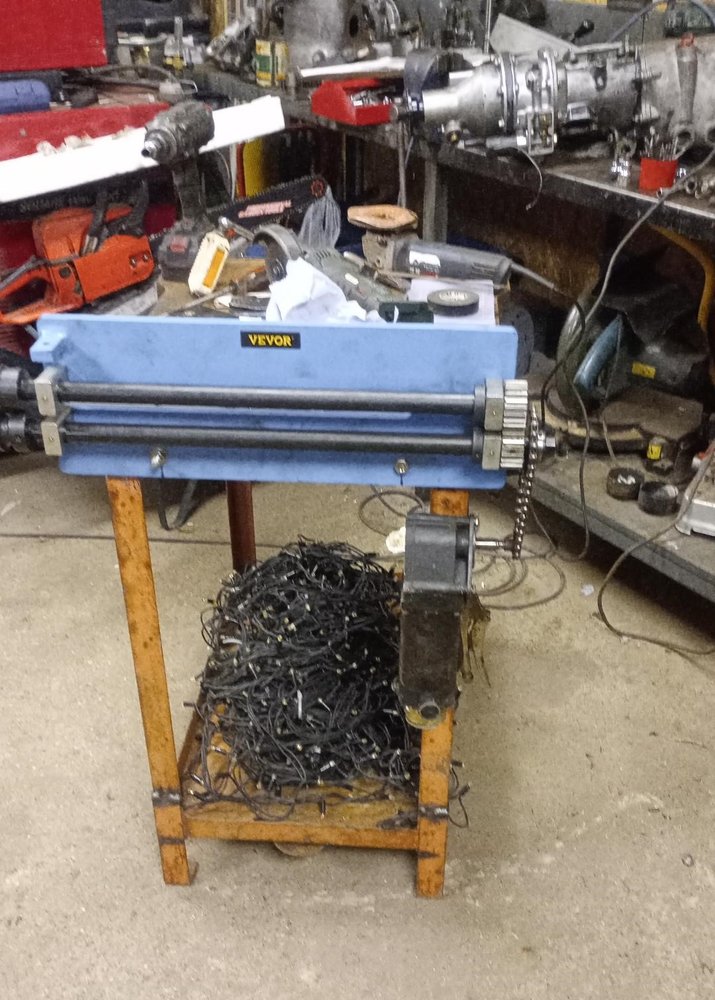

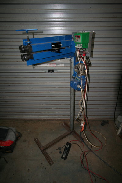

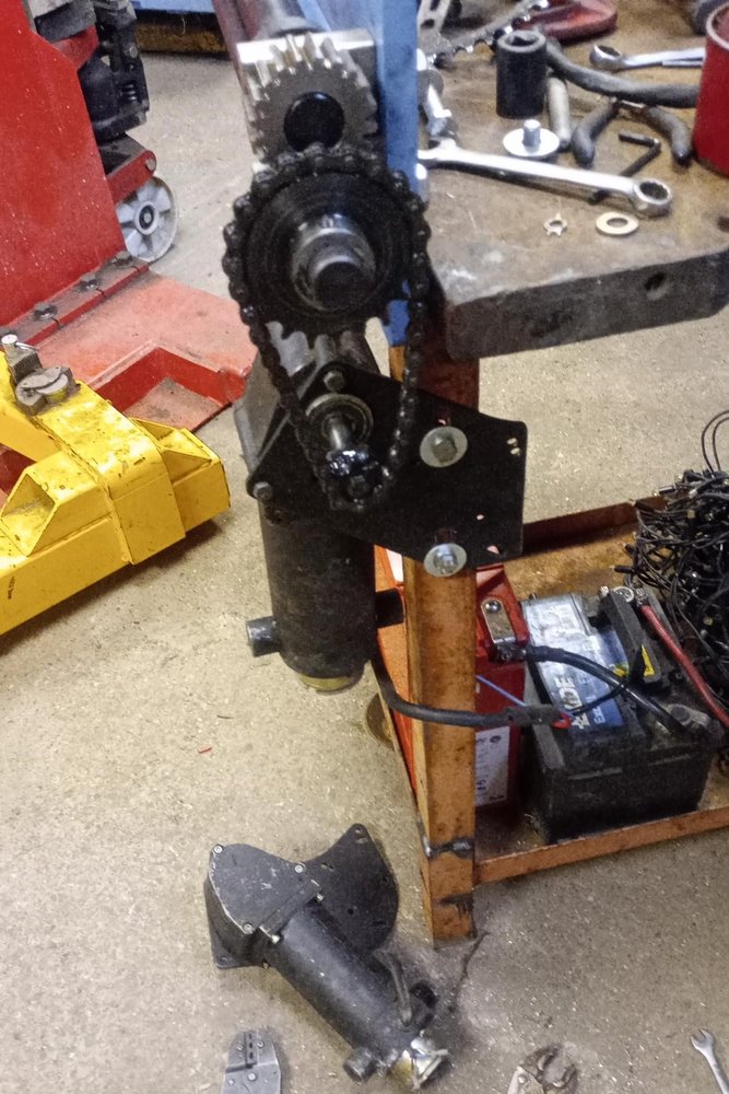

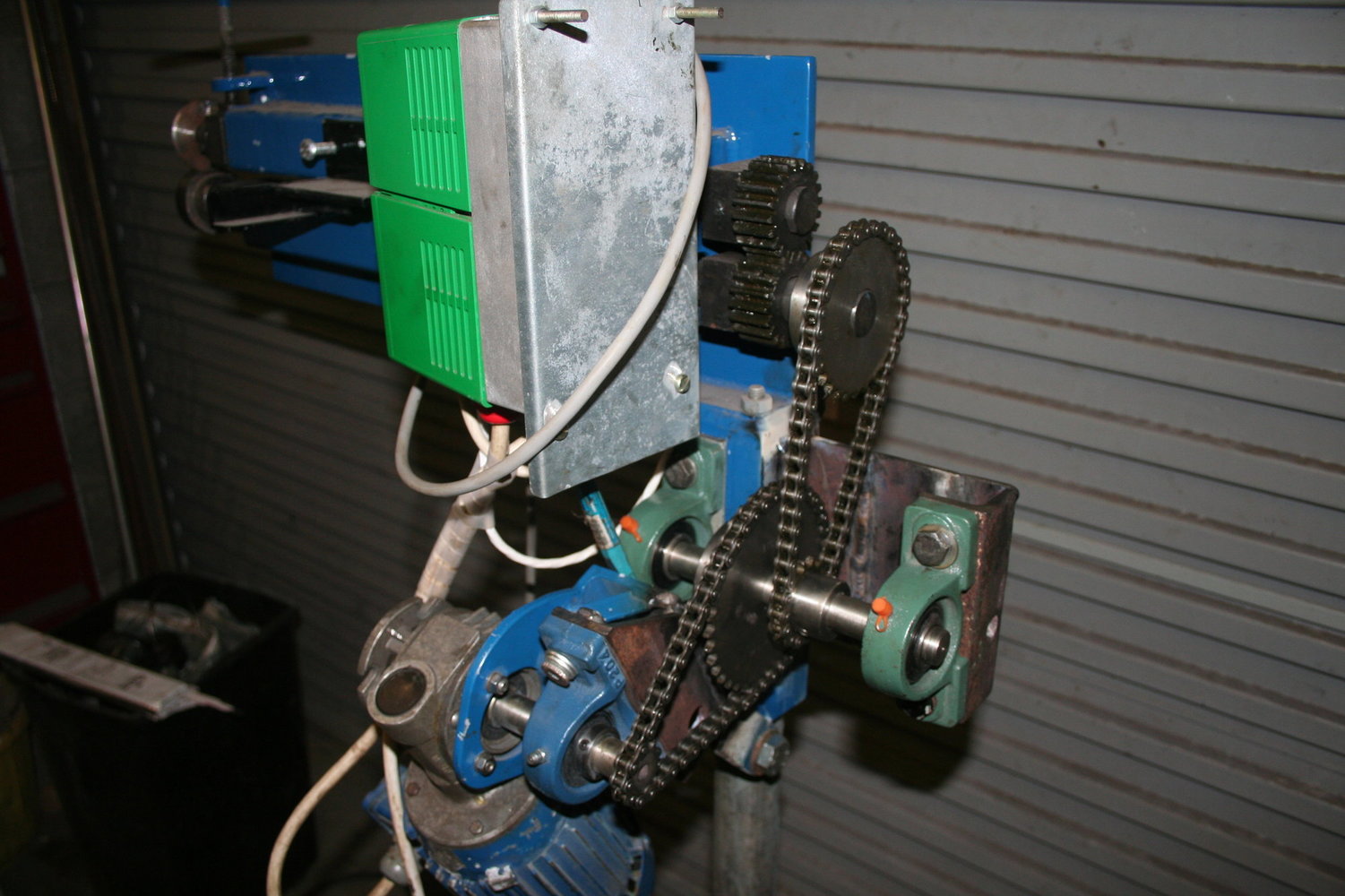

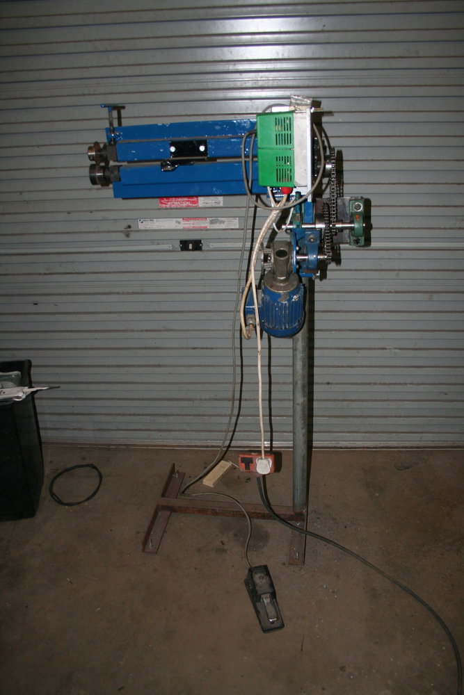

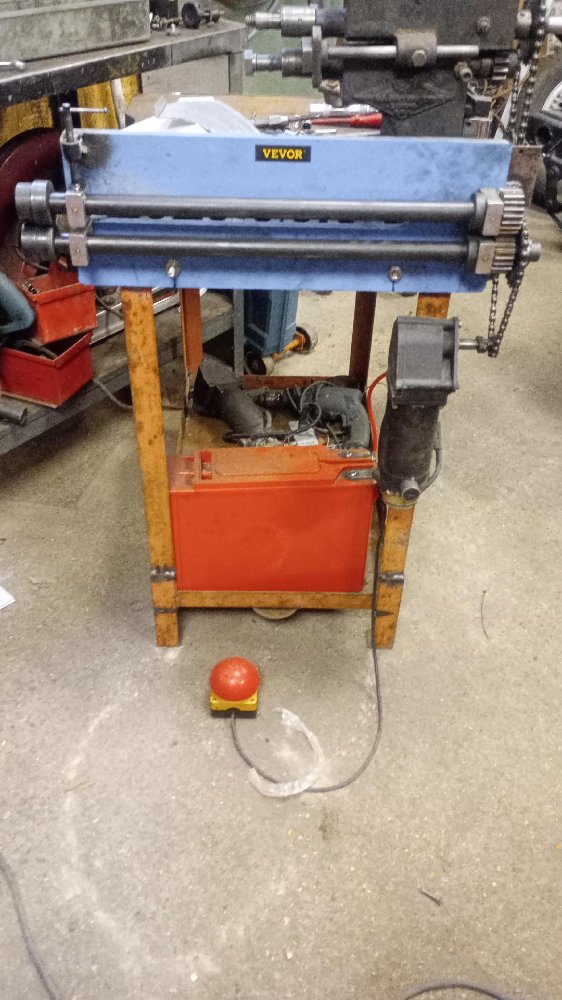

I did have mine all set up with variable psu, two foot switches (one for forward and one for reverse)can't find any pics though !
If I recall the power draw under load was less than 8 amps.
Note again if I recall the speed at the bead rollers was , 5 rpm.
