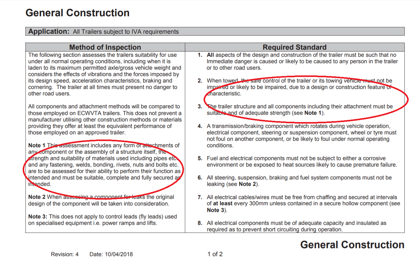

Hi Peeps.
Has anyone gone down the route of getting their own trailer build type approved for use ?
I want to build a bespoke Bike Trailer for my Business and don't want to end up finding out I've wasted my time as it will need to added as a specific item to my Business ins just in case of an Accident with a potentially expensive Motorcycle on board.
