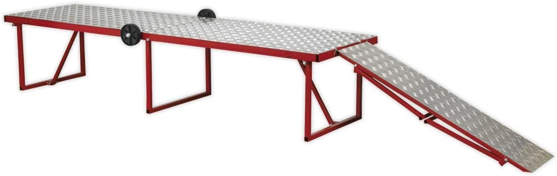

I'm considering making my own m/table a bit like the one in the picture below.
not sure what materials I should use.
length of the table will be 2 metres x 400mm wd x 350 height, ramp about 1400mm.
thought of using 25x25mm x 3mm angle iron and 25mm plywood for the top.
another alternative is..
50x25mm x 2mm thick box section main frame.
225x25 3mm box section.
what would you guys suggest? bare in mind I want it to be light as possible and not expensive to mak as I will only use it a couple times a year to service my bikes.
