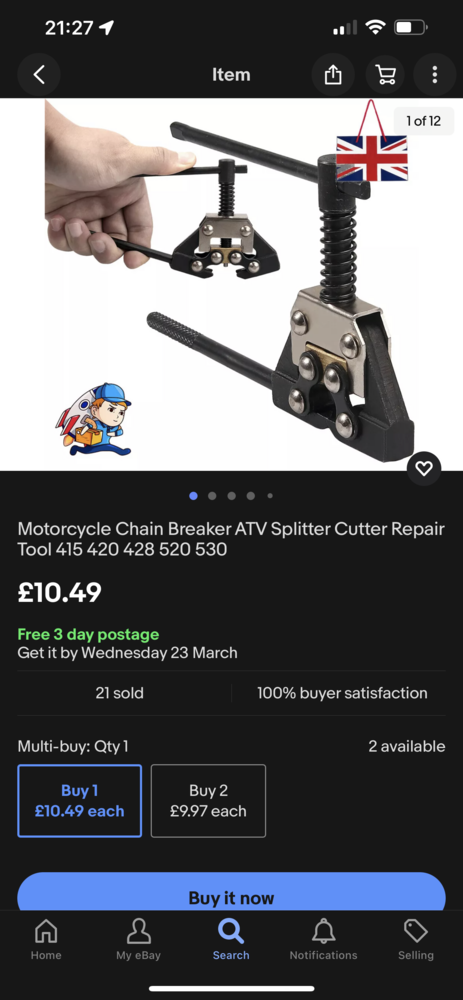

Thats a wiper arm removal toolI have one of these I think. I thought it would be crap but I do my Dirtbike chains with it. It’s so simple and so effective. I wouldn’t waste my time with a punch after getting this. Would highly recommend to be honest.

I was hoping to borrow one from a mate today but the selfish fella is away for the weekend, how dare he!
Will use the grinder today as I have done in the past just wanted a tool for the box as if I’m at a race circuit/enduro it can be a pain to source power

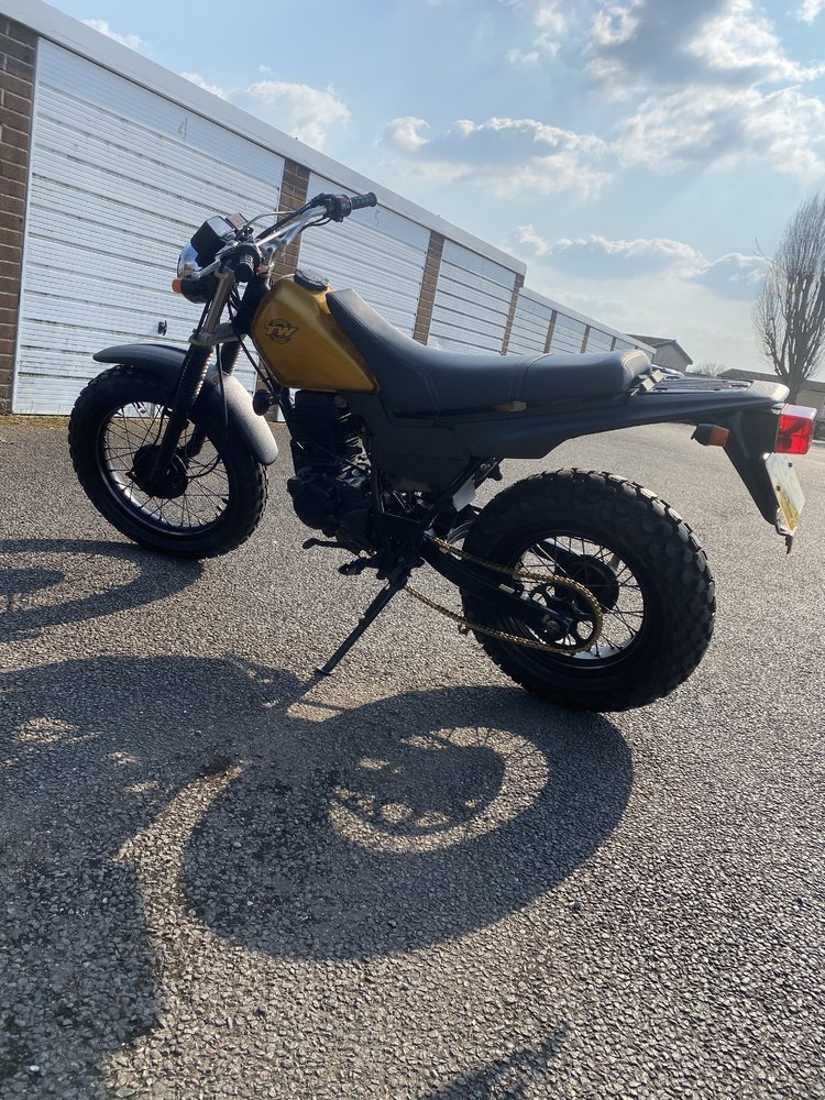

I took a quick pic before I used my paddock stand to lift the bike up as I didn’t want the dust in my garage(from the grinder)
The gold chain is a nice match for the tank paint work plus it adds 5bhp in cool factor
look a bit slack there manAs soon as i left a post i kinda new it was a "stage shot"Was just a quick snap before I adjusted it fully
the adjusters have been fitted properly now as the wheel was as far forward as possible to save scratching the freshly painted swing arm
