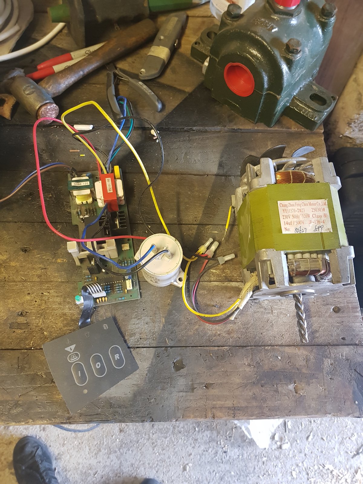

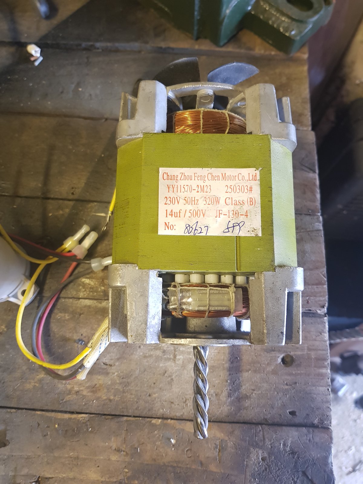

It came from a big paper shredder, i kept at associated circuit board to power/control it but in the interest of making some space I'd to get rid of it and keep just the motor, so how do I wire it?
There's 15 ohms between the red and black wire, 15 between between red and yellow and 30 between black and yellow, as if there's two matching coils in series.
