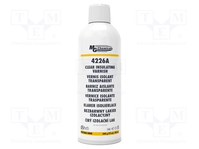

Ordered a tin from eBay tonight, but then shortly after, I found this stuff.
Sold at Farnell - https://uk.farnell.com/mg-chemicals/4226a-340g/insulating-varnish-aerosol-clr/dp/4262337
It is good for up to 160 degrees Celsius vs the Ambersil 60 degrees Celsius.
The link @Agroshield provided said "insulation temperature ratings are denoted as Class: A = 105°C, B = 130°C, F = 155°C, and H = 180°C."
The motor I am attempting to rewire is a Chinese motor (it will probably get much hotter than the old school British manufactured motors), and it is rated to class F.
Wish I bought the 4226A instead of the tinned varnish now
