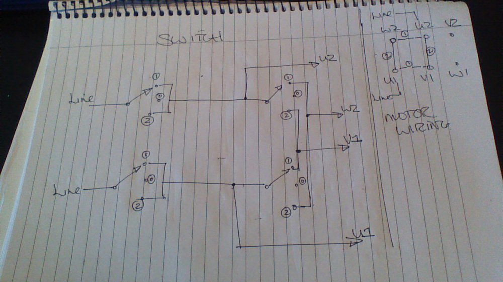

I have a single phase 240v motor that I want to wire a forward/off/reverse switch to.
The switch has 4 poles, 3 positions ("1" "0" "2").
I've drawn the beautiful schematic attached to show how I think it should be wired. The wiring for the motor is shown on the RHS (copied off the inside cover of the motor.)
Ground wires connected, but not shown.
Look ok?
