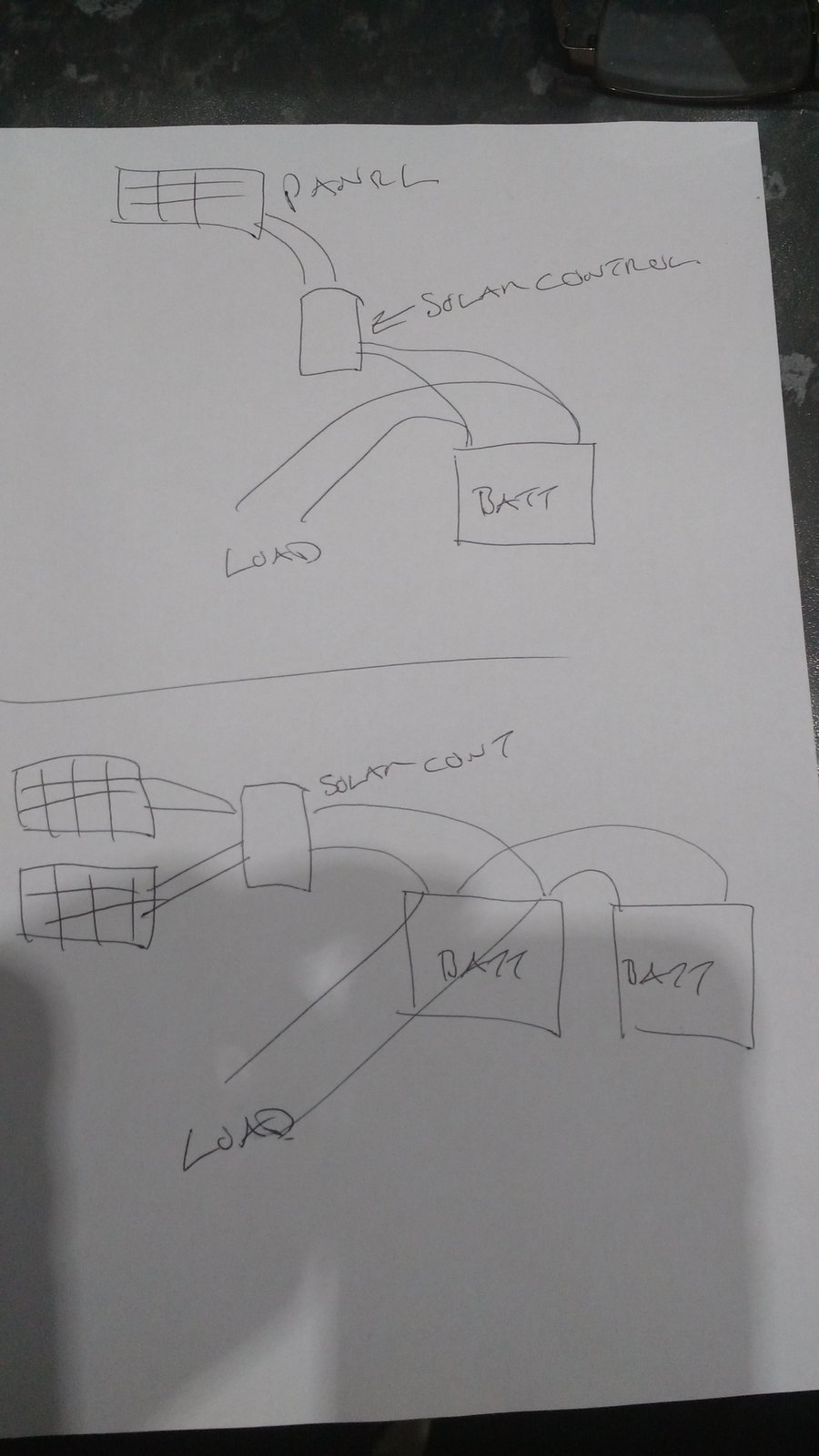

ODD claims ? you obviously did not read my post correctly who meansioned 45 deg ? just skipping the words because you already know the answer ?and then making odd claims to back up what you're saying - (45 or 50'C battery, 0.5v drop at battery connections etc. etc.)
if you take the time to read the battery university explanation of how a battery should be charged temperature makes a big difference.Batteries in one engine bay can be at vastly different temperatures, for instance the front battery could poss be at minus degrees whilst the rear battery could be at 40/50 degrees receiving heat off exhaust manifolds etc even those under a seat with a heater blowing on it it could reach much higher temp than the rear most one.
in Ideal conditions and perfect connection state two batteries or more can live together with the correct charging criteria, I do agree, that is not disputed, but in the real world in normal vehicle conditions they are rarely ideal and vast (in battery terms) differences in voltages are unfortunately unavoidable, due to cable length, terminal cleanliness relay contacts etc etc.
That is just it No they dont.alternator voltage gives them a good/full/equalizing charge
I have posted this before but you obviously ignored it or think you know better than the experts most old style alternators only charge to around 70/80 % of charge because the voltage actually doesnt alter enough to properly charge the battery
