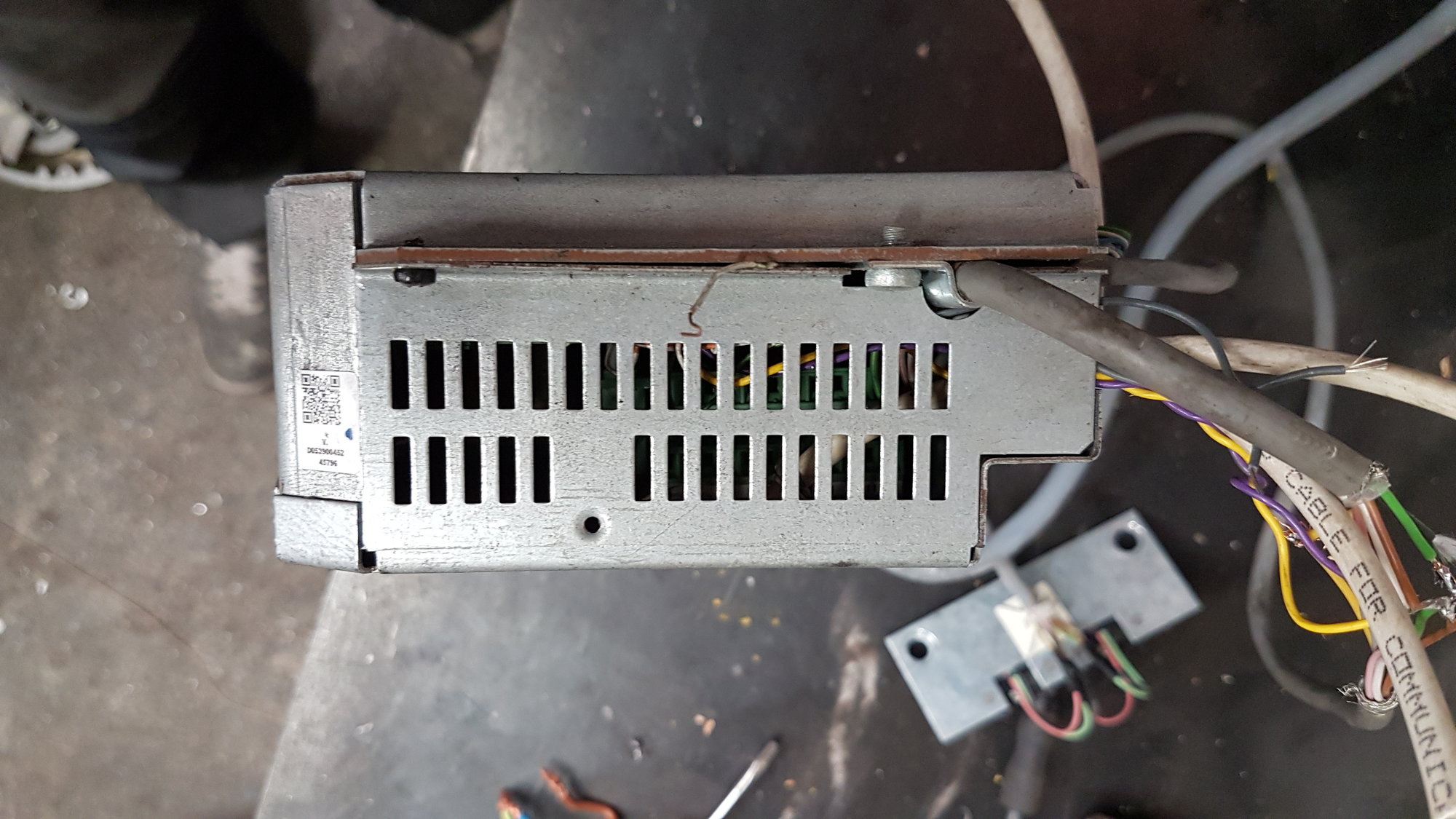

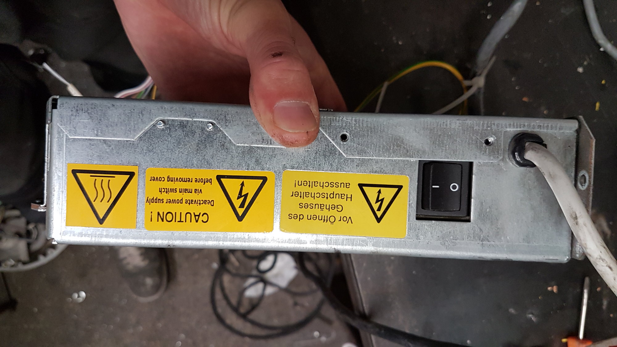

Actually I think that 3-wire tail is the incoming supply.
