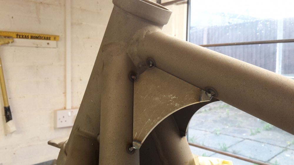

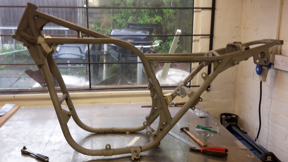

Whats your project Mark? I know that frame but I am damned if I can name it.
And your workshop is too posh, bring that bbq inside and go outside and weld the frame in the rain propper back street heroes stylee.

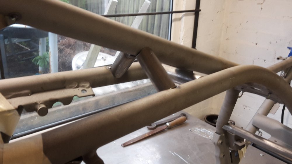

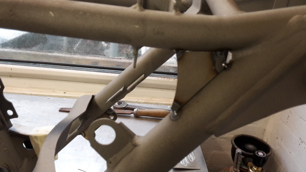

Z1000 or KZ1000 I expect Mark, I am interested to know how you decided where to re-enforce and what should be extra tube or plate, I have a ZX1100A2 frame that should be stiffened up a bit to match the new forks and swinging arm.
Thanks Octo I will have a good look at that later.

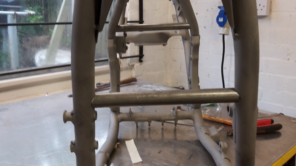

My frame is the later unitrac single shock frame, loads of room for a 180 rear and no problems with chain alignment so no need for stage three here.the guy who is building the bike positioned them, im only the welder, he has got all his information off forums he said, and yes z1000 the bike is, he said there known for frame flex so that's why they fit the kit, stage 2 will be new shock mount locations then stage threeis cutting dome of the tube for chain clearance.
, and yeah, every kit needed tweaking to get a nice fit, always posed the question, are the kits a bit out or is the frame a bit out lol.
