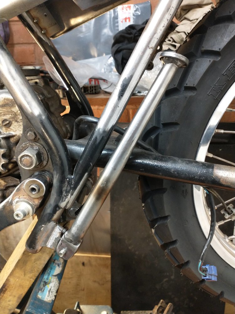

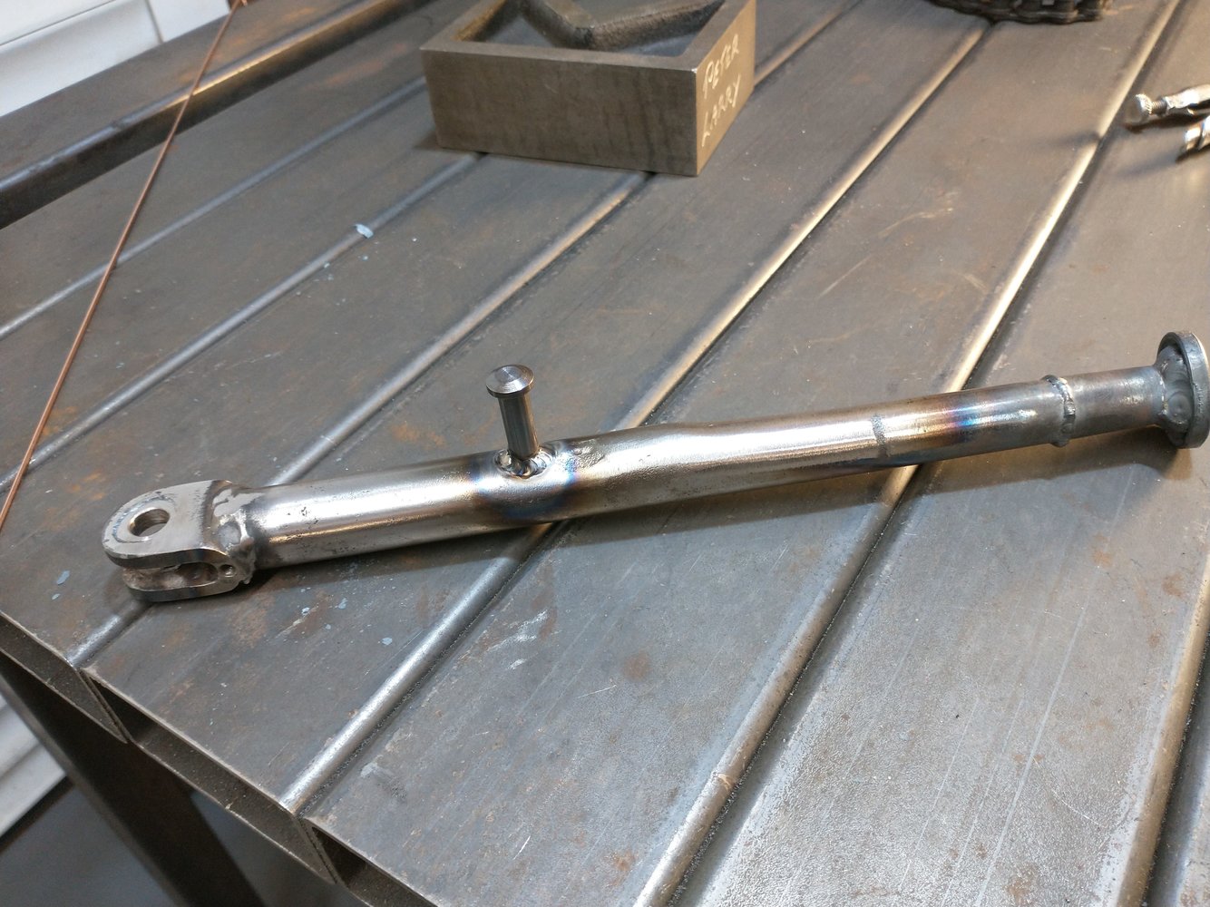

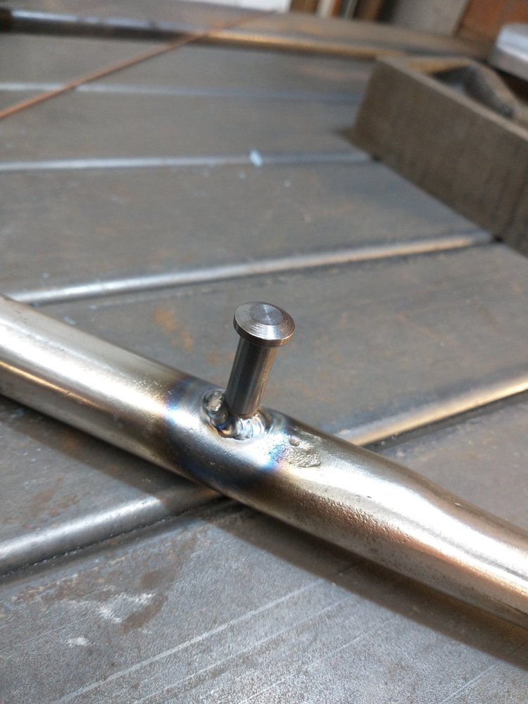

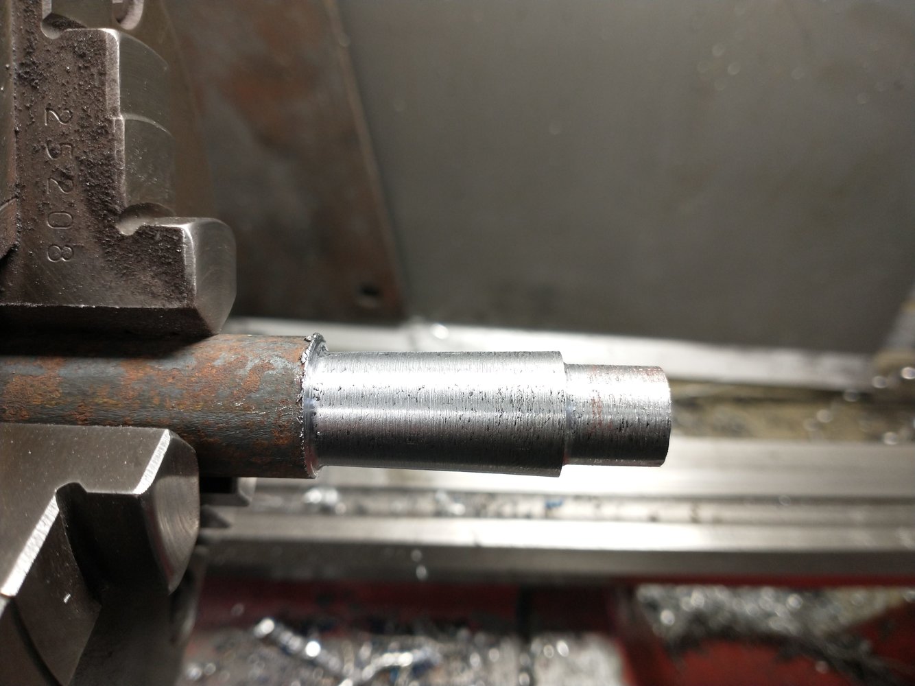

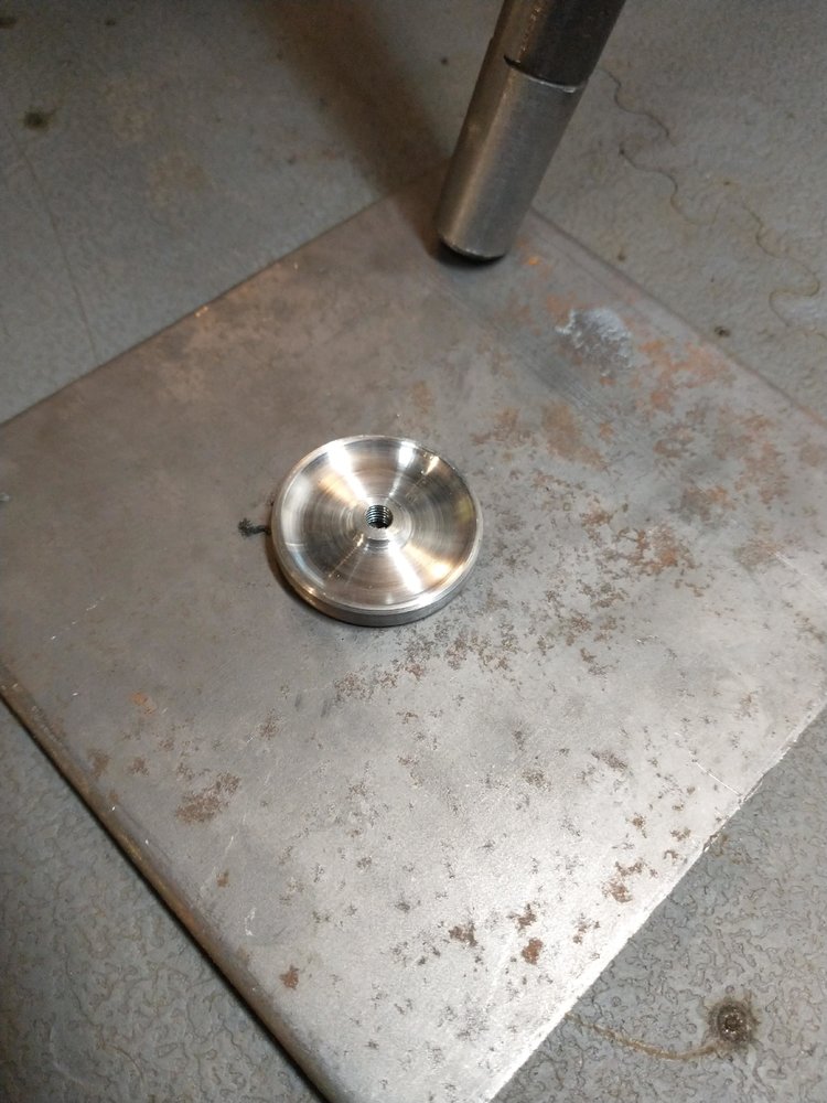

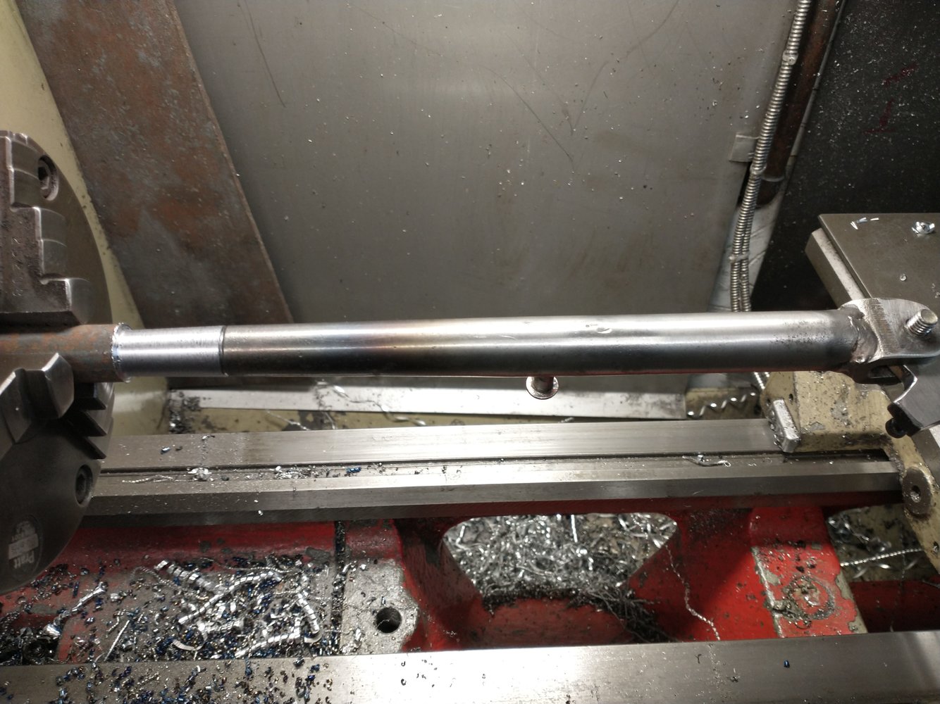

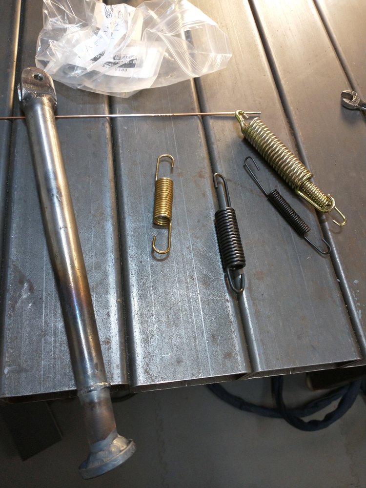

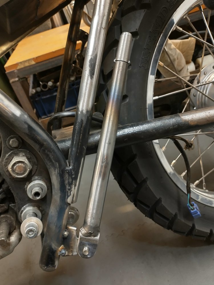

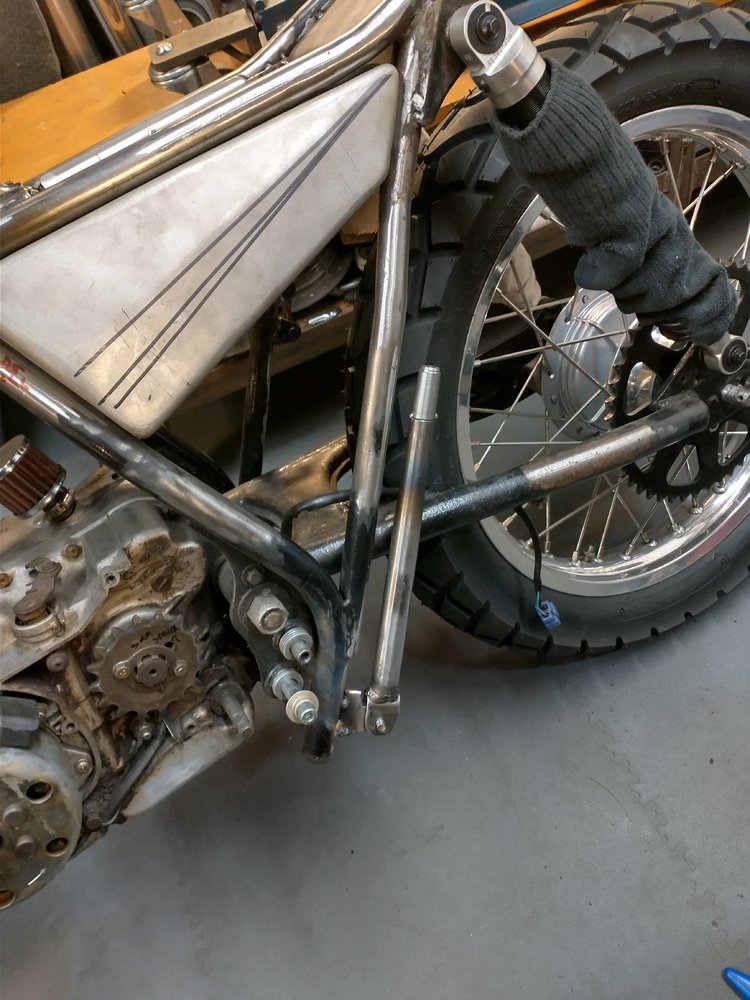

Nice work. The only motorcycle I've had that came with a side stand mounted that far back was a CX500, and it was pretty unstable while on the stand. I had a big screen on it, which didn't help, until one day it simply blew over in a light breeze and broke the screen. I doubt your SR is anywhere near as top heavy as the CX was but it's worth checking out.trying to get the taper looking right and get it where I wanted it to sit took a bit of head scratching. The pivots were all worn out so had to be welded and machined back.
