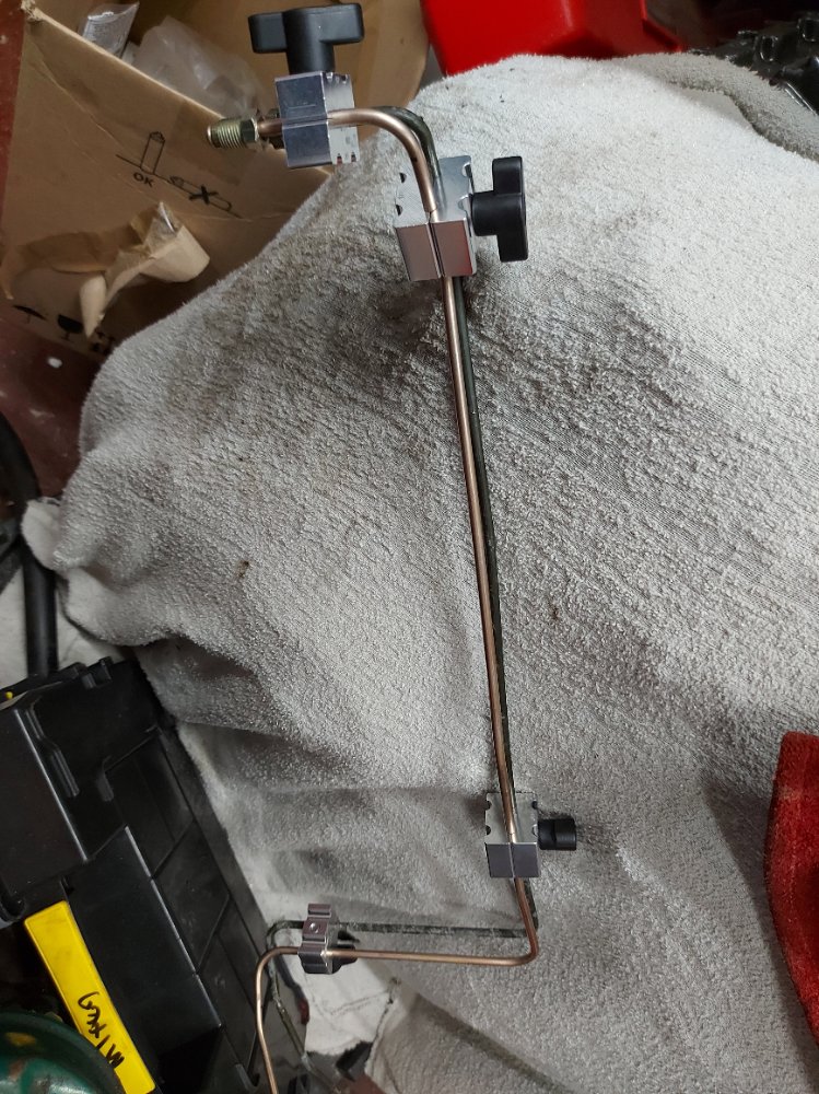

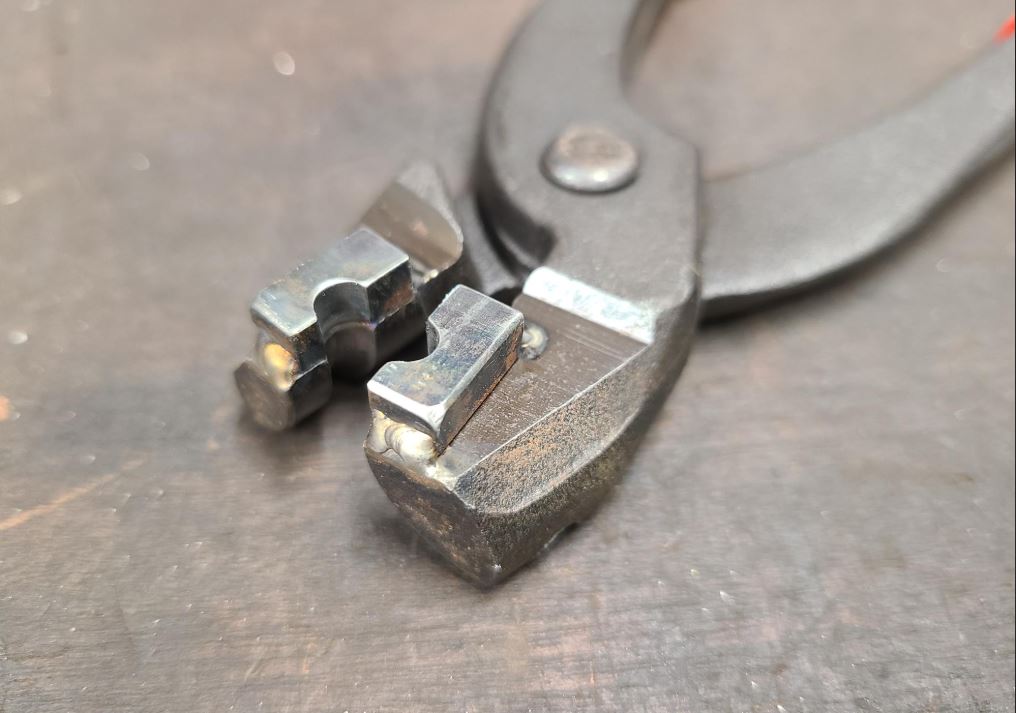

They're certainly handy but they frustrated me endlessly because they'll mark the pipe on the back side because the pipe has no radial support where it comes in tangent to the radius and it needs that support to react the bending forces. I tried a blend radius to take the sharp edge off but it still marked the pipe wall.

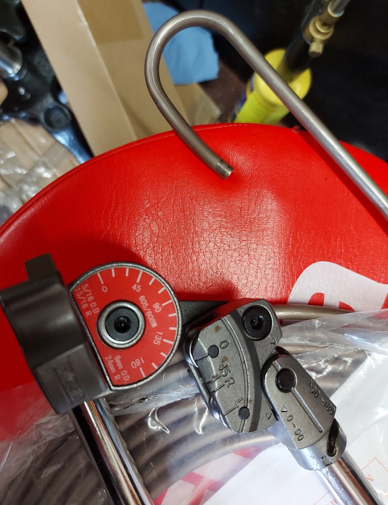

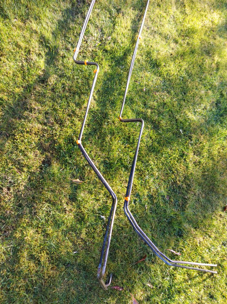

Many will see the pipe straightener as an extravagence but it's £40 well spent if you want your pipe to look nice. I've had mine a long and it still makes me smile when I use it. I've looked at those copy clamps before and it does look like they make copying pipes much easier.When I restore my MBs, I replace all fuel and brake pipes with Kunifer - some useful tools -
View attachment 487897View attachment 487898View attachment 487899View attachment 487900View attachment 487901View attachment 487902

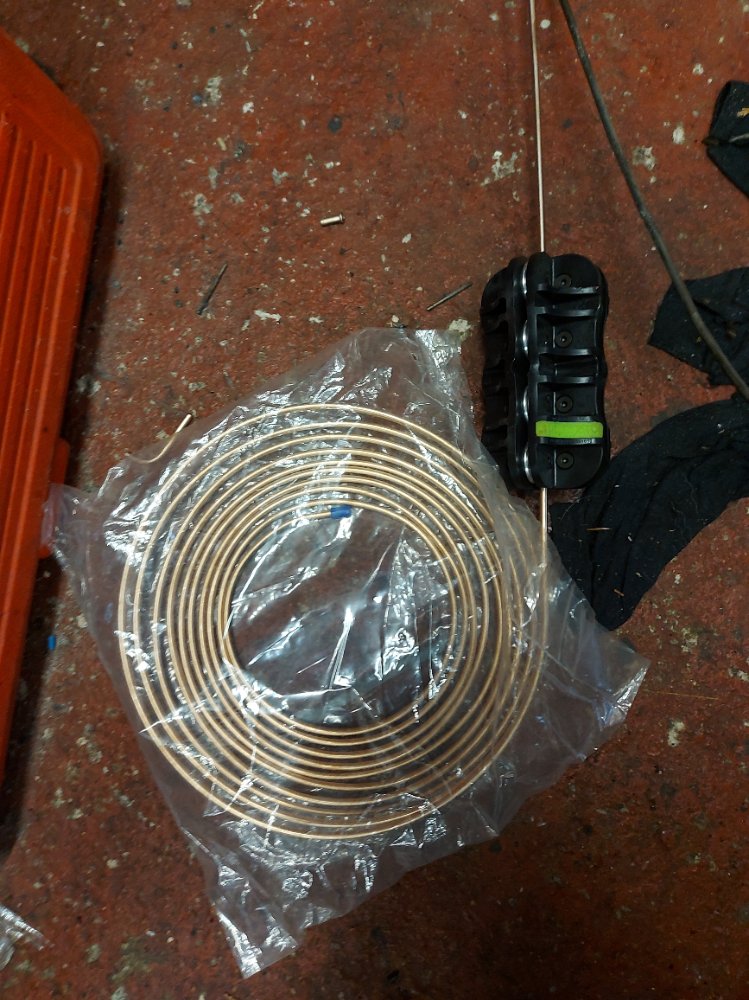

Fair play that is outstanding work. My view when working to that level is a roll of pipe is £20 so if I have to make a second pipe to make it perfect then it's no great loss. I just know it will always bug me so I'll just do it again.If you want to make a really nice looking job of it, as per Joepro's above, the pipe straightener really is essential.

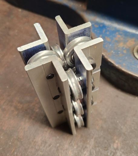

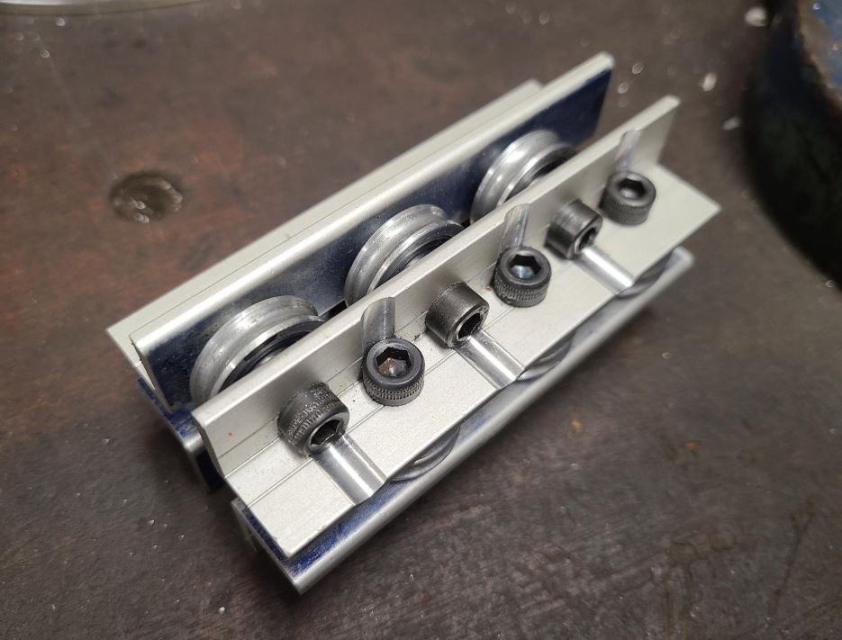

I made one myself from some ally angle, a dozen bearings and some turned sleeves for the bearings. My advice to anyone else would be just buy oneThey weren't £20 when I made mine, more like £50. I tried it with just the bearings to start with and it put facets on the OD of the pipe, but I'd sunk enough time at that point that it was worth making the semicircular sleeves for the bearings. It really does improve the finish of the job no end though.

Have you not got a pyrotenax straightener? That's what I use on brake pipesGosh, the last time I did some break pipes on my van, (about 6 months ago)

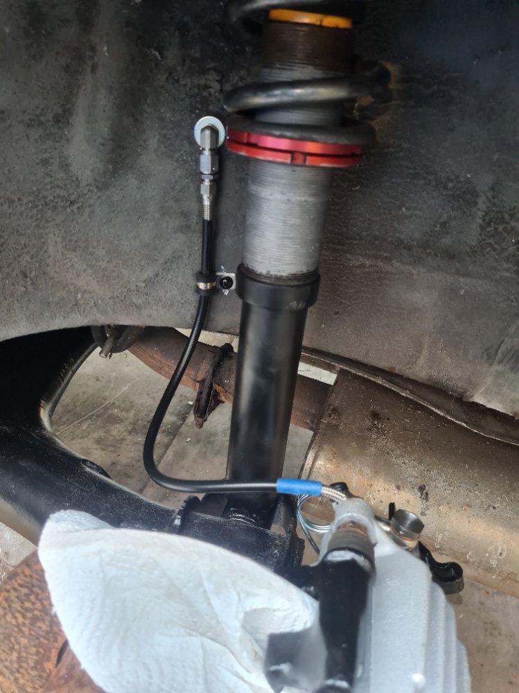

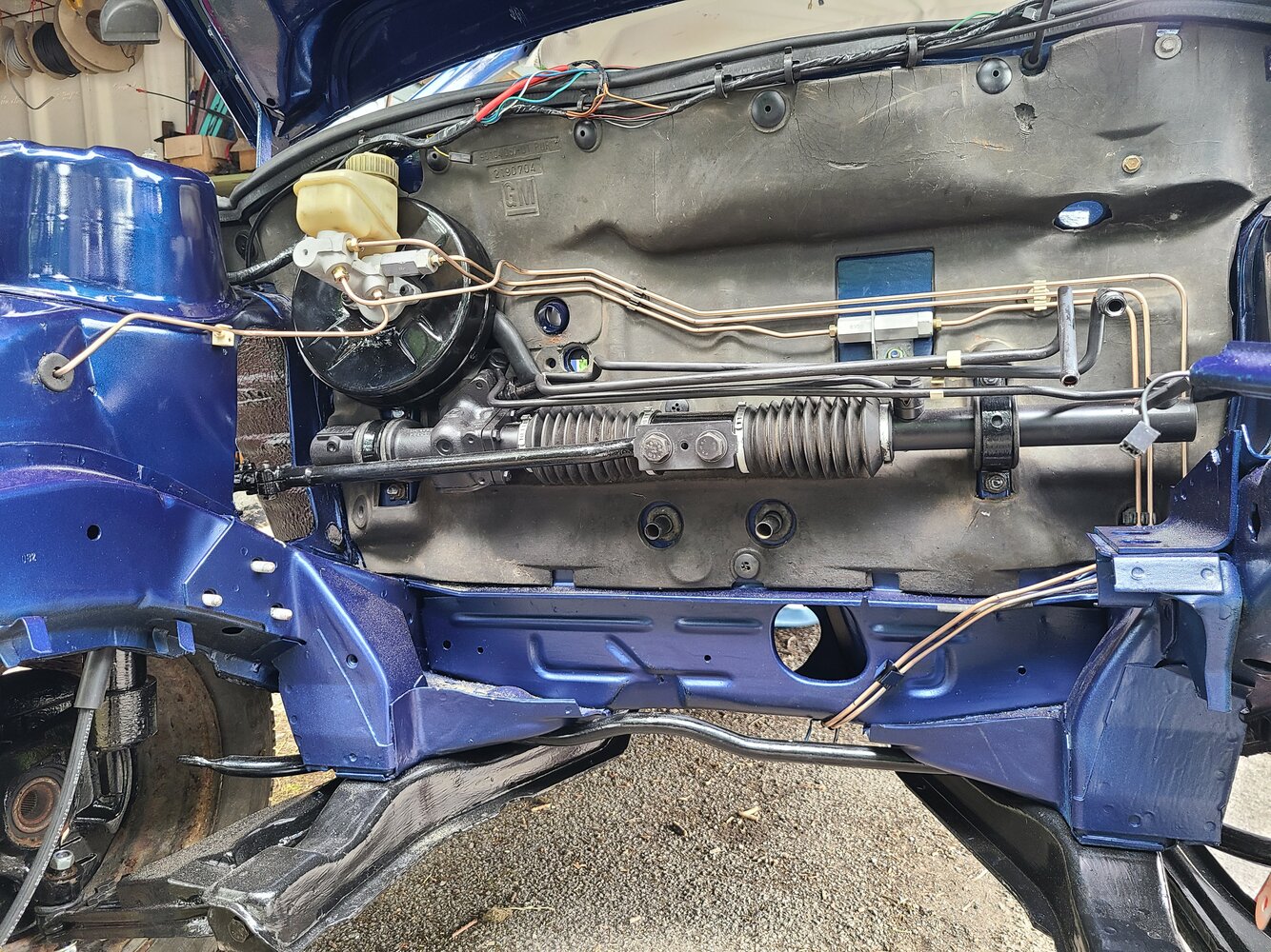

This is my setup after running inboard brake lines, never had an issue with MOT.
