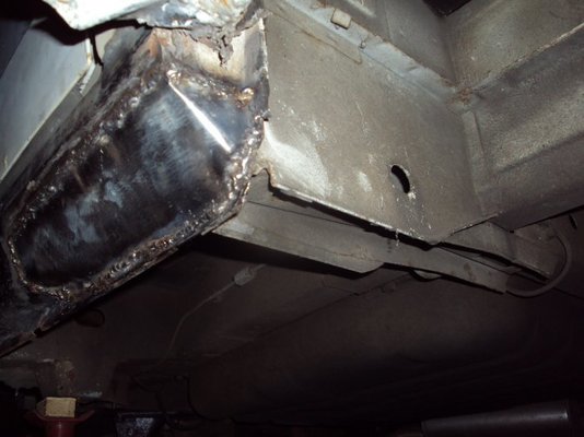

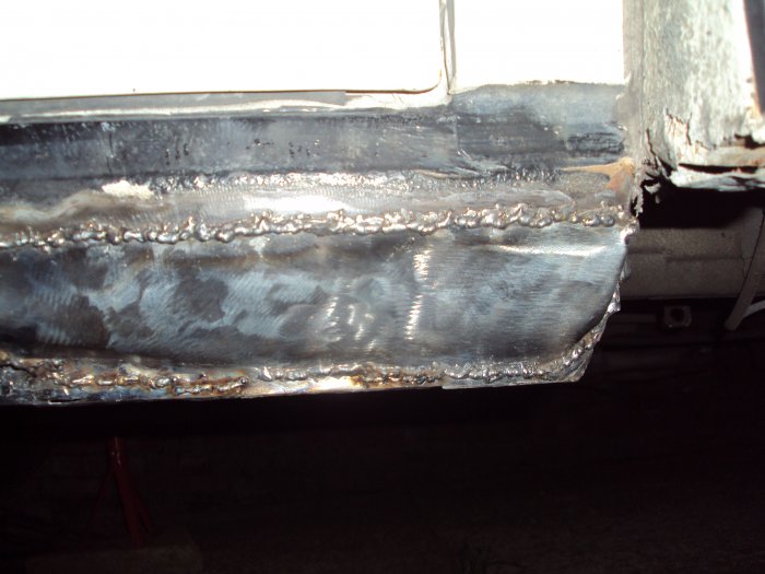

My motorhome failed its MOT on a small area of the outside sill on the bottom of the pasengers door frame. I can upload pictures if it would help.
The area is about 25 cm from the Seat belt anchor point inside. It is a slit where the technician has stabbed it with a screwdriver I guess about 1-2cm in height and 10cm in length.
The sill is closed and you cannot access the inside of the sill from under the vehicle.
I have welded some patches on another vehicle and am happy to have a go at welding a plate over the area. The problem with that is that I cannot get to the inside as already said and I saw something that said you need to weld on both sides for an MOT.
Anyone have any thoughts?
Thanks for reading
Ian

If you welded inside the sill how could they check it without cutting it open to see? Just seam weld it to an acceptable standard and it will be fine.
