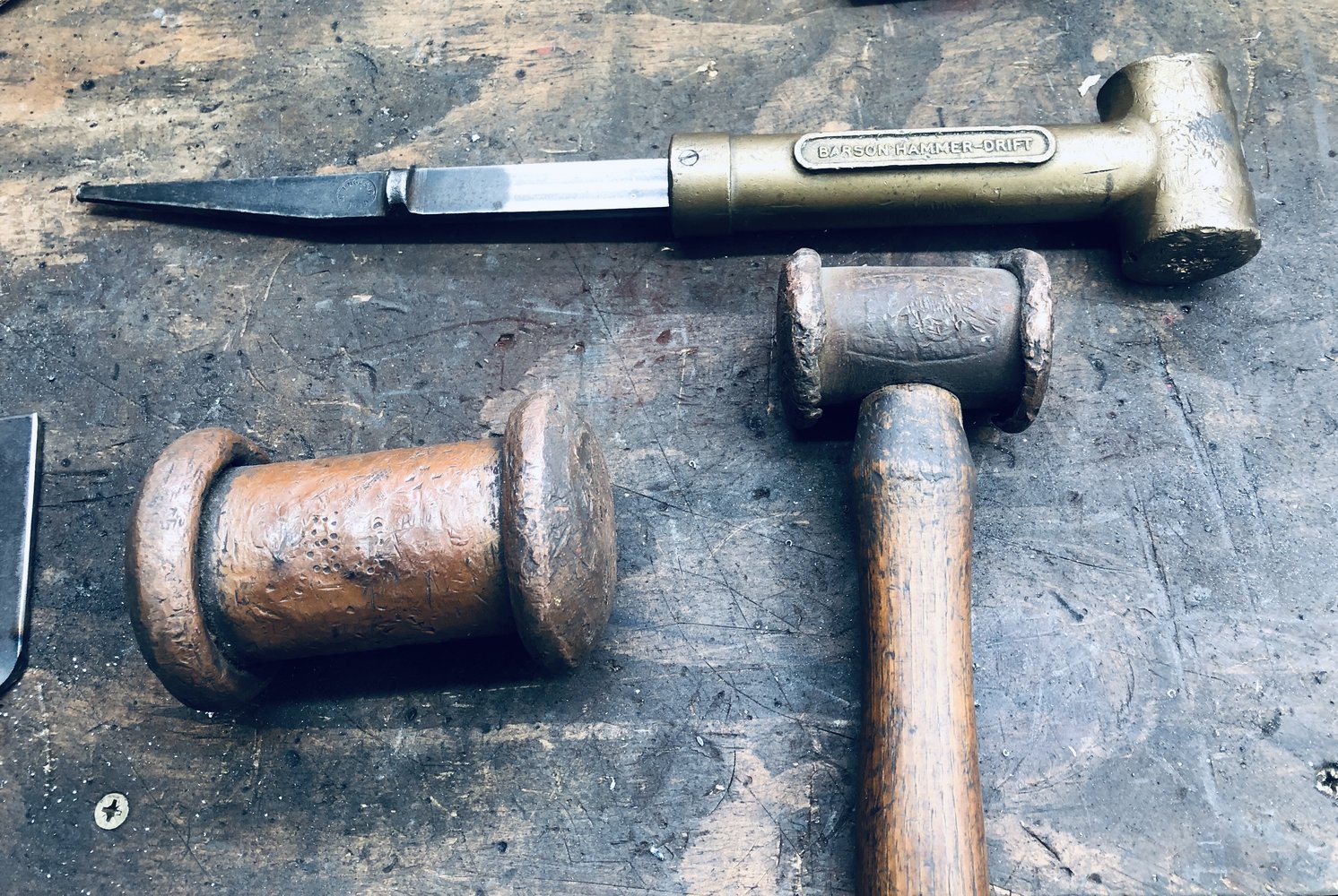

Now I’m even more keen to see / buy / make one.Not quite that simple, the "roll pin" is actually a grub screw and there is a spring inside the cast brass part which should keep the drift sticking out. You put it in the drill's slot and shove hard against the brass part, so it acts as a slide hammer.
Yanking on it sideways to turn the spindle (the hammer body gives a lot of leverage) - obviously just bends the drift end.How the hell do you abuse a drift to separate tapers?!,!

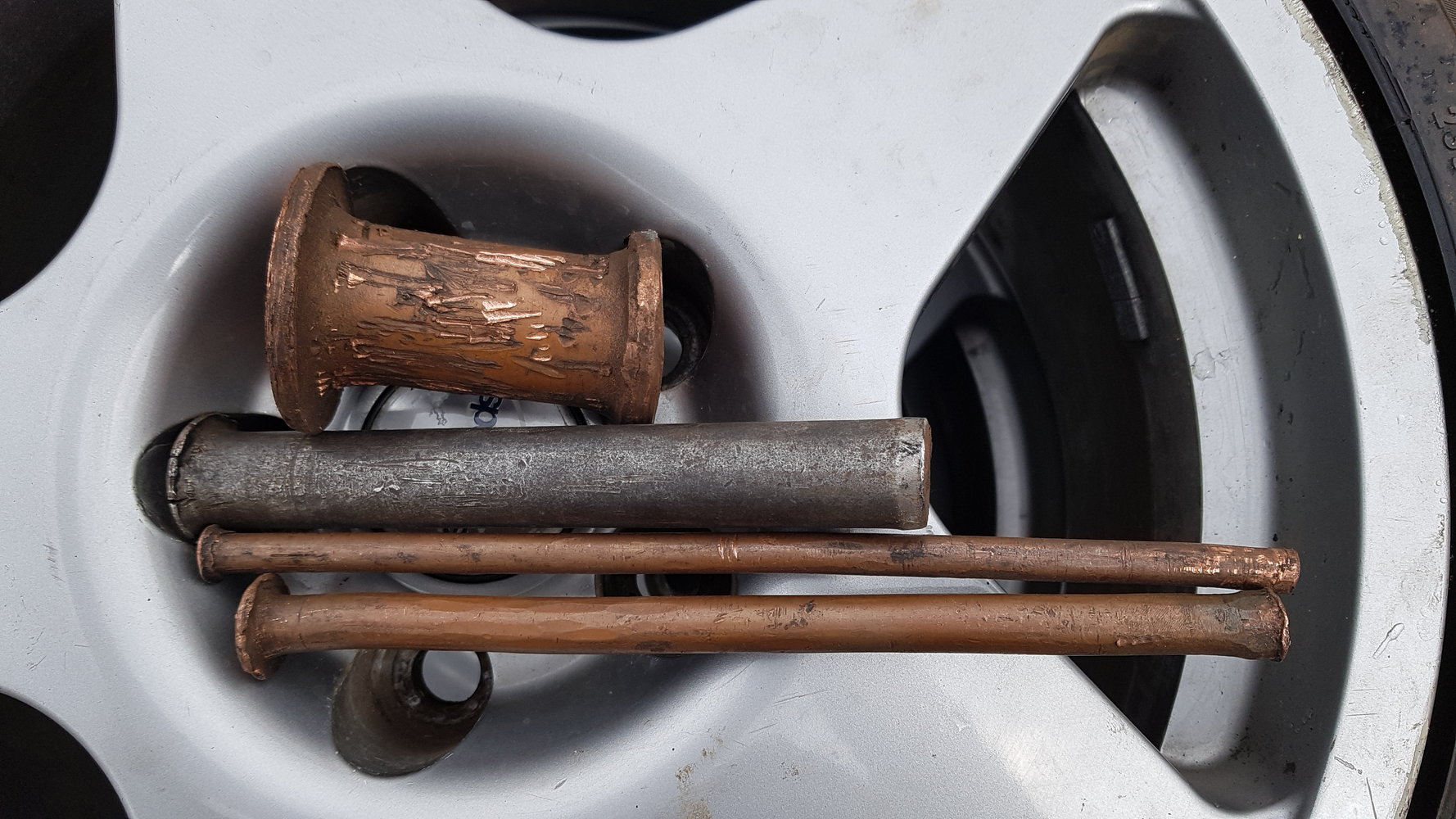

I have a copper drift like that,Holy thread resurrection Batman. I went and snapped this pic before I realised actually.
I've had all of these over 40 years, and I still use them occasionally.
