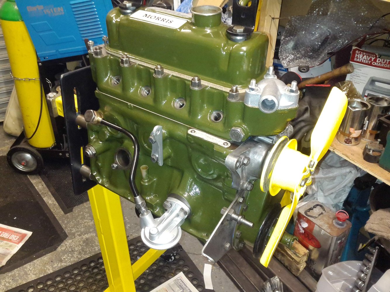

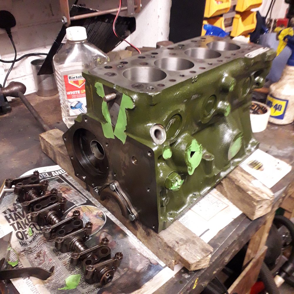

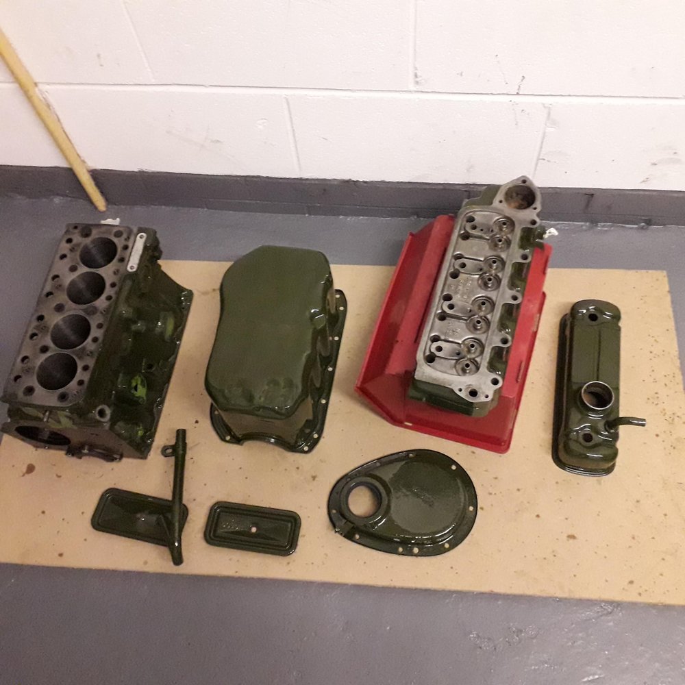

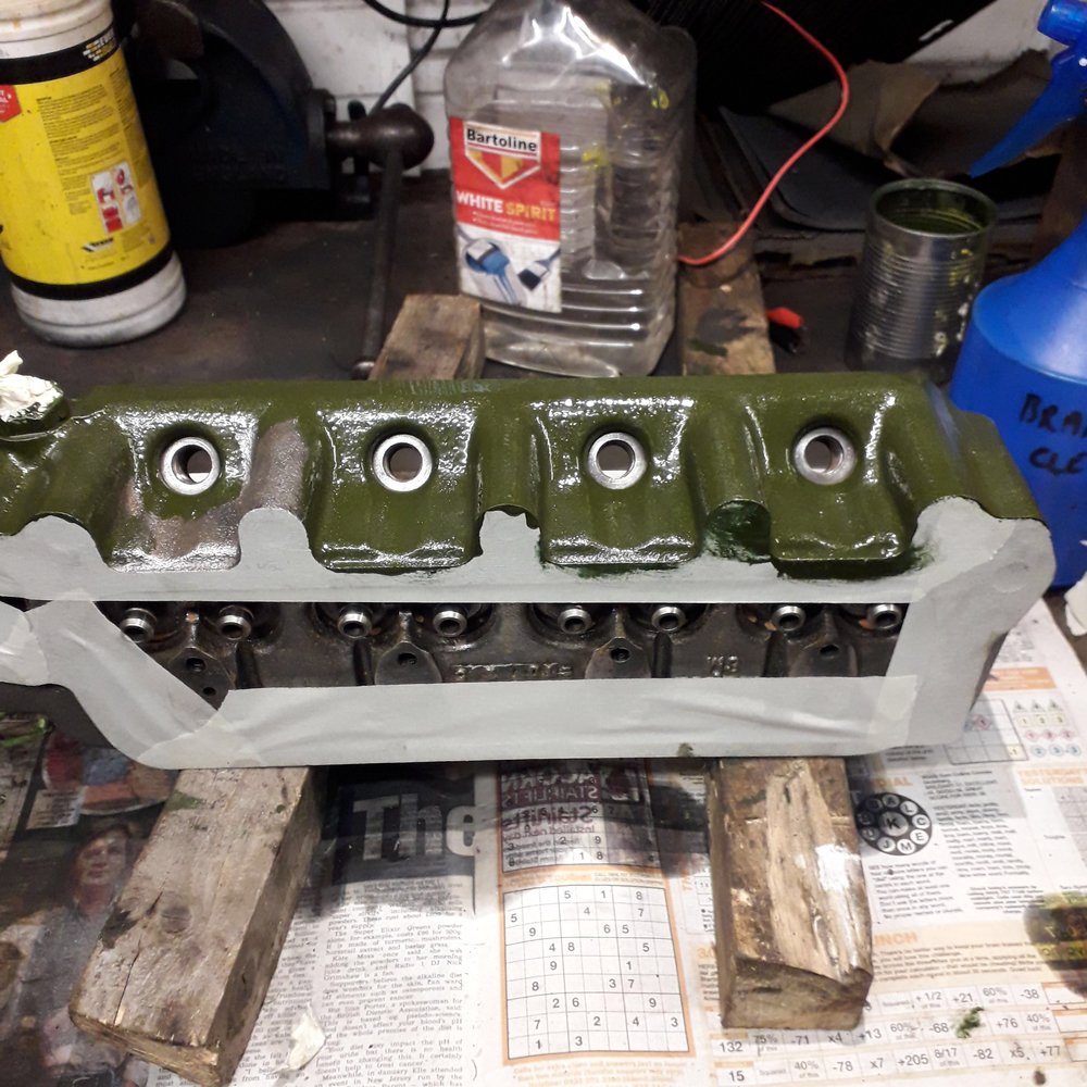

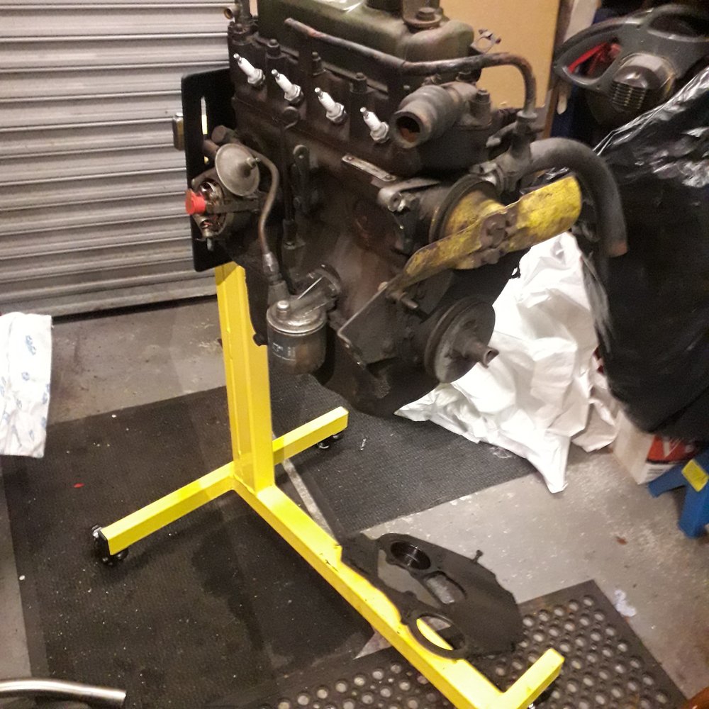

While the body is away getting soda blasted I got on with the engine rebuild. This is what it looked like on removal.
took it completely apart, cleaned, painted fitted new rings, new main and big end bearings, new timing chain, new valve guides, valve seats and valves refaced and skimmed the head.
Stuck most of it back together today.
forgot to take pictures of the crankshaft and pistons going back in. Hope there aren’t too many oil leaks.
